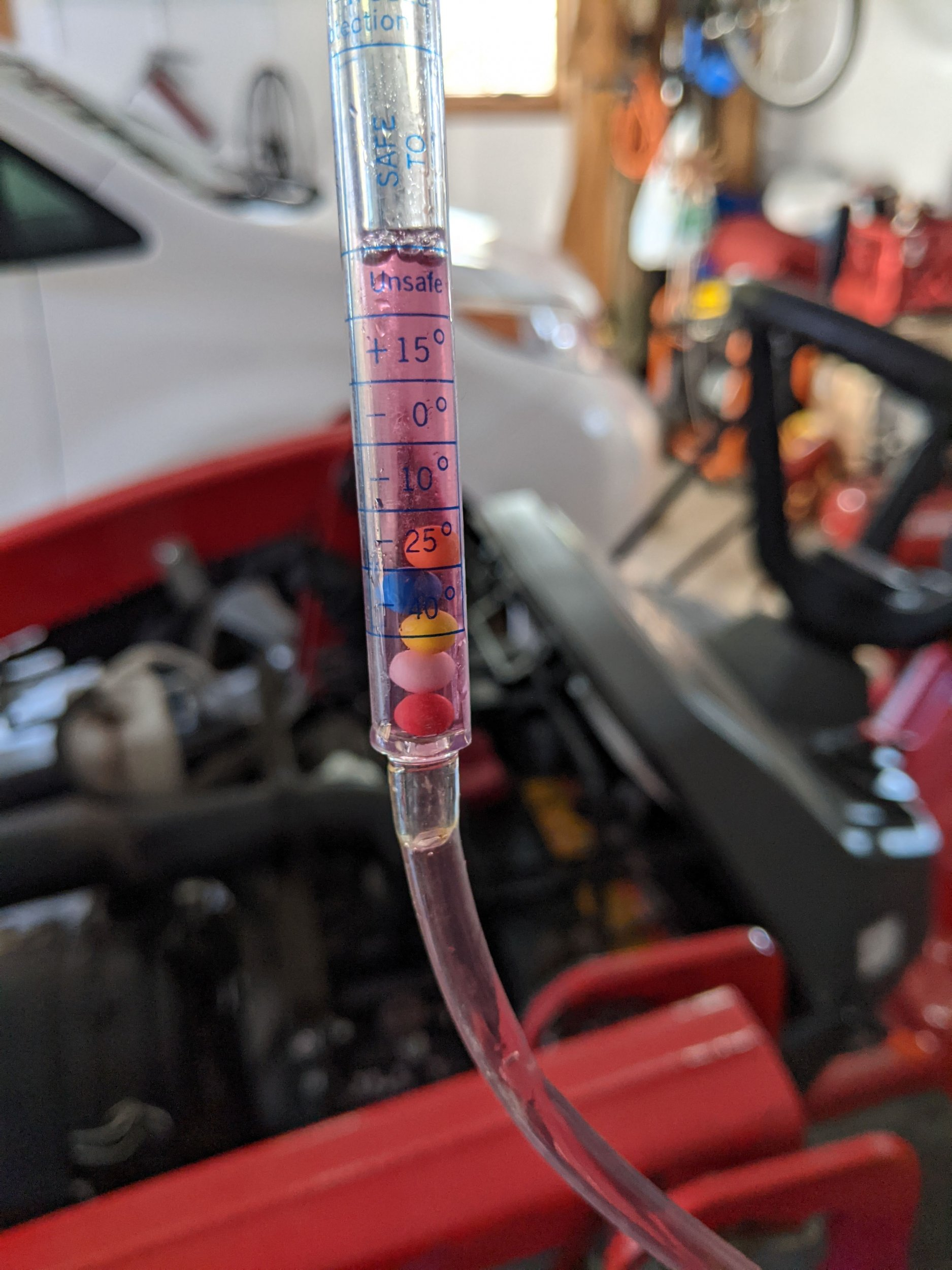

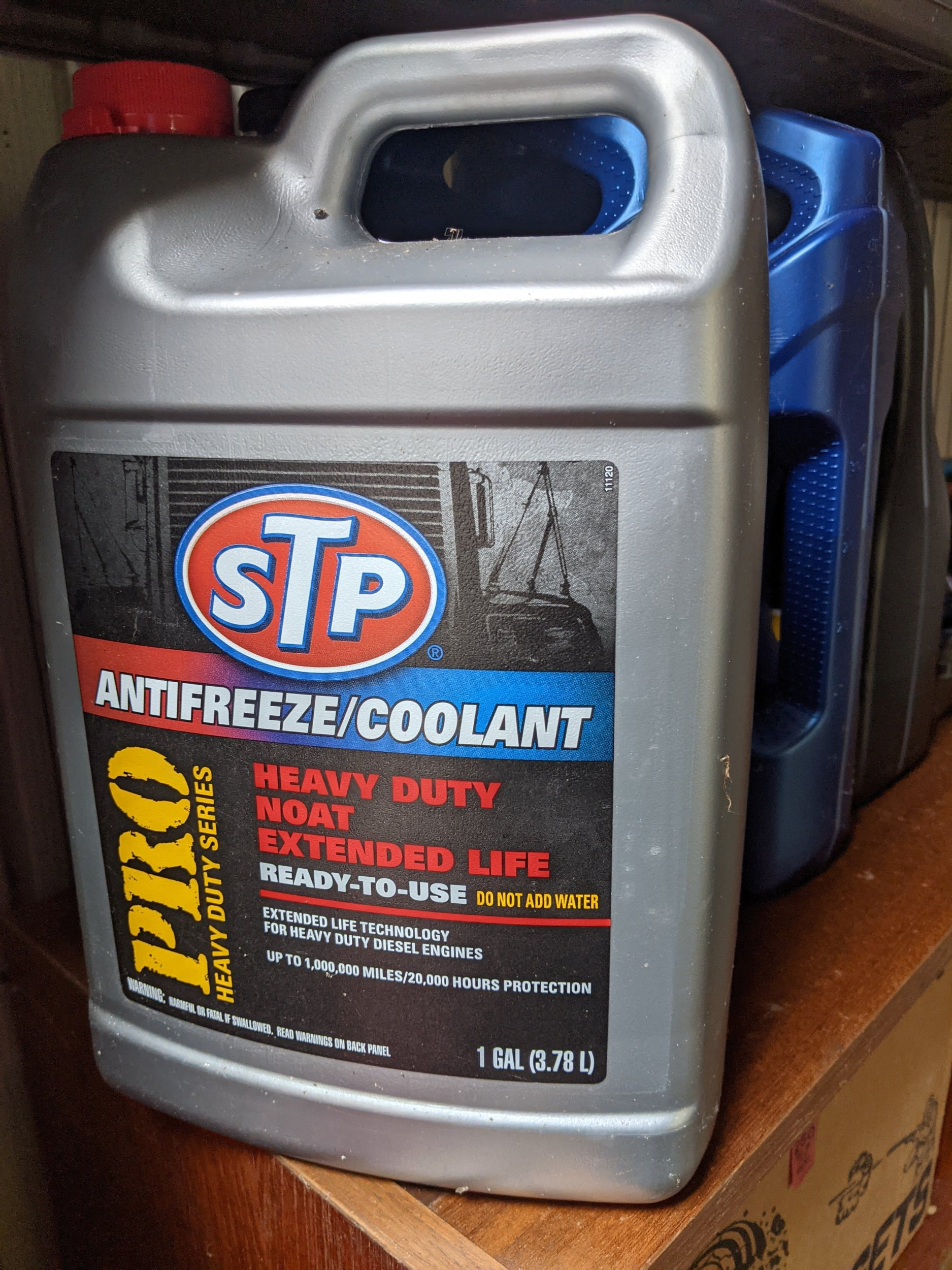

So, found something interesting today. I changed coolant last year on my GC1710, used this stuff:
I had no intention of changing coolant this year, not as though the tractor is a daily driver or anything. Anyways, today I stumbled on my el cheapo coolant tester, so since it's in my hand, why not. Tested the coolant and found this:
I thought maybe there's a problem with the tester, so tested some of this same coolant leftover in the container, and got 3 balls floating from that (safe to -10 deg). So yeh, this is surprising, and looks like I'm changing coolant this year after all.

Aside from the jug that you showed compared to the fluid is the wrong color, what are you trying to prove/say?
Myself, I am going with whatever you are testing is not the STP Heavy Duty.

I only trust a refractometer anymore,not those hydrometers.
For the Kubota's I mix green coolant 50/50 with distilled water.

Why are you only getting -10 out of 50-50 stuff out of the jug?
   / Changing coolant yearly or lack thereof. #8
I have found that the new coolant types don't have the same specific gravity of the old antifreezes and therefore doesn't work well with the older testers. Try it with a new tester designed for the newer coolants.
OMG, you figured it out, my post is a big lie! :rolleyes:
These are good points, fellas. Maybe it is the tester too, will pick up a new one at TSC today. In any case, looks like a year in the radiator degraded the coolant, which is strange.
