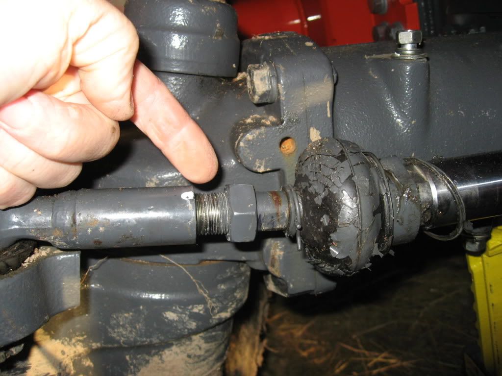

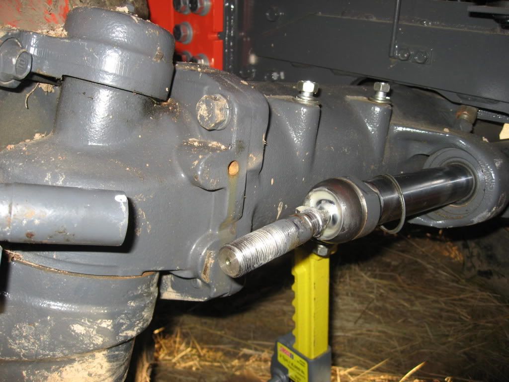

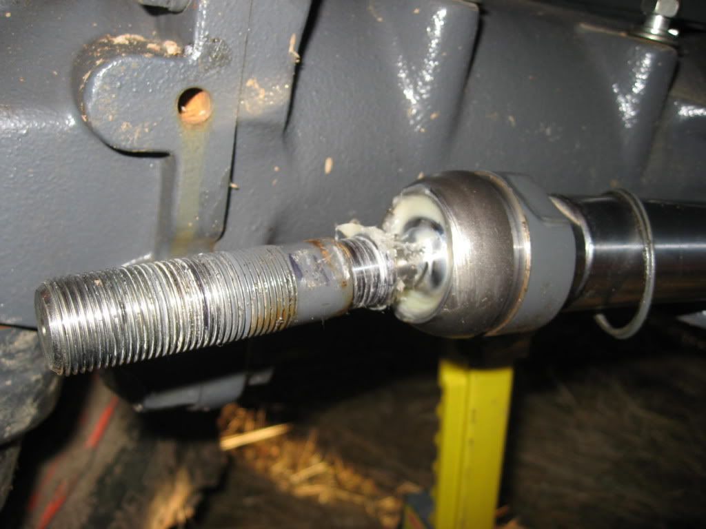

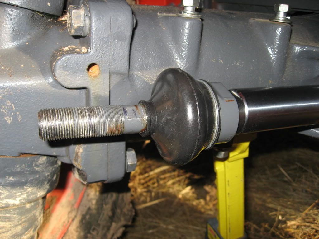

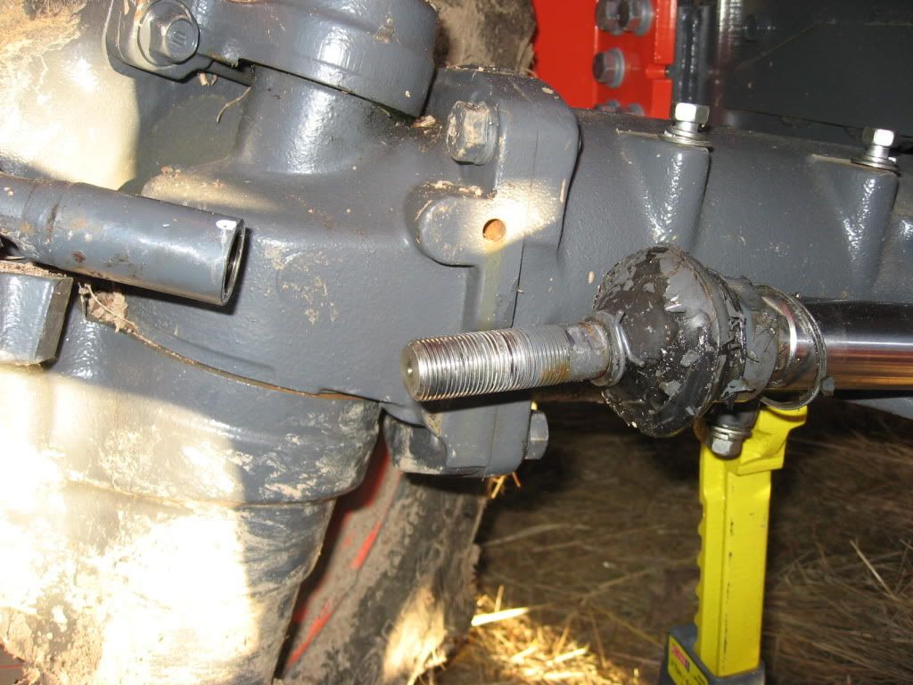

I finished the repair this weekend. Posting a few photos. I used the loader to raise the front and put a jack stand under the axle on the repair side only. No need to take off the tie rod completely. Just loosen the jam nut and the threaded end unscrews from the fitting. After that, taking the old boot off and putting on a new one is pretty easy. The retaining ring on the engine side is a bit of a pain. Use some of the lube from the joint and it will eventually slip on. I used a permanent marker to mark the threads before unscrewing. Just getting it within a thread of proper alinement. With R1 tires and a low speed vehicle off road, you won't know the difference.
Cheers,
HP
