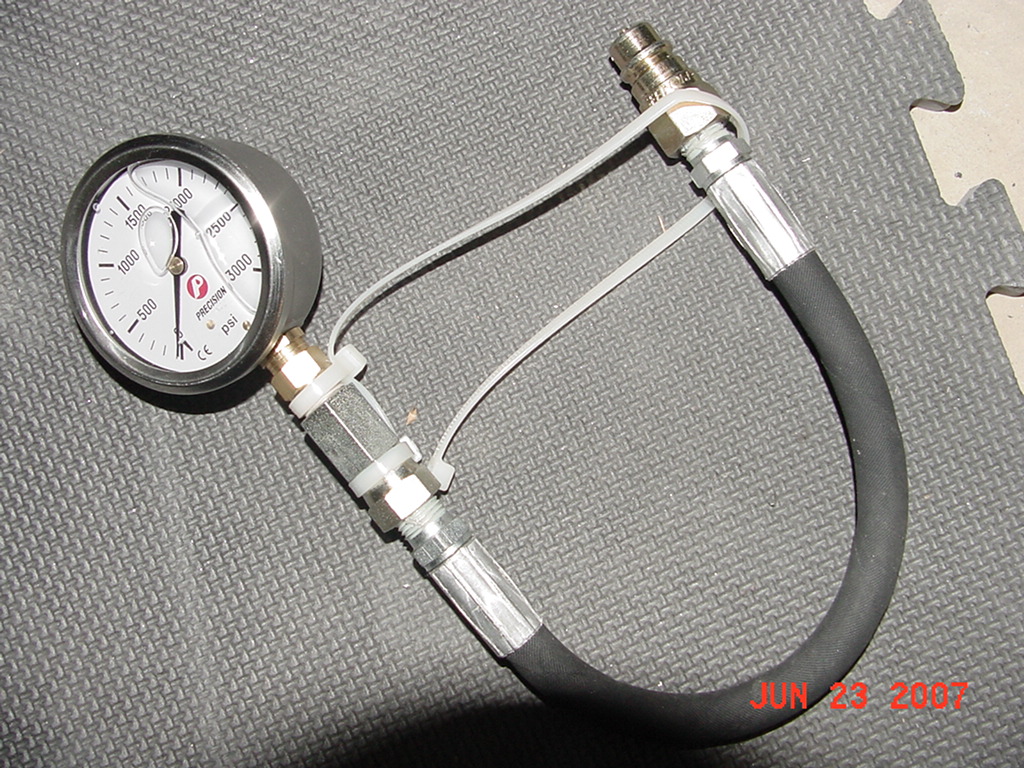

All you need is to connect a hyd gage to a female QD and you are ready to go. Nest, install a tee and a male QD in the pump circuit. To read total/relief pressure, it has to be before any valve.
To test relief pressure, hook up the gage, and extend or retract the cylinders fully, and you will see the relief pressure. I would recommend installing the tee with male fitting at the input to the FEL valve, where you can see it.
You could add a hose to the test setup for checking the pressure at other points on the tractor.

Check out Brennan Industries Test Point Fittings for test hose and couplings.....GOOD STUFF...
Connect this to the gauge...
Use this hose
And use this on the T
This is the T, I am showing JIC here , you might have other threads.....just look them up on Tube Fittings and Adapters...
Any larger supplier should be able to order these parts....
