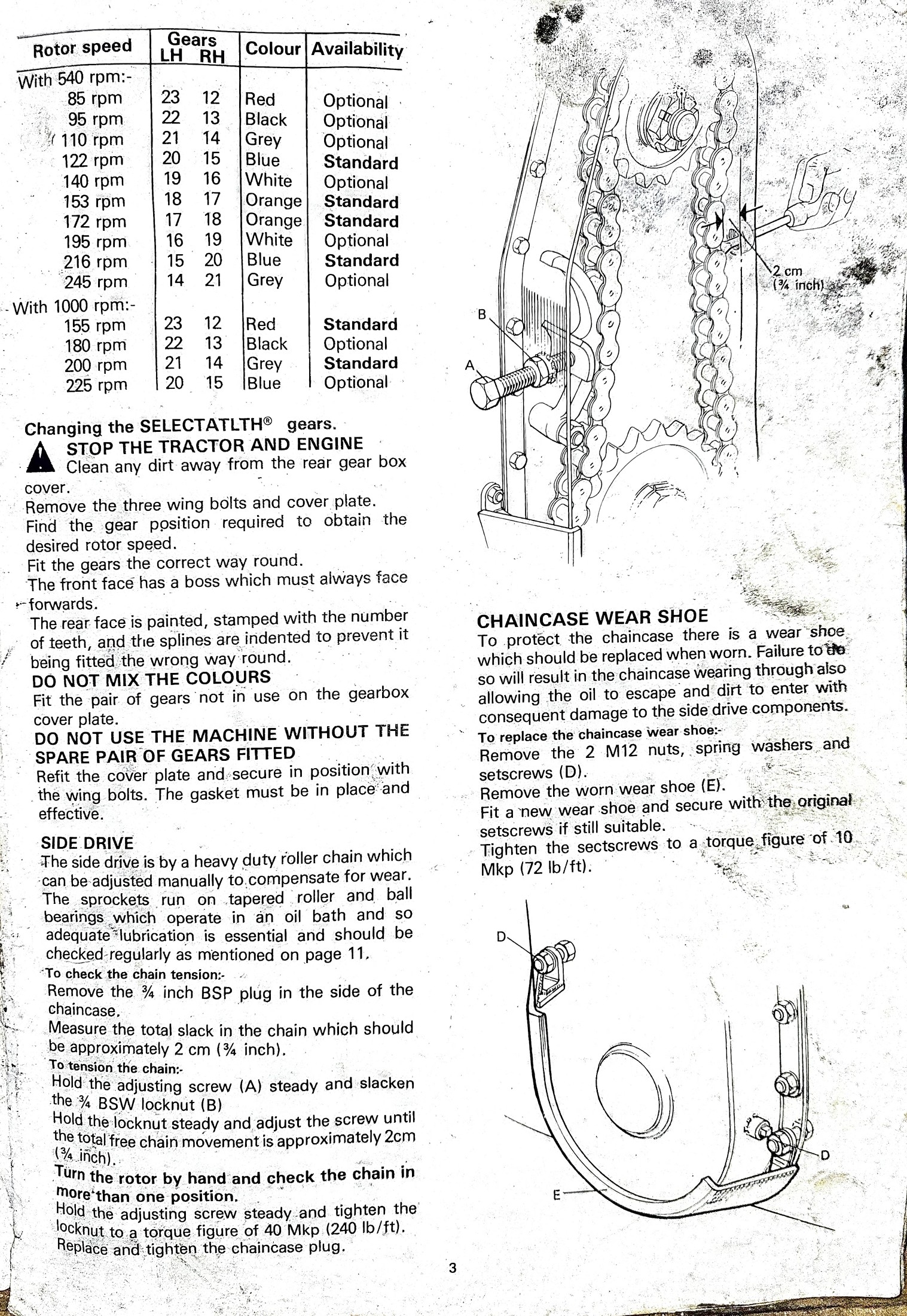

Welcome to TBN.
The following are from an HE model, but would apply. I don't think I have an HA manual, but I will keep looking for you.
Also, whatever method you can drain the oil if the plug is stripped

Thanks Tractor Tech for the info. This is awesome!
