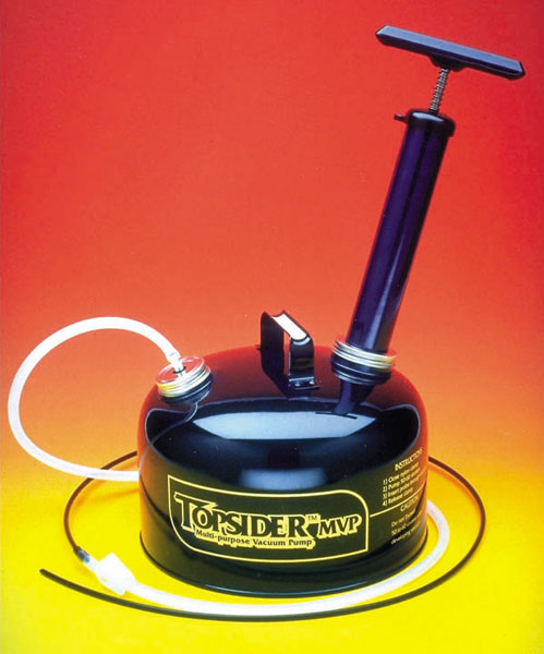

I have used a topsider oil change pump to change the oil on my dad's sailboat (24 HP Yanmar diesel /forums/images/graemlins/cool.gif). It worked very well. Maybe you could get the level down enough so that a catch pan would hold the rest.
