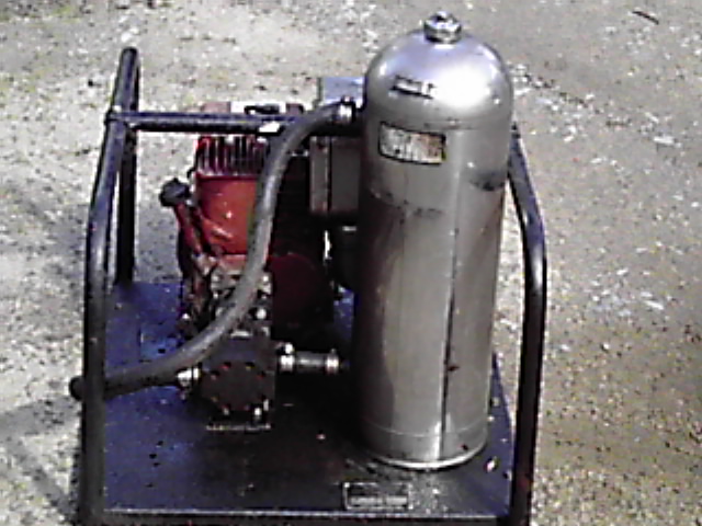

I have mine so I can use eather way . Have a HYD power pack (Engine, Pump, Tank, Filter with same quick disconnects as tractor). Just put Tires on spliter (can remove with clip pins) also can run other things from power pack . Will send picture later.
