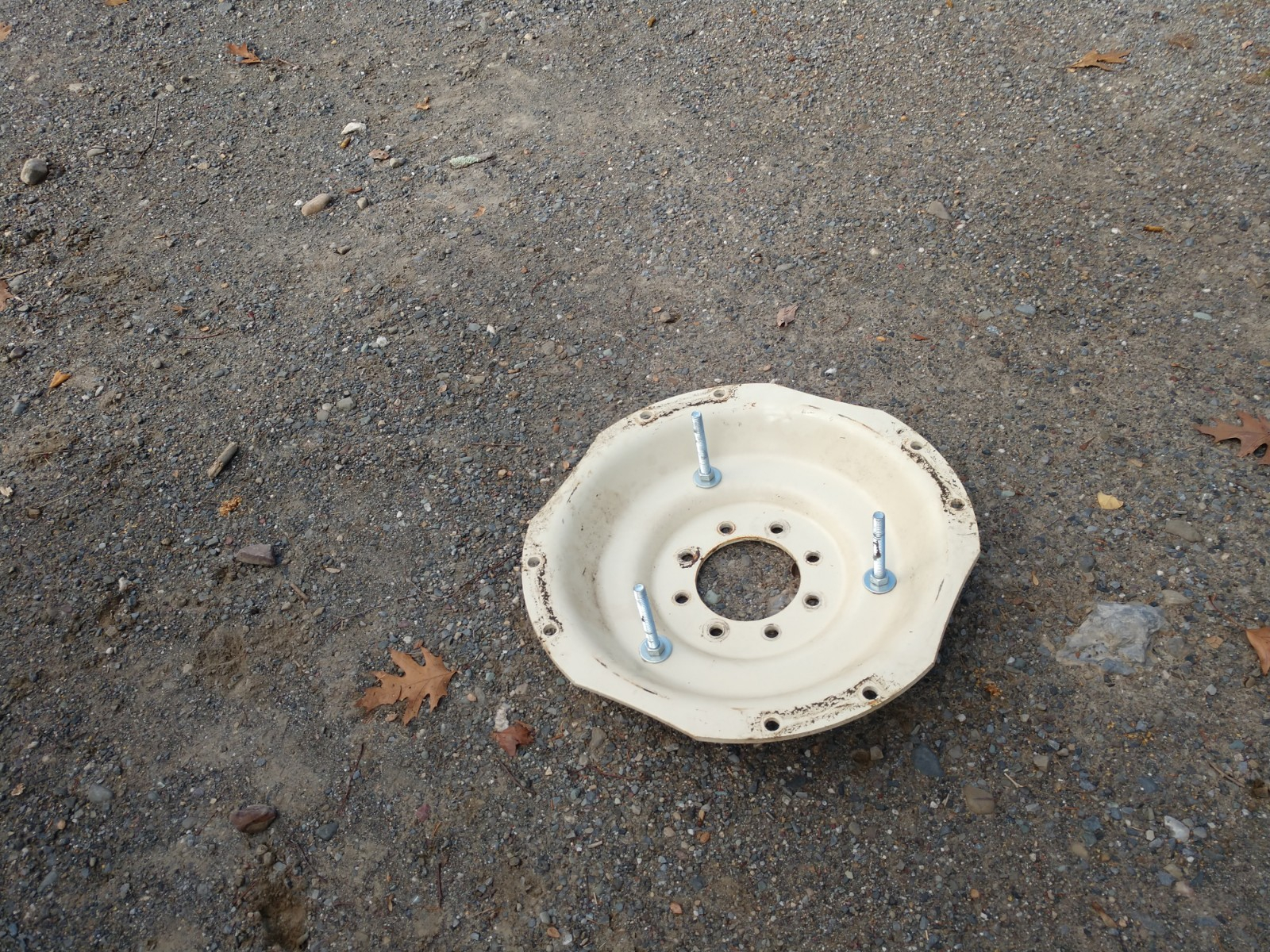

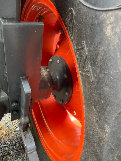

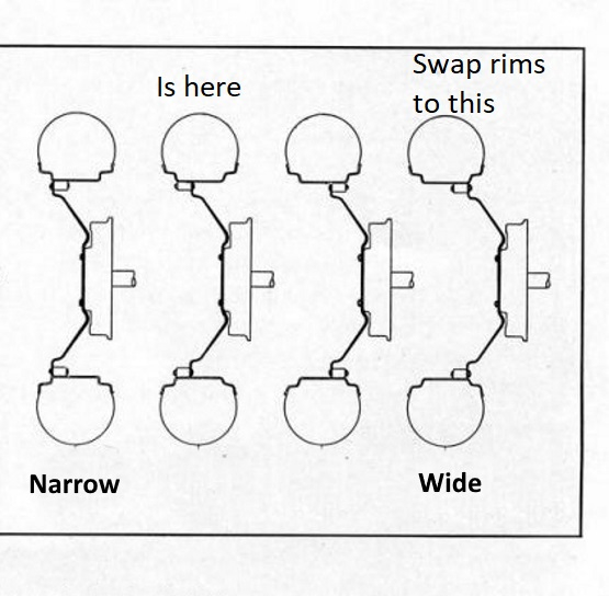

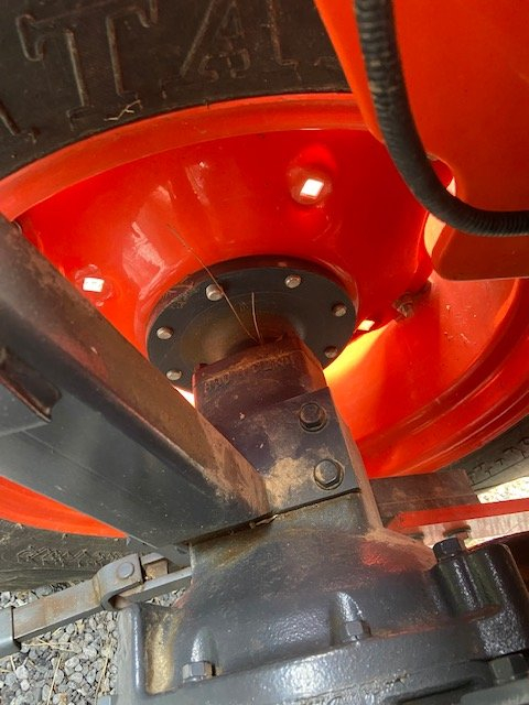

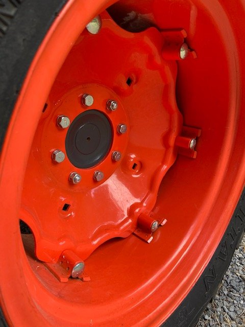

From the photos, it appears his single set of mounts on the rim are centered on the rim. As such he has the max width the mfg provided. Your diagram shows the single set to be mounted to the edge of rim. Not so in his photos.
His mounts are not at the edge like the diagram, but they are off center enough to get 4 different spacings.

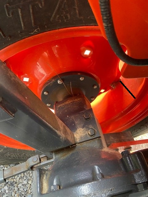

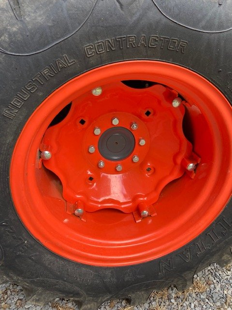

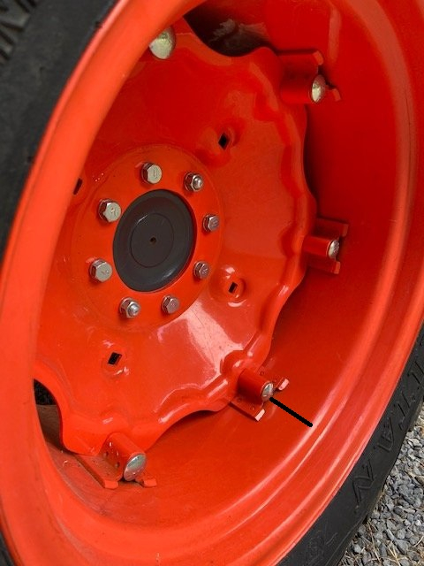

/ Changing Wheel Width #22
I added black lines to his pictures to show the offset of the mounts on the rim:

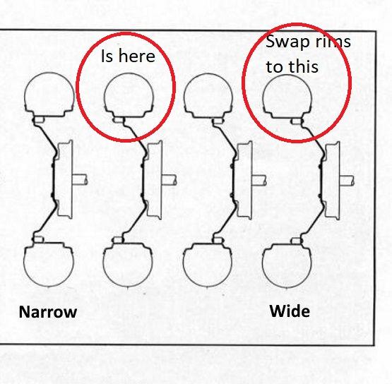

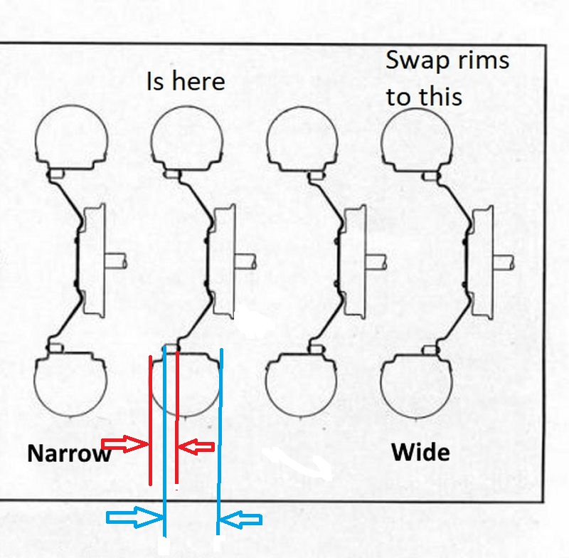

Go back and look at picture 1 & 2, you are not seeing larger width from bolt lug to rear of rim in picture #2...View attachment 703558
Some ruler work required
What is red dimension?
What is blue dimension?
I have no trouble interpreting what is presented in your drawings.
It is just that you need to look at the photos of his wheels he provided after I requested them. They do not match your drawing! Thus your drawing and insistences are hindering his progress if he attempts what you continue to suggest!
His rims have 1 set of mounting holes. They appear to be located in the center of the rim inside to outside. His centers are mounted to the inside of his mounts! Again please refer to his situation and drop the insistence that every rim is setup as your reference drawing! Real life trumps manuals every day!

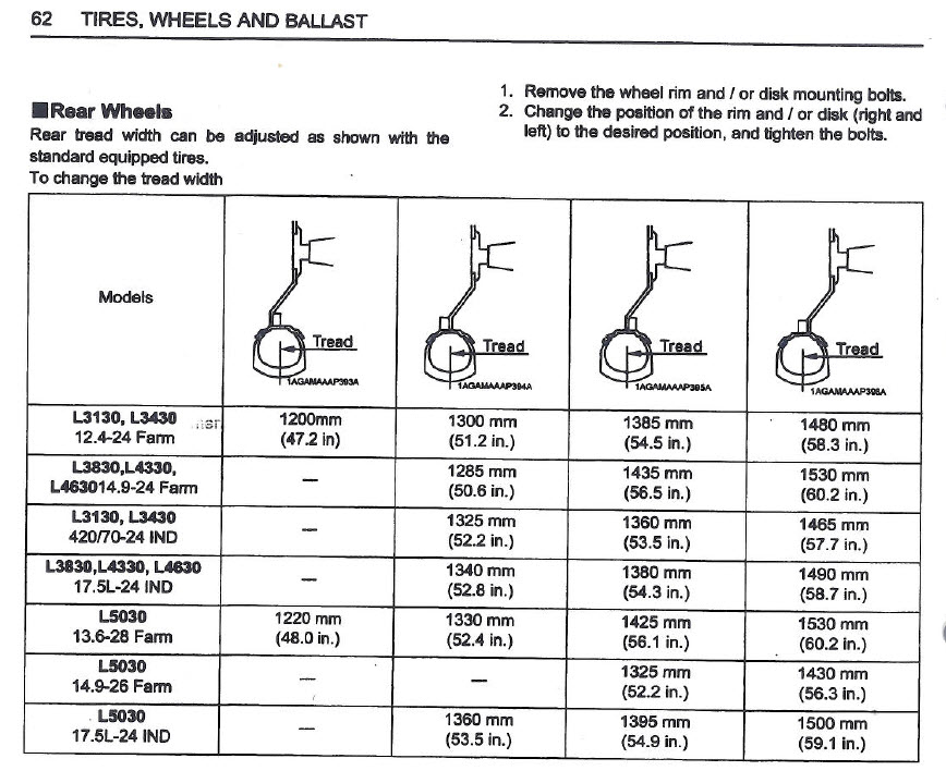

Perhaps you would care to read page 83...

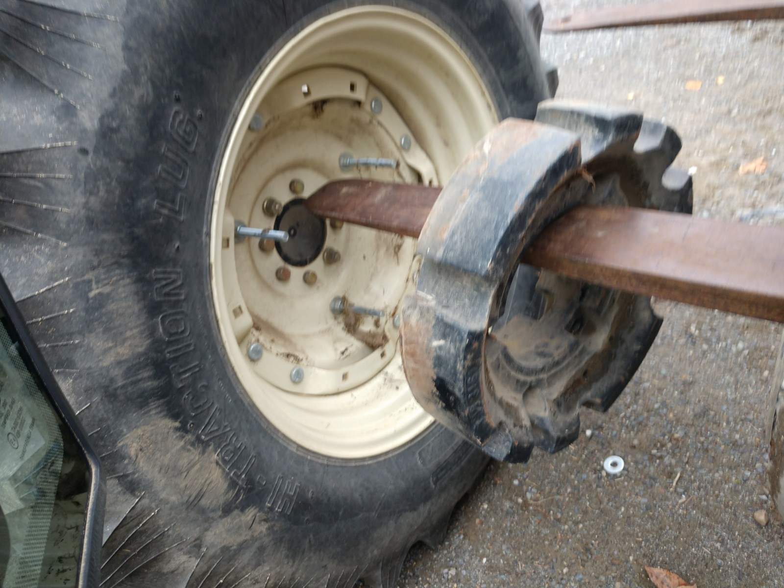

As far as the difficultly in moving the tires a reasonably strong man can easily walk the tire away from the tractor and then on a hard surface carefully roll it to the other side of the tractor and walk it in to the studs. You just have to be aware that you must keep the tire standing up right and balanced. If it gets away from you and starts to tip there is no way a man can stop it and you have to be aware and ready to step back and let it drop.
Also if the tractor being worked on just has wheel lug bolts instead of wheel studs and nuts,
it is much easier to line up the holes if you make a couple of studs as guides.
This does put the valve stems on the inside of the tires.
My tires are not liquid filled and I swapped them around awhile ago they are 18.4-30 tires.
pulling the weights off 300# each
Both tires off and rolled up and resting on the fronts
I had to pull my center sections off as the rims would not clear even rotating the centers.
After removing the entire wheel and rim I unbolted the centers and remounted the centers to the rimes and then walked them into place.
I did have the rear forks and second tractor avilible if needed to lift a tire that fell.
Didn't have to, I have also walked 20.8-42's around carefully as they can be a handfull.

Here is a drawing that matches his rims a little better. The mounts match his rims a little better:
