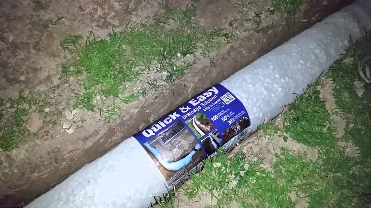

I installed a very shallow section of perforated corrigated pipe barely covered by rock hoping to drain and direct the water from my roof and a large patio towards my pond.
Nothing ever discharged from the pipe, so I assumed a clog. Ran the hose on full blast, snaked it all the way through, still no drainage out the end except when the hose came out the other end.
It's very surprising since our soil doesn't "perk" a small french drain could be very effective at just diffusing the water back into the soil.
   / Channel Drain or French Drain ??
#12
I might try the french drain using the NDS EZFLow system first. It doesn't require any gravel and is supposed to last quite a long time. I think it will be the cheapest and easiest solution. I'll have to rent a trencher & Demolition Hammer from Home Depot since my land is very rocky. Hopefully the first 12 to 18 inches I dig won't have to much rock maxresdefault.jpg

I might try the french drain using the NDS EZFLow system first. It doesn't require any gravel and is supposed to last quite a long time. I think it will be the cheapest and easiest solution. I'll have to rent a trencher & Demolition Hammer from Home Depot since my land is very rocky. Hopefully the first 12 to 18 inches I dig won't have to much rockView attachment 496313
This seems like a great idea, I just used what I had around, and was surprised by the results
