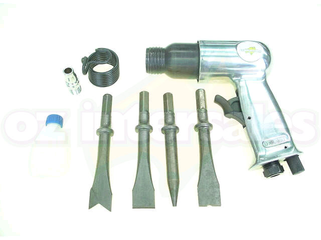

Today I had to chisel all the tiles off a toilet and bathroom floor. Years ago when I did a similar job I hired a smallish electric jack hammer. This time the hire shop wanted over $100 for a 1 day hire! But tools are much cheaper to buy these days so I looked at our local 'Bunnings'. (A huge cheap hardware and tool chain over here). A cheap Chinese Ozito impact hammer was $89 and would have done the job easily but they are pretty heavy and take 2 hands to use, so I decided to look at air tools at the local auto parts store. An air chisel alone was $39 but they had a couple of 30 piece kits they were clearing for just $59. The kits included chisel, rattle gun, air wrench and numerous fittings so the choice was obvious. I also bought an air hose for $20 (I already owned a small cheap GMC compressor)
Now the performance of this dirt cheap air chisel was just amazing. It only had about a 1" wide chisel but it sliced up the mosaic tiles like a hot knife through butter, and it was so easy and light to use. It virtually fit in the palm of one hand, and easily fit into tight spots like behind the toilet. I did the whole lot in a couple of hours. (Hearing and eye protection essential!)
So anyway I just thought I'd mention all this in case anyone is planning (or dreading) a similar job. If you already have a compressor an air chisel is well worth considering. You can probably pick up a cheap one for $20 to $30 on special. (Or look on ebay). It might not suit a really heavy duty job with large tiles but it was perfect for the job I described.
One really useful fitting that was in the kit was an air hose swivel attachment that fitted between the air hose and the chisel. It really made the the whole thing very easy and comfortable to use.
The pics below are not of my chisel and swivel, but they are basically the same as the mine. (I just grabbed the pics off the net). As far I'm concerned, even if I never use the thing again, its still worth every cent I paid for it.

You should see how good a "real" air chisel works.
   / Cheap air chisel for removing tiles...wow! #3
This air chisel looks similar to one that HF sells for less than $10. I used mine recently when replacing some bricks and it worked great. That, combined with my $15 4 1/2 inch angle grinder made the job quick and clean.

I recently was building a retainer wall and driving long spikes. I have one of those cheap air chisels and decided to modify the pointed chisel to help me with the job. I ground off the tip and made a 3/8" square tip that fits into a 3/8" socket. I used an old 1/2" socket and placed it over the head of the spike. One squeeze of the trigger and it drives the spike like a hot knife into butter. It's the best use of that air chisel I have found. It sure made driving spikes easy. I can see where that swivel would also be handy. I'll have to look for one of those at Harbor Freight. :)

I've been using the air chisel for tile removal and light jackhammer work for a few years now. My first one was a Campfield Housman (sp?) from Home Depot that did a good job before dying on me. I replaced it with one from Tractor Supply that was just a little nicer. Be sure to buy some extra springs. They are the weak link. You can rebend them when the part breaks off that holds the chisel in place, but after awhile, there isn't enough left to rebend. I have about four or five brand new springs on my shelf right now.

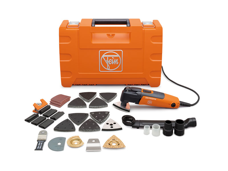

Or if you want to kick it up a notch over the air chisel get a Fein Multimaster. Really good machine, plus pretty versatile. Quite a bit more money though, but who doesnt enjoy a new tool?:D
Amazon.com: Fein MultiMaster FMM 250Q Top: Home Improvement
That's going to be my next tool. I've been comparing the various models and what you get with each kit. So far, it looks like ebay is the best place to get what I want.
I read a review of the Bosch and the Rockwell versions of the Multimaster. While they are half the price, neither compare. The guy writing the review said that you are better off saving a little longer to buy the Fein.
What I didn't know is that you can take out tile and remove thinset with one. I saw where they can cut out grout, but that's all I thought they could do in that area.
I mostly want one for cutting wood and trim. The way it cuts makes it ideal for remodels.
