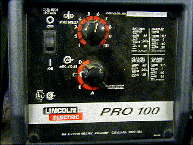

John D said:
Nice job Cliff. did you stick weld or mig it. jb
Thanks John. I used a mig welder (Lincoln Pro 100). Most people say they wont hold or get good penatration but I haven't had a broken weld yet. Metal prepping is a must when welding with a low amp welder. It also has allot to do with how the person is welding (ie..how he forms a puddle, his speed of welding, wire speed and weaving or pushing or even pulling the puddle). 3/8 inch is the max thickness I will weld with this welder that I have.
