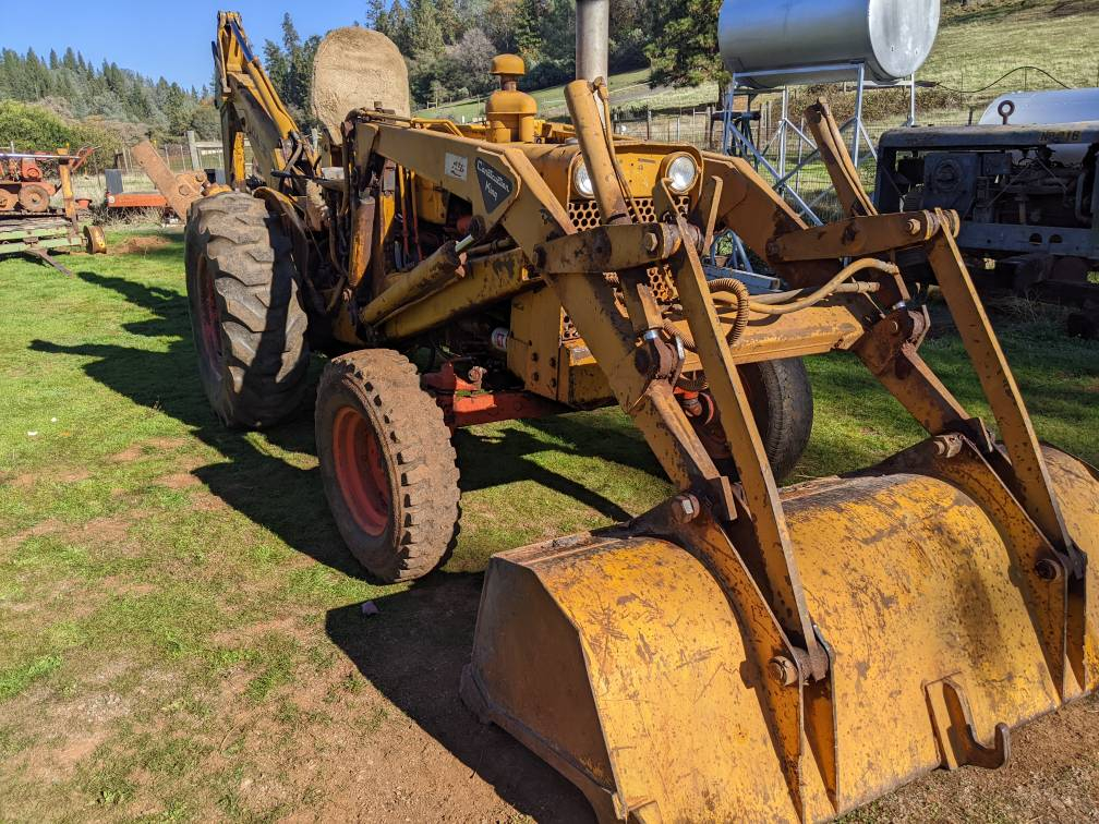

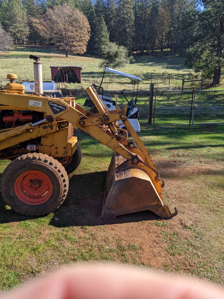

Alot of old and quite powerful loaders never had the 4-bar. The old ford 735 loader on the 3400's and the QUITE POWERFUL 740 loader on the 4500's were direct pin. The quite popular deere 145 loader. The IH 250 and 2250 loaders like on MANY 574's and 674's. All direct pin.
And most compact and utility tractors all the way up through the 1990's
The 4-bar linkage was/is quite popular on industrial stuff. With a direct pin, at full dump and full curl power drops off. The rollback force is a parabolic arc. With the greatest force right in the middle of its range of travel. At full dump and full extend....the pins are getting ever so close to being in alignment.....thus reducing force.
The 4-bar solves not only that problem....kinda flattening the curve of rollback force, but also allows greater articulation. Like upwards of 160-170 degrees of bucket rotation instead of 120-130 degrees of bucket rotation.
IF you look at a loader that has a 4-bar link when fully dumped.....you would NOT be able to direct pin it even with a longer cylinder without limiting how far the bucket can dump....because the cylinder rod would contact the loader arm.
Further more it keeps the cylinder rod away from the loader arm....and that tight pinch point that rocks or dirt can find its way into and damage a cylinder rod causing leaking out the gland seal.
All that are some of the many reasons they use them in industrial/construction type equipment. (none of which has to do with cylinder buckling).
Some time a few decades ago manufactures got the bright idea to start doing it on compact tractors. Then it was monkey see monkey do. So everyone started doing it. But there are still quite a few that dont, or manufactures that do both. The economy L-series kubotas are still direct pin, while the grand L's are 4-bar.
Look at skid loaders. Direct pin. But they also dont have as much total bucket rotation. They can go from cutting edge vertical to about 20-30 degrees roll back. So only about 120 degrees total rotation.
Smaller tractors dont need as much rotation as larger ones. Because they dont lift as high. So to get acceptable roll back at ground level.....a loader like on a compact or SCUT that can only lift 8' high doesnt need to rotate as far to dump as a big loader that can lift 11-12' high.
I dont understand why this concept is such a mystery to some. Sure, in THIS particular scenario Massey makes two identical loaders, one with 4-bar and one without. And in THIS scenario the 4-bar would have greater resistance to buckling for the reasons already mentioned....namely a shorter rod.
But to say things like a 4-bar will prevent bucking, or 4-bar means heavy duty meant to dig and direct-pin just just a material handler is ludacris.
