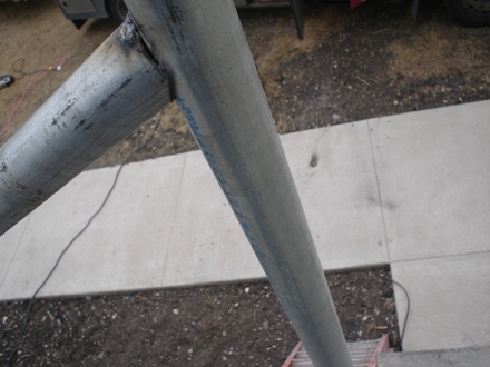

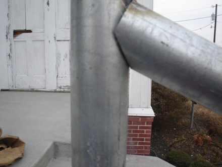

I took a picture of a joint I did the other day that showed using the half cut for a hand rail on a set of stairs.
You can see it works and makes what can appear to be quite intimidating really nothing but a thing.

I hope this helps anyone thinking about how to cut in pipe. I usually weld from the bottom up so a joint like this fills in nice as it goes leaving clean up usually just a wire brushing.

Yes.
On this particular job I had two intermediate posts and two end posts.
I cut the intermediate posts to height and then cut the half notch on the bottom side of the post. For the ends I cut approximately the same cut for the horizontal pipe to fit into the end post.
