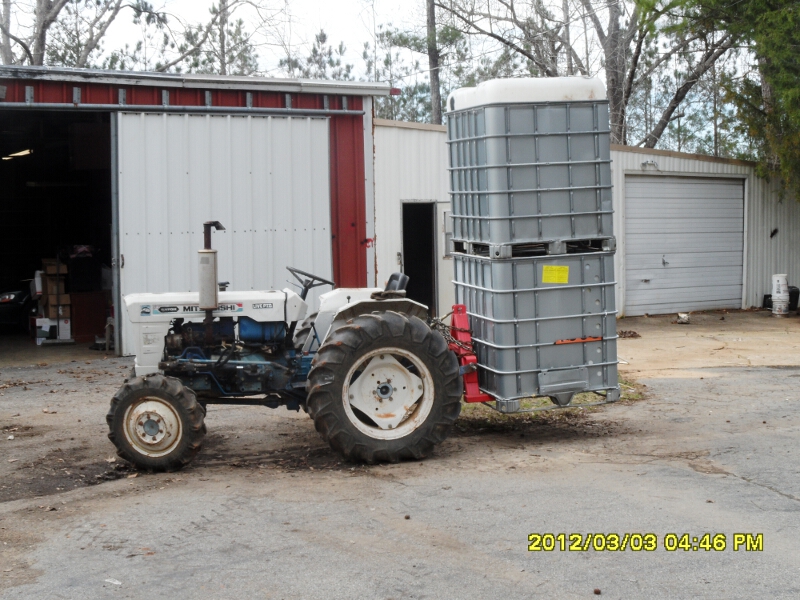

Totes - easy to fill and transport.
I keep one filled with rainwater running off a metal roof. Be careful toting them partially filled in a SRW pickup. I saw a lawn co. truck w/ one about 3/4 filled do a tight turn at low speed in our cul-de-sac and it about went on two wheels as all the liquid sloshed to the side.
