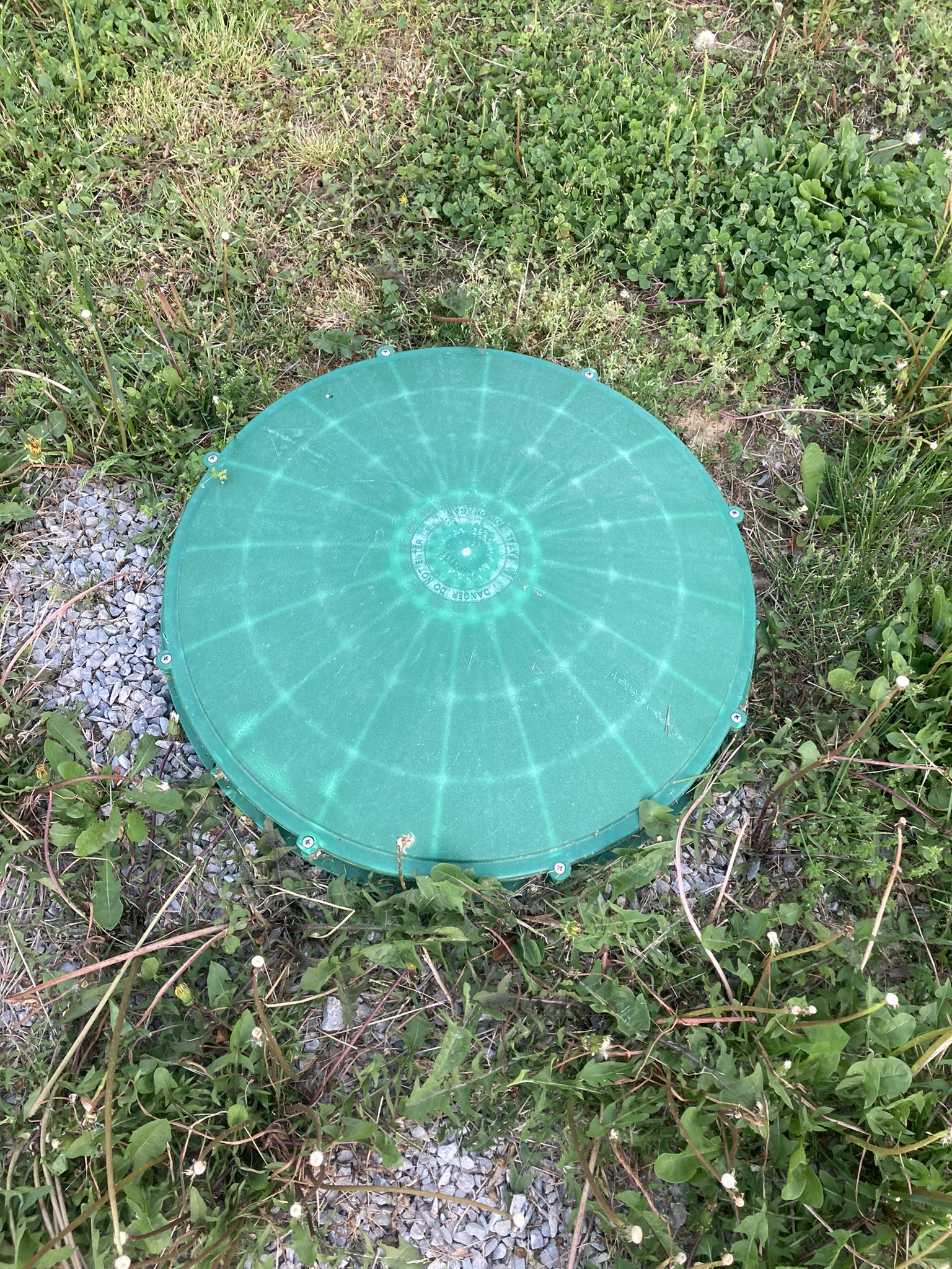

My septic tank had a very similar concrete lid, buried about 12”-18”, a bit of a pain to dig up for pump out. My sister in law works for a company that makes septic tanks, distribution boxes etc. They also sell an upgraded riser, and lid, maybe something you would be interested in. I won’t have to dig the lid up in the future or pay the extra fee some clean out companies are starting to charge to locate buried covers.
The older I get, the more I’m willing to make things easier for me down the road.
Mike

That is a great idea. The septic guy called me this AM. He suggests that before I do a pump out I get some liquids in the tank. It has been over 10 years since it has been used and the owner never had a washing machine even hooked up and he was a single guy. I am at a point that I can install a temporary toilet during the renovations to start loading the tank.

Sounds like your septic tank guy knows what he’s doing.
I would also have a garden hose connected and ready for him to use. The guy I use will add some water to the tank once it’s close to empty to help free up some of the more settled solids at the bottom of the tank.
Mike
