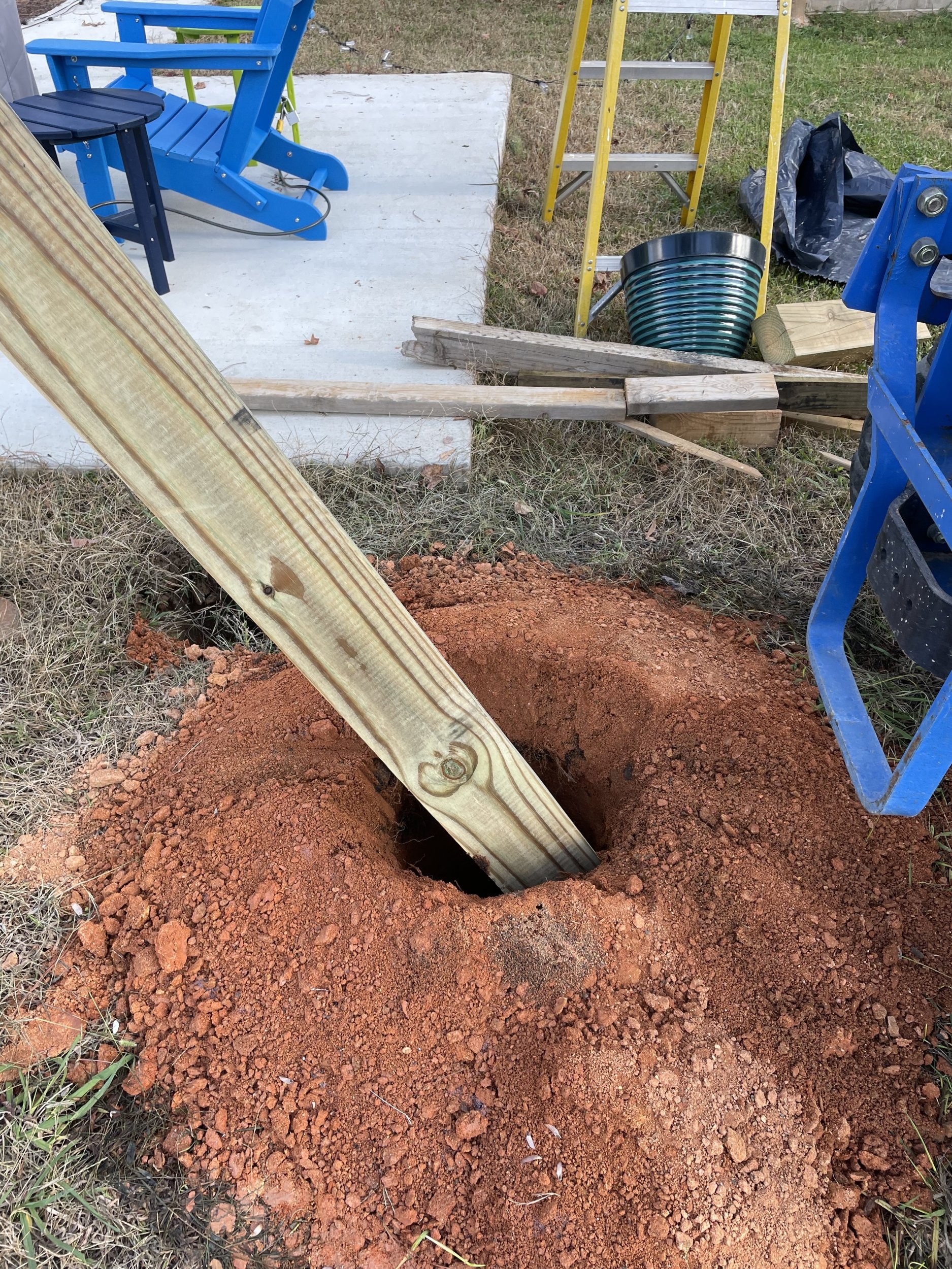

New cutting teeth were a big improvement in the hard soil. I had also watered the holes to soften them.
Remaining side is just as level. We had to flip the 6 x 6 x 24 to remove a bad bow and get a good side to work with.

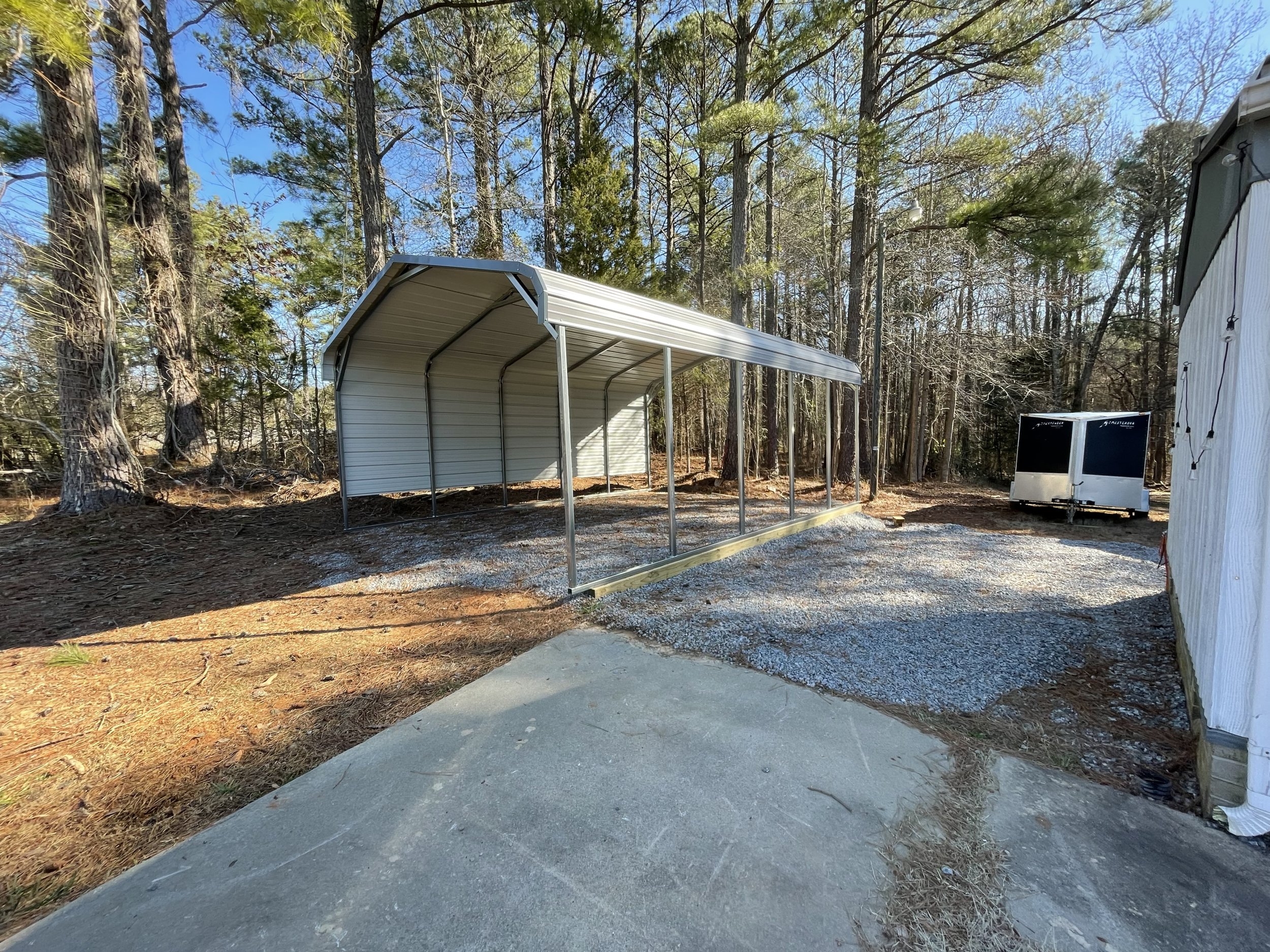

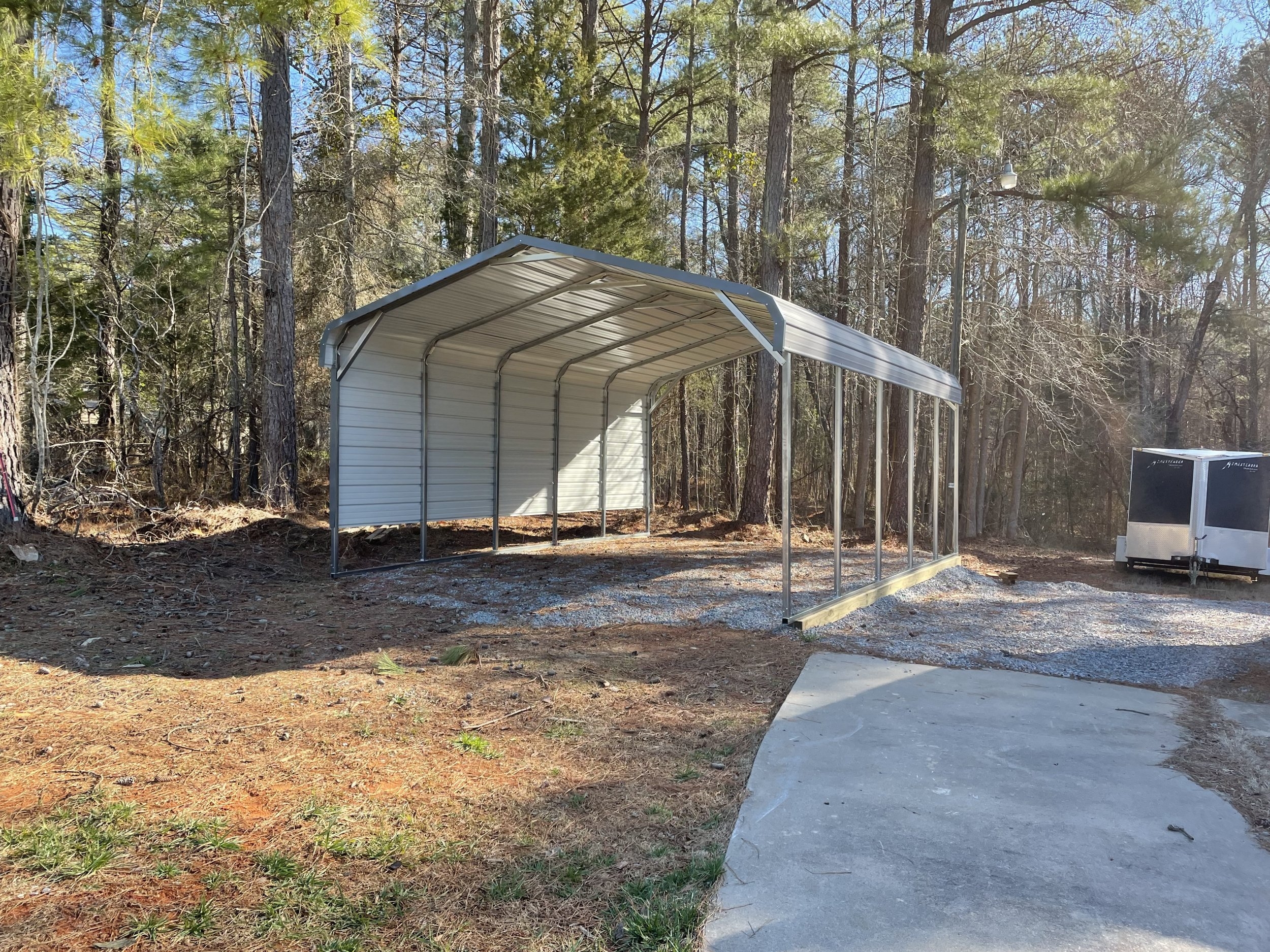

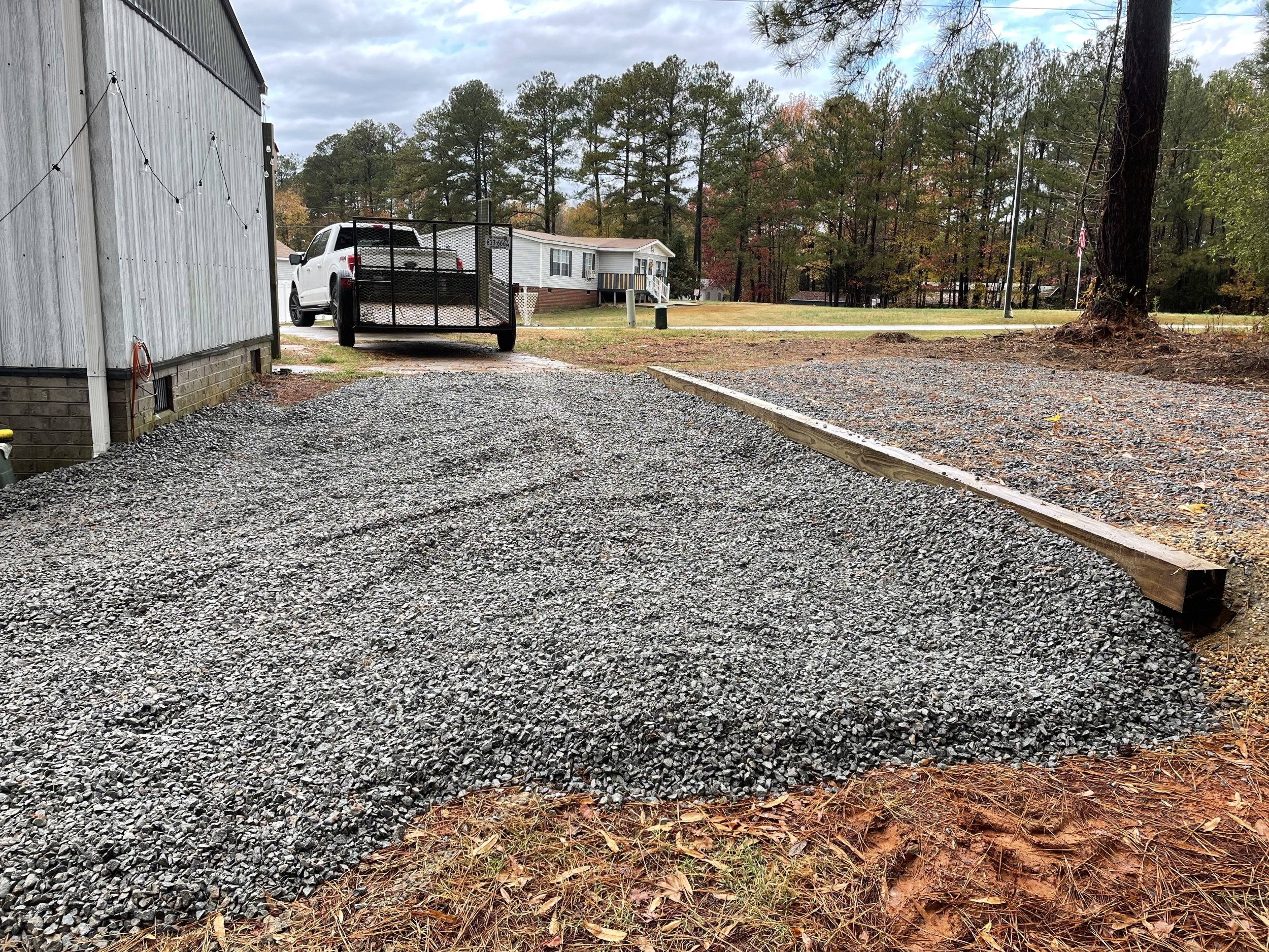

Dropped another 16 tons of gravel for the carport base. I let it sit with the clay I brought in for a few months. The carport should be there in January. It will be 18x26x8. This gives me a center height of 11’3”.

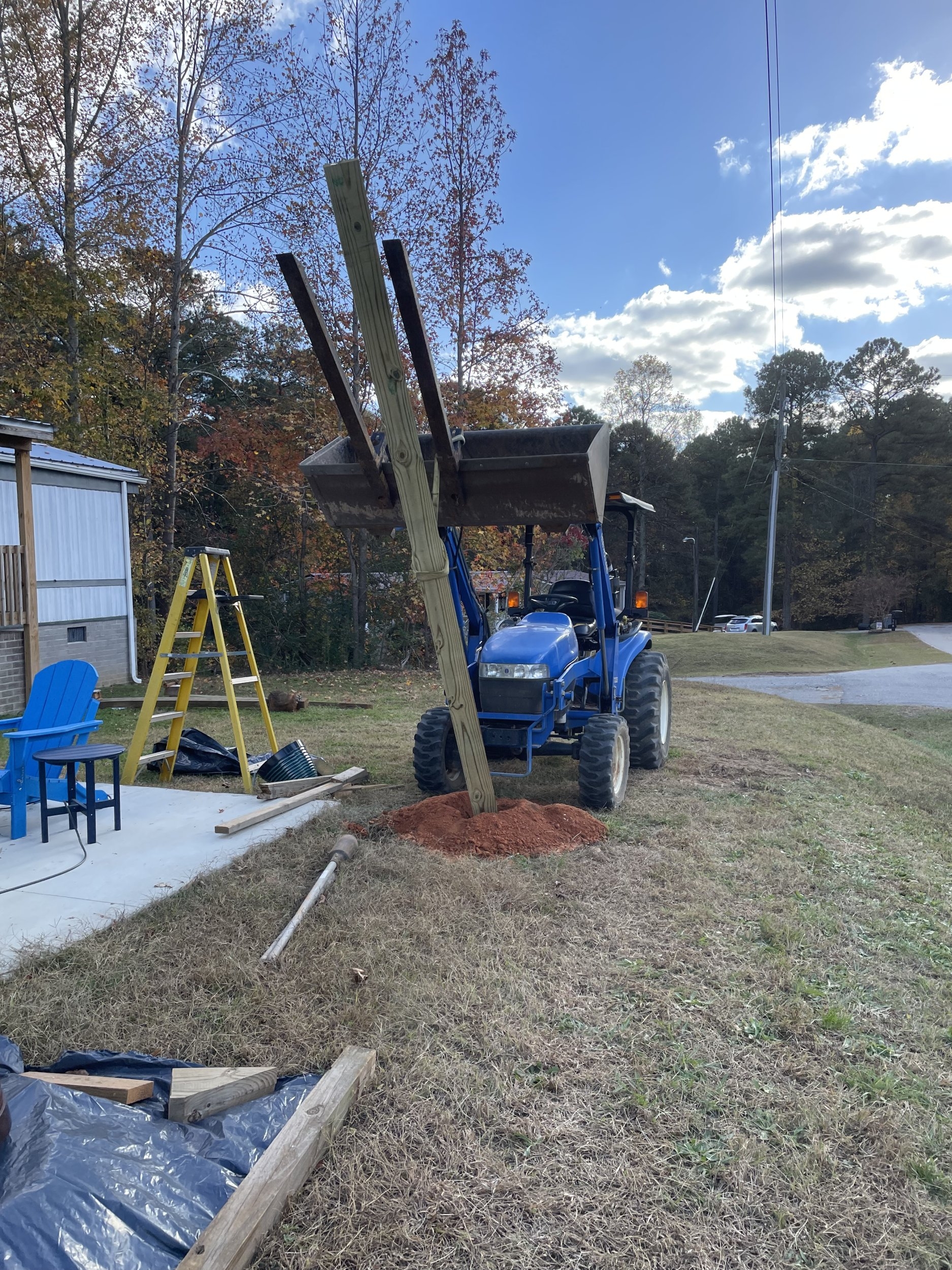

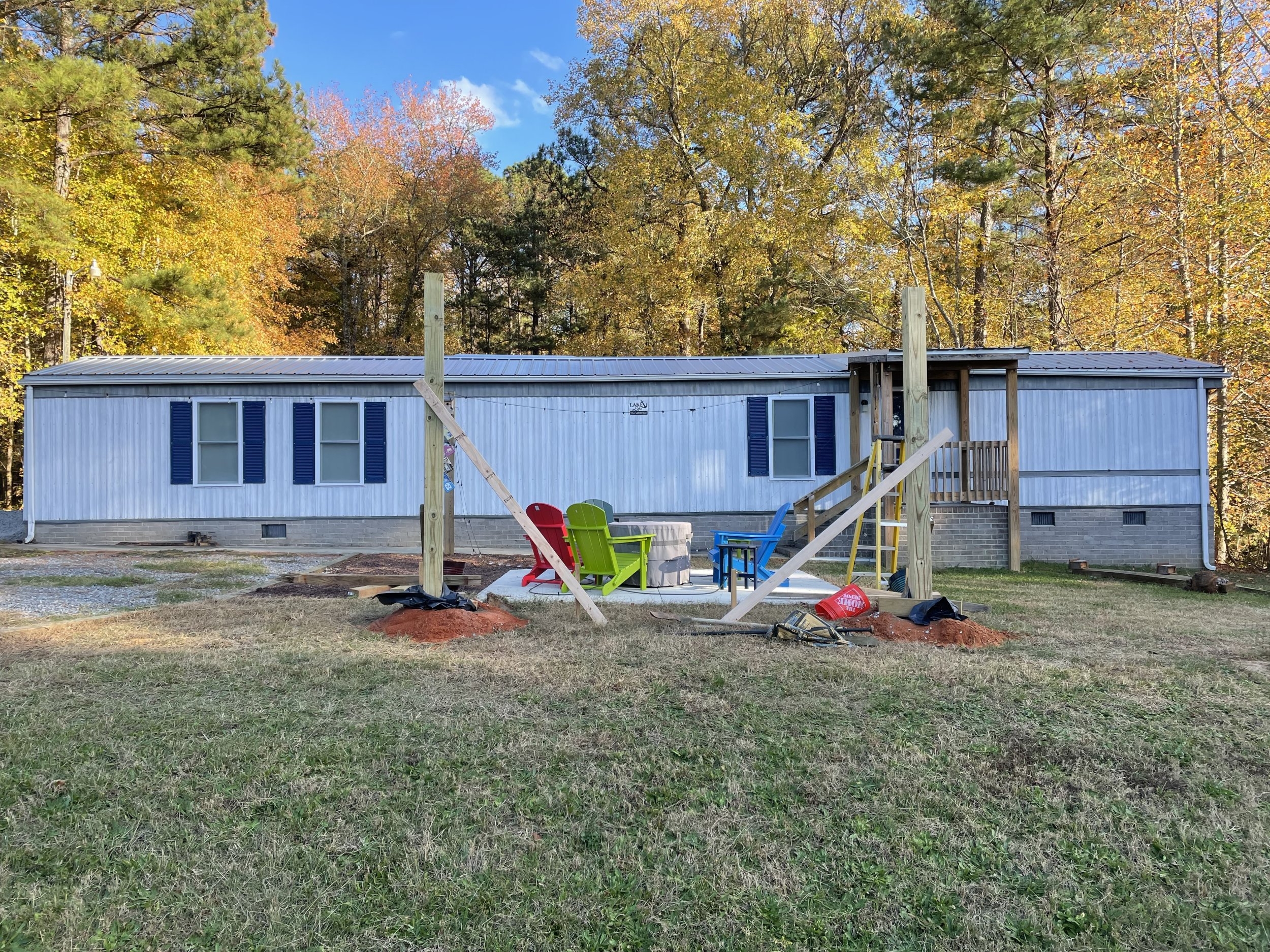

Original 4 x 6 posts were attached to a sunsail. When we had a 40-60 mph
Storm they moved. I had them in about 2’ with concrete but the ground was softer than I thought. New 6 x 6 posts are over 3’ with more concrete. They should never move!

When I showed my 3 sons what 64 year old dad had done, the reply was you had a tractor. I explained I had to stand them up straight to hook up the sling and they were heavy treated and wet. I am not sure they always appreciate my projects. 😀 One day they will. My 90 year old dad does.

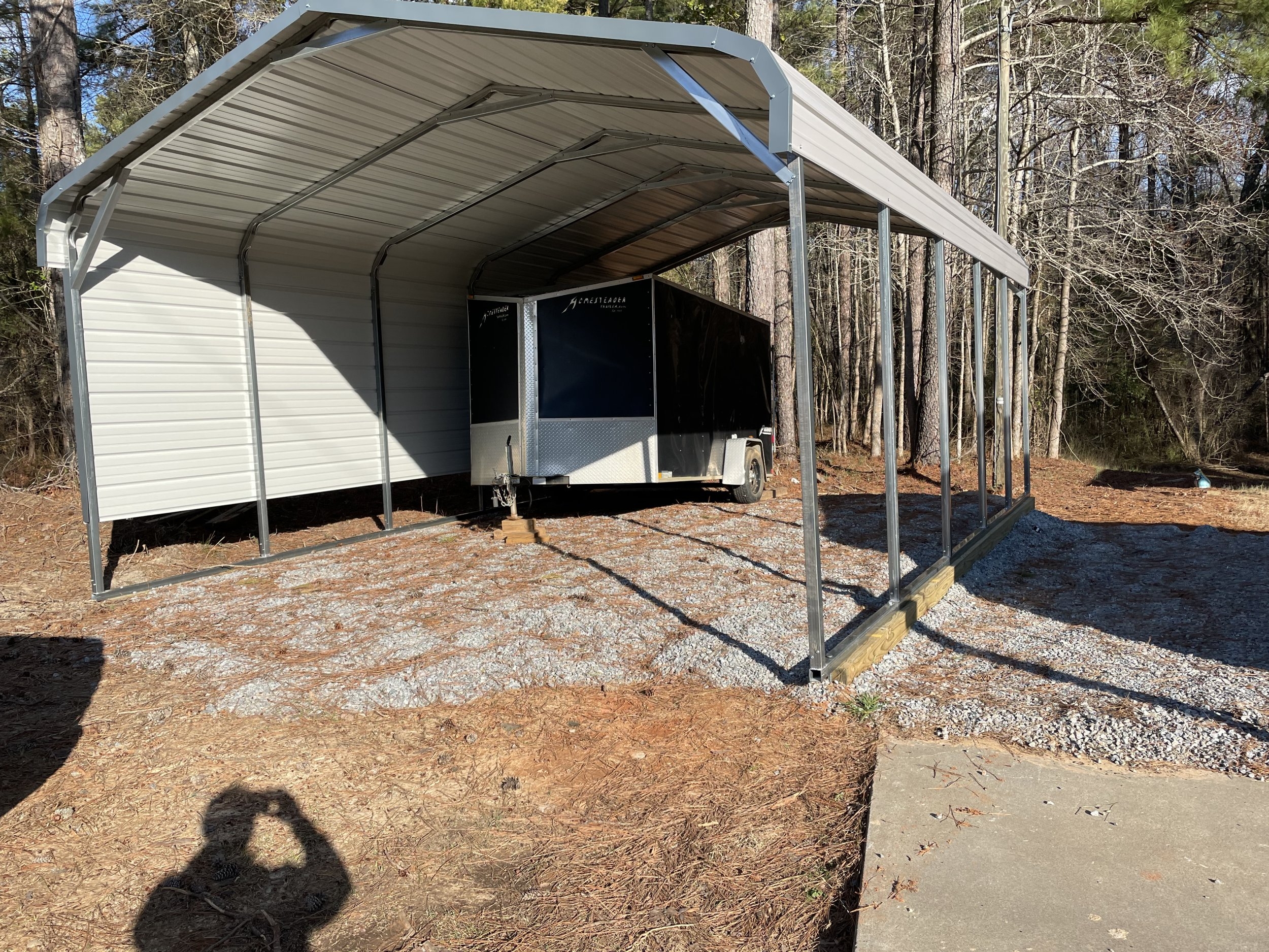

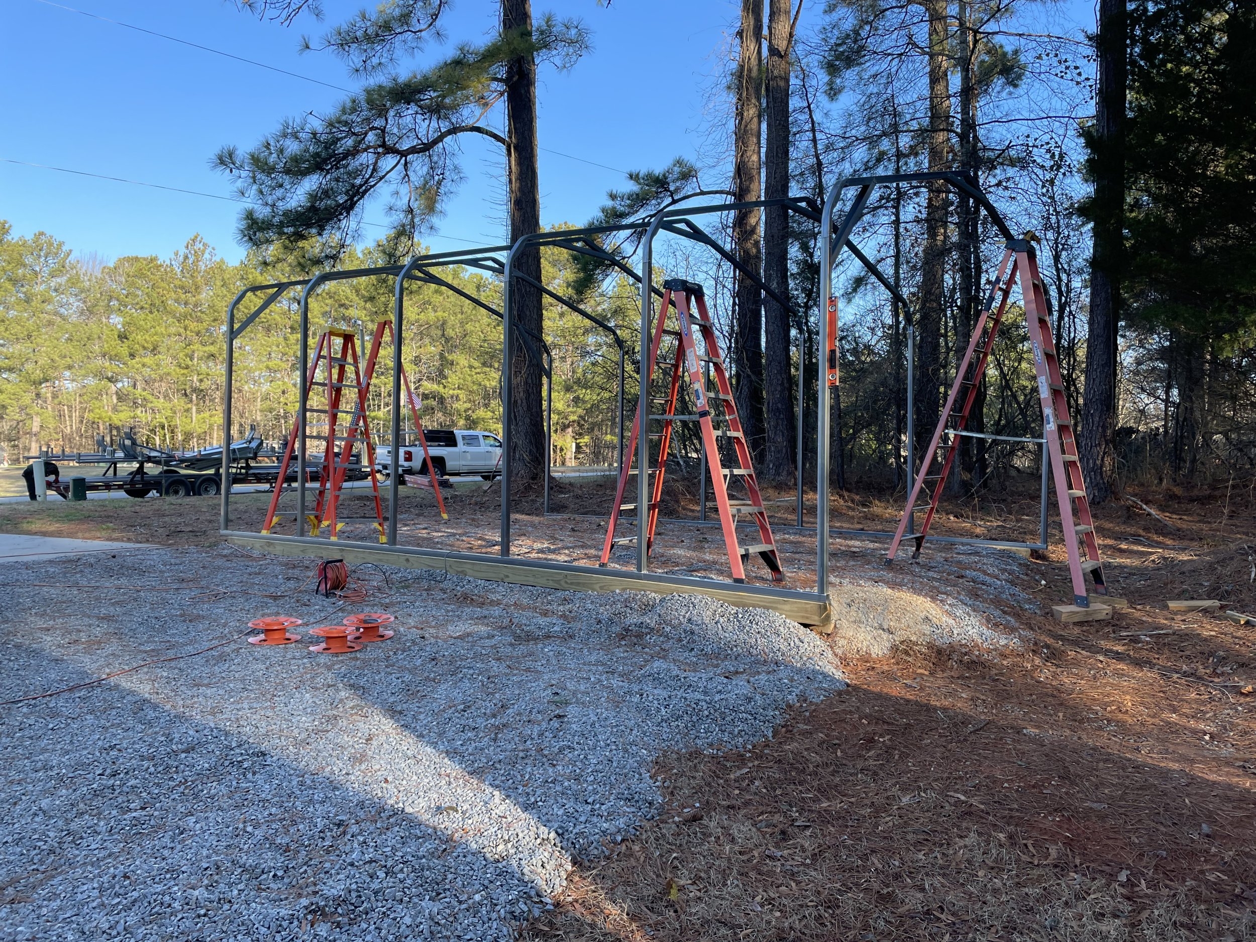

#308

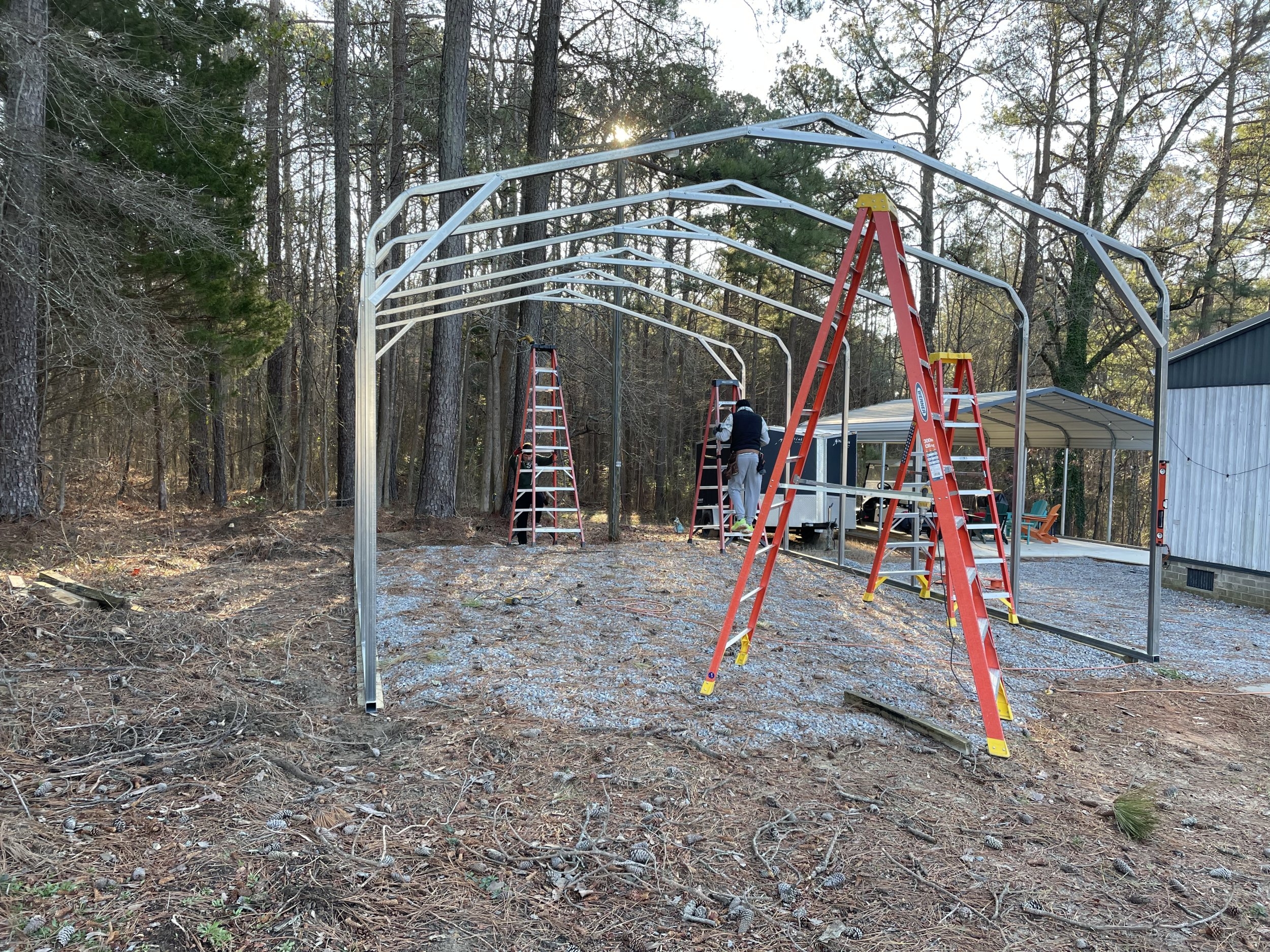

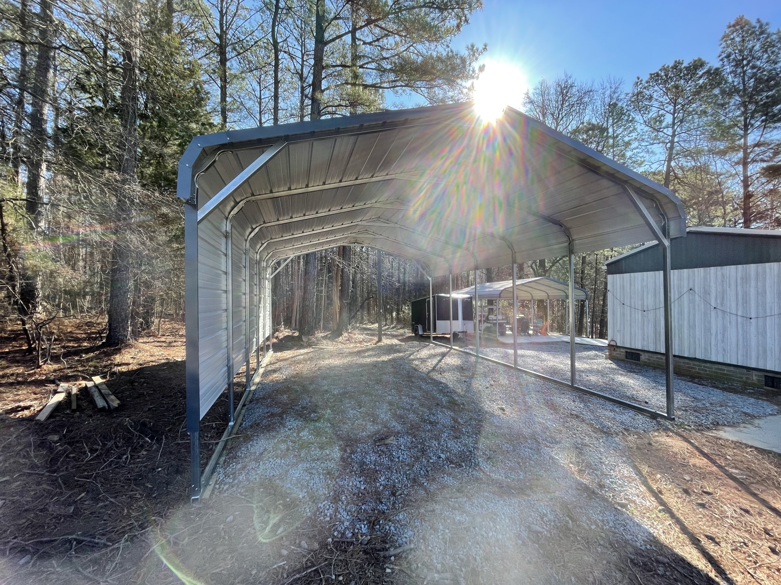

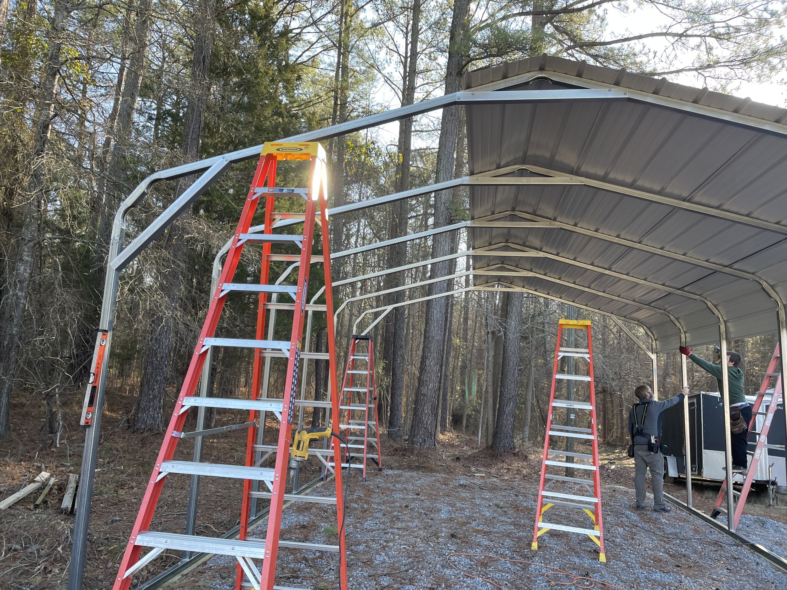

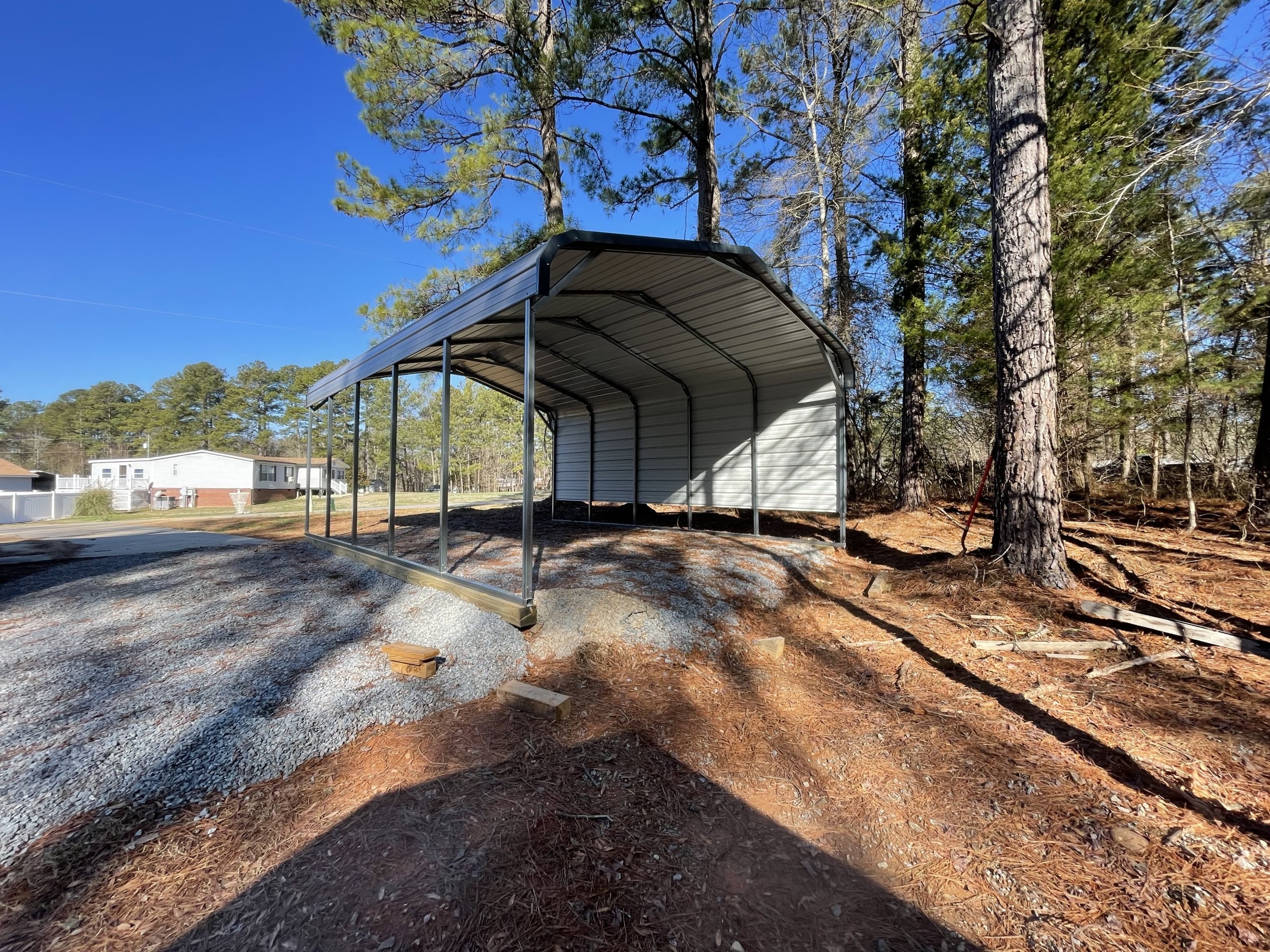

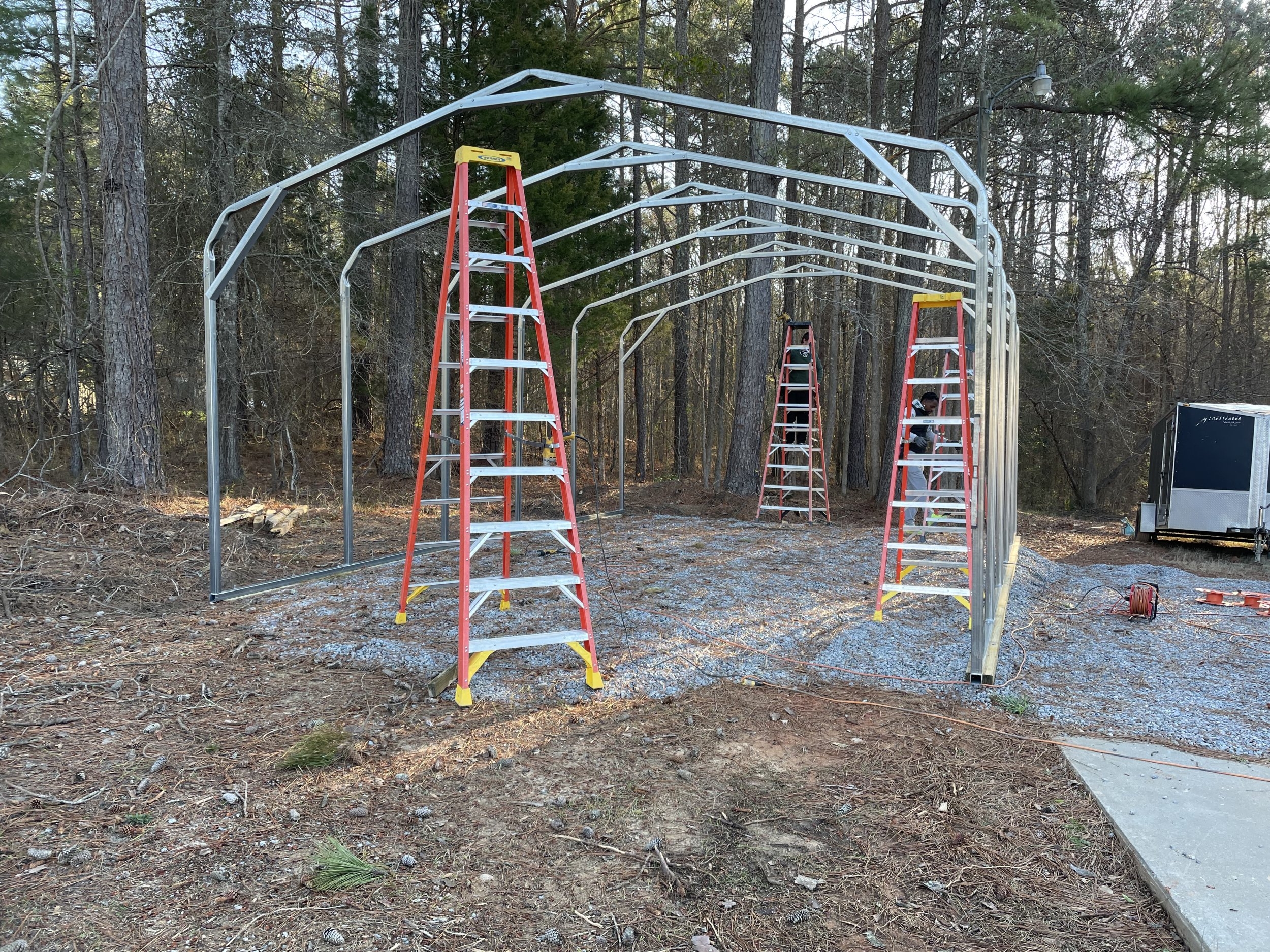

18 x 25 carport installed. They built it like they were fine furniture craftsmen. Maybe a slight exaggeration. They did take great pains to keep everything square and level. Super organized and in 2.5 hours they were complete.

#309
I used 1/2 x 6.5 galvanized screws to go into the treated 6 x 6 base.

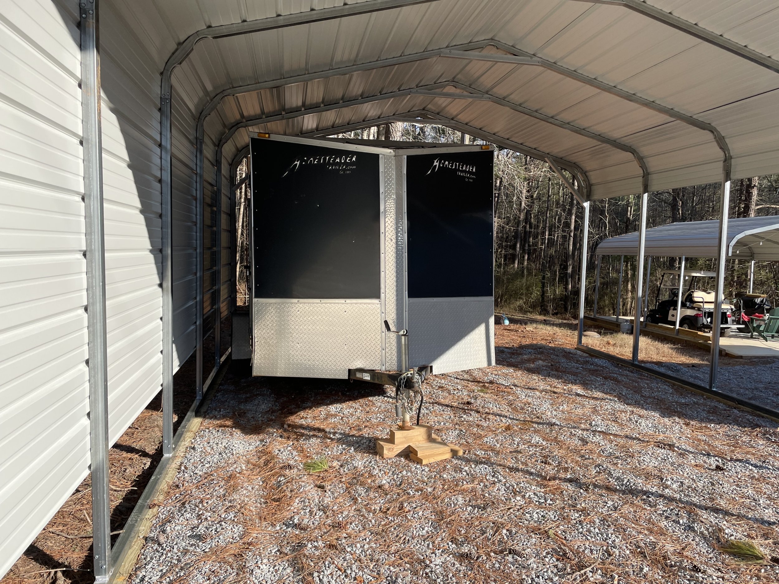

I am trying to figure out how to get a pontoon in there as well. Both pictures have the trailer in the same position. I may swing the cargo trailer perpendicular.
