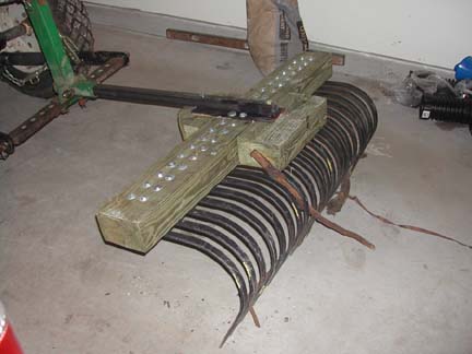

Just built a new house and getting a welder is way down the list as far as priorities, behind the brick patio, lawn, landscaping, 600' of fence to start, driveway, a barn would be nice, and about 10 other things. I ordered 20 tines from Agri-Supply, and had most of the other parts. I have about $80 Invested. A little concerned about how it will hold up, but so far it has work great. Now if the rain would just hold of.

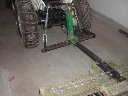

Here is a picture of the receiver hitch! The rake is about 48" wide, spaced the tines every 2". With the 4" X 6" Lumber is has pretty good weight behind it. Made about 10 passes last night, and it did a good job cleaning up roots etc.

Sometimes we have to improvise. As long as it is doing what you want it to do, I think you did well.
   / Cheap Landscape Rake #4
Maxfli, Judging by the amount of downloads (of your pic)you could have went into the business of manufacturing the product!!
Neccessity is the mother of Invention--
Empty pockets are the driving force!! /forums/images/graemlins/grin.gif
(know the feeling all too well, works for me...good job!

If it does the job, it is more than good enough. A little paint, some router work, sanding and it would be a high dollar item. /forums/images/graemlins/laugh.gif. Keep up the good work

<font color="blue"> did a good job cleaning up roots </font>
"Good is good enough". I bet you will break fewer tines than a factory rake. The wood provides a softer seat and a longer grip. See Dourobob's thread Is "pretty good" " good enough"
   / Cheap Landscape Rake #9
Looks good! In fact i was looking for an old spike harrow to drag up scrub. Would be a good sister to my disk harrow.
Having the tines turned down would cause a deeper bite I suppose, but I'd put a weight rack on top to finish it off. Not sure if it could take the punishment up-state glacial till.
On the welder, it is top priority in my book. I've got an old Lincoln AC buzzbox dating to 75 that's made me 8 trailers, a number of repair jobs, a jeep floorpan (bronze braze) and basically paid for itself 10 times over. That and a cement mixer you never get rid of.
What do the tines go for?
