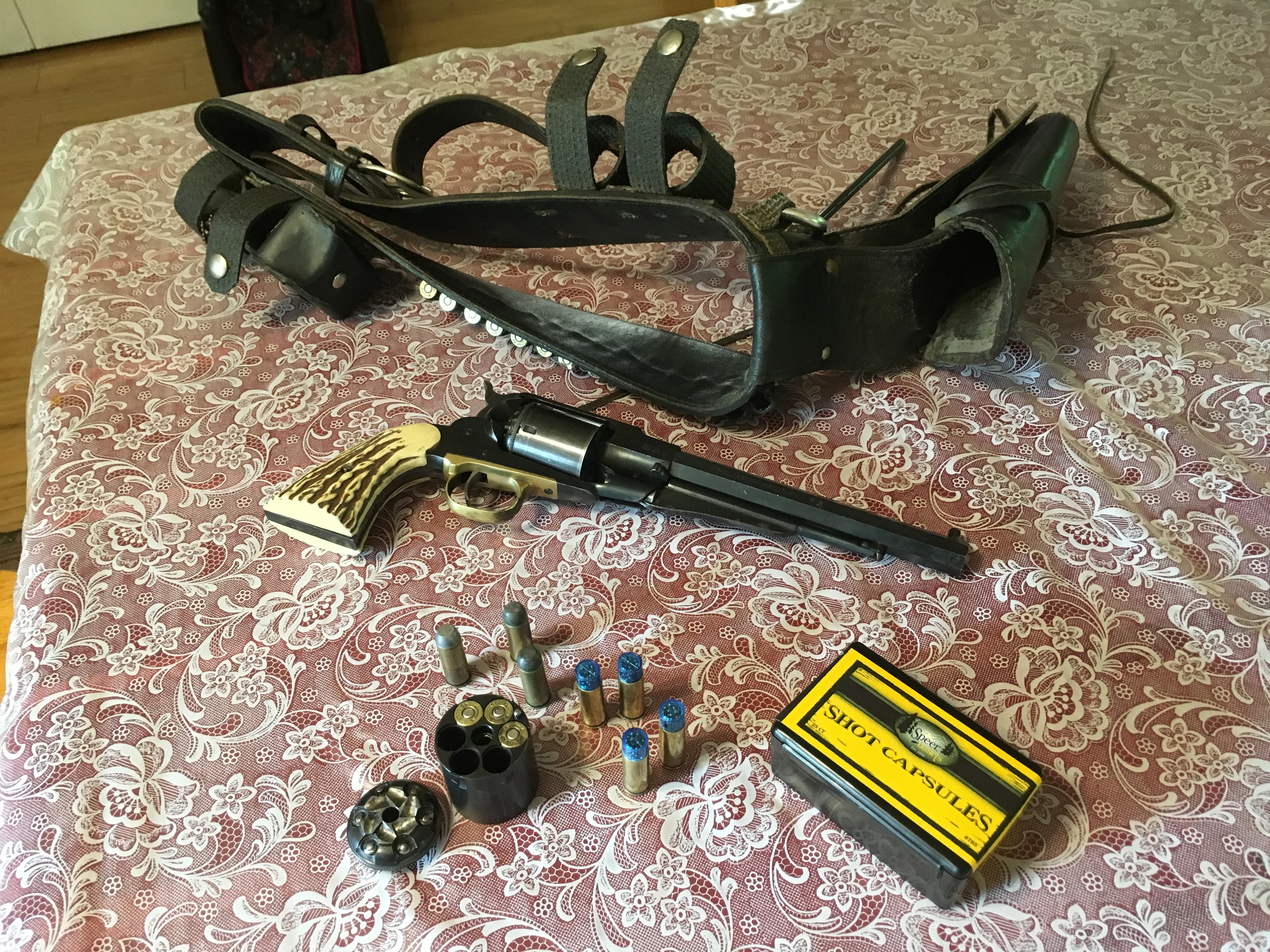

I wish you guys maybe girls or both would stop hoarding up these shot capsules, 6 years ago when I started buying these for my 45 colt they was all over the place and cheap. Few weeks ago after a couple days of constant web searching, I bought half dozen boxes from (Graf and Sons) then the other day they sent me a review and buy with no shipping cost order to my email, well I thought since these are so hard to find I'll order a half dozen more, so clicked on the link to reorder and to my surprise, OUT OF STOCK, AGAIN, there goes my free shipping incentive................. SPEER 45 COLT CAPSULES EMPTY w/BASE PLUG 25/bx - Graf & Sons
