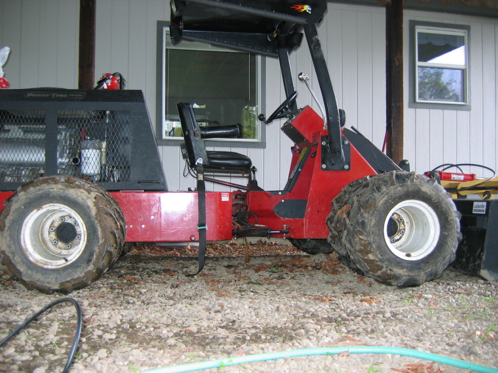

My flats have been a major frustration, and in looking at how much I have spent dealing with it, probably the most expensive repair on my PT. Honestly, I think I have spent nearly $500 in dealing with my tires so far.
They are, for the most part, used. My initial problems were valve stem related (Tubeless). I put on steel stems, that helped a bit (not cheap) but I still got debris between the tire and rim. So now I am switching out the tires to tubes, with valve stem protector welded on. Thankfully ken sent me 2 extra tires so I have not had any serious downtime.
I have up north 2 flats. I figure it will be 30 to 40 all in to get them fixed at the shop. Then this conversation came up about the tire changer. Never thought of doing it myself.
My PT runs in some rough areas, although it is improving. The rims are rough at best. The tires are not new. I run about 8lbs on the high end.
Carl

No setback. Flange welded to the edge of the rim There is a ring spacer between each rim (about 2" by 1/4" by 12" oval) ring that divides the tires. All rims are identical, you just turn one over the motor, or pointing out, with the spacer inbetween.
There are two sets of bolts on each stud, one for the inner tire and one for the outer.
I don't really have any good pix of the rims, here is the best I have.
How in God's name did all those dings get in those rims. IEDs? They look like Iraq war surplus stuff. :eek:
   / Cheap Tire Changer for PT
#19
Ain't that nice? Mostly that is the way some of the rims came. I was concerned, but the tire guys said they were fine.
I have been cutting alder groves on my property, and the stumps range from 1" to 4". They really bung up the rims..
