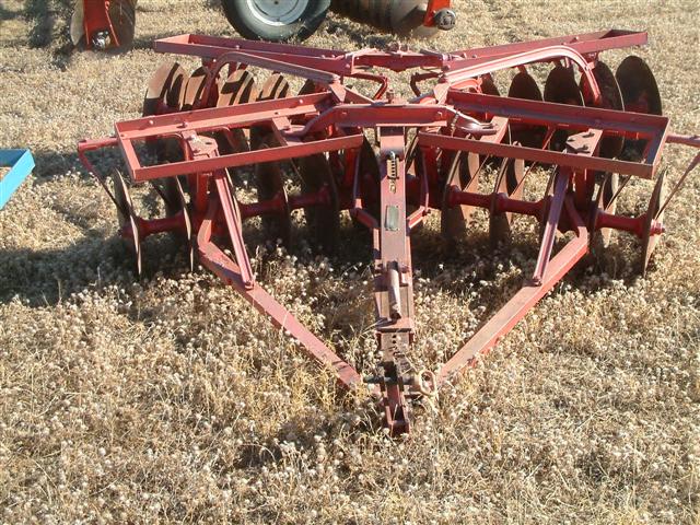

I have 5 acres of property we got last summer. The previous renters seriously overgrazed the land. A lot of it was bare or taken over by weeds & some of it is rather rough. I've done a bunch of re-grading with my back blade & box blade already & have a bit more to unbury the back of my shop & generally to get water channeling away from it and the house, but have a bit to go.
I'm looking to end up with some reasonably smooth ground covered in native grasses. Low maintenance high prairie type stuff that I'll hit with the rotary cutter a couple times during the summer.
Would a small used disk, something like a cheap used 5' tandem disk work behind my L3200 (3,800lbs & 32hp) to get things sorted out enough to put down some seed & end up with some smooth field? Or am I going to need to look at a plow as well? I might be able to borrow a seed drill from a neighbor, but I need to track him down this spring & see what he has.
I'm a tool junky so am inclined to get more toys & do it myself, rather than hire it out or something, but if I'm looking at a reasonable amount of gear to get the desired results, that might be an option.
Any suggestions if I should try & grab a cheap used 5ish foot disk, or look at something else?
I found an old, but usable, 6-ft wide tandem disc at a local tractor dealer--cost $125. Discs (aka pans) were in good condition. Put new grease zerks on the lube tubes, packed in a lot of grease (from Tractor Supply) and ran it over my 6 acre hayfield. Worked fine.

A small disk should work with several passes as others have suggested. I would also consider a landplane to smooth the property and maintain your driveway which would be a seasonal use for it. I use landplane grader blades in New Mexico to smooth fields all the time with excellent results. You may be able to use a landplane to smooth out the field and rent a drill from a local NRCS office to plant with. That might be the best bang for the buck as you would only buy something you can use on an ongoing basis.

If I were in your position, I would not attempt to do the job with ONLY a disk, of any type, behind a 32 hp tractor. With a much larger tractor (say 75 hp), you could do it with just a 10-12 ft. pull-type, wheeled, hydraulic- lift disk. Don't sweat it however, as you can still do the job with your tractor. You will just need 2 tools instead of one. Start out with a used, 2-bottom X 12" or 14", 3-pt plow, which can be located in most areas for under $300 on "craigslist". Next, find yourself a decent, used, 8 ft, drag-disk. If you stick with a good brand, like John Deere, you will get little or no "ridging" of the soil, and not need to level the ground after. Lesser brands, like Bissell, or IH, will leave more "ridging" and may need "dragging" after, depending on your preference.
The 8 ft. drag-disk may be the most numerous, used, farm implement available, and you should have no trouble at all locating one of them. Because they are so numerous, and lots of folks don't like them because they lack the "3-point" (they just don't "know-no-better"), cost is low, and you may be able to find one for under $200 (The last one I got was about 1/2 the going scrap-steel price). For your application (no little gardens, or need to transport over the road), you should certainly steer clear of the 3-pt disk. In my opinion, the disk is the poorest application of the 3-point hitch, and most always, for larger than 1/2 acre, will consume double or more the fuel, of a drag-disk, to get the job done.
