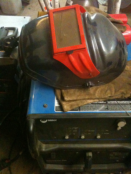

I have a Northern Tool auto-darkening helmet, also have a Miller Elite Series auto-darkening, like them both but have been flashed a whole lot while tig welding with both AD helmets. I then got an Accu-Strike helmet and really love it, it does take a little getting used to but it is the only helmet that I have used over the past year and a half since I got it. I do not even pick up the NT or Miller Elite any longer, they are just collecting dust. The folks at Accu-strike are great to deal with also, here's a link to their website Home - AccuStrike Welding Helmet they have some vids of the helmet in use on their site.
