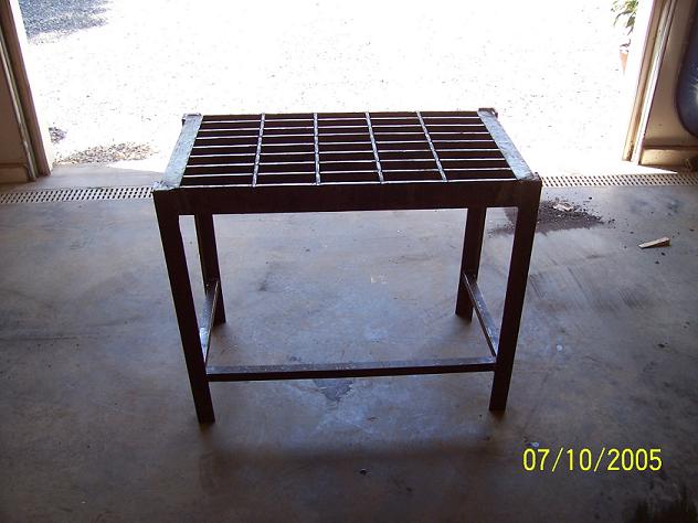

I just completed a project that I think TBN'ers can use.
I was at my local dump scanning the scrap metal piles, and for $10.00 & 2 hours time, made a sturdy welding table.
The table top is an old storm drain grate. The legs are 3/8" x 2" angle. The cross pieces are 1 1/4" square bar stock.
The rough dim. is 30" wide by 20" deep. The legs are 30" high.
Adjust to your particular use.
Try to find a grate that has not been tarred over, but for $5.00 you can't be too choosy. /forums/images/graemlins/grin.gif
Scrap metal & welders; a perfect match.
WALT

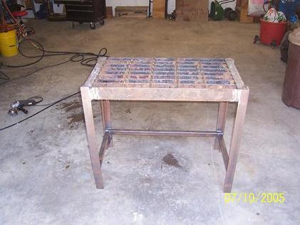

picture #2

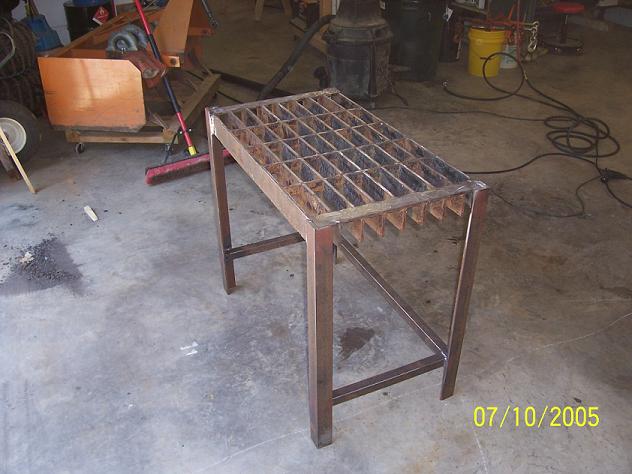

picture#3

Add some wheels and your good to go. Nice job.

The wheels & handles idea are the next step. I thought of 4 casters, as I have built castered dollies for most of my attachments. They make hook ups easy. However having the table sit flush to the floor without moving works best.
At present, I just have to drag the table 10' from it's spot to my welding area, but that takes it's toll over time.
I'm glad this is helpful for you. My workmate bench has more scorched top than wood from earlier projects.
