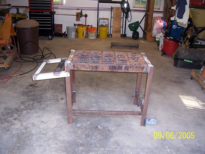

I just completed a project that I think TBN'ers can use.
I was at my local dump scanning the scrap metal piles, and for $10.00 & 2 hours time, made a sturdy welding table.
The table top is an old storm drain grate. The legs are 3/8" x 2" angle. The cross pieces are 1 1/4" square bar stock.
The rough dim. is 30" wide by 20" deep. The legs are 30" high.
Adjust to your particular use.
Try to find a grate that has not been tarred over, but for $5.00 you can't be too choosy. /forums/images/graemlins/grin.gif
Scrap metal & welders; a perfect match.

Add some wheels and your good to go. Nice job.

Walt, your post is a timely post for me. A couple of weeks ago I got a drain grate also. My grate is half the size of yours so I also got a flat piece of 3/8 metal. Together they will be about the size of your welding table. I had planned on having handles on one side on top and 2 wheels as the base on the other side so I could move it easily. I will use some of your ideas for the base. (My wooded saw horses are taking a charing.) Thanks for sharing! /forums/images/graemlins/smile.gif

The wheels & handles idea are the next step. I thought of 4 casters, as I have built castered dollies for most of my attachments. They make hook ups easy. However having the table sit flush to the floor without moving works best.
At present, I just have to drag the table 10' from it's spot to my welding area, but that takes it's toll over time.
I'm glad this is helpful for you. My workmate bench has more scorched top than wood from earlier projects.

I would recommend just two wheels, so you can tilt it back when you want to move it, but have two legs solidly on the ground when you want to work.

Finally got the casters & handles welded on. It's well balanced & rolls easily around the garage.
