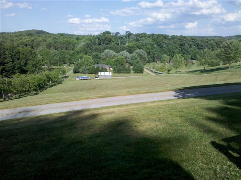

Here's a picture of the property from the front porch. Property line follow tree lines and driveway.
I've been given a fairly long leash as far as budget goes with the understanding I won't spend more than needed. She'd be fine with 25k with the understanding that I better be **** happy with the purchase. The terrain is wide open, no obstacles, smoothish but there are some areas that I have to back off of the x500 to save my back and kidneys from jarring around.

I'd go with the ZTR, if your primary concern is to reduce mowing time. With a CUT, you won't be mowing any faster then you are with your x500...maybe not as fast, in fact.
With a $25K budget, you could get a good used ZTR and a good used tractor (think early 2000's Deere 4000 series) with a loader for you drive work. I expect you could do it for considerably less then $25K, in fact.
