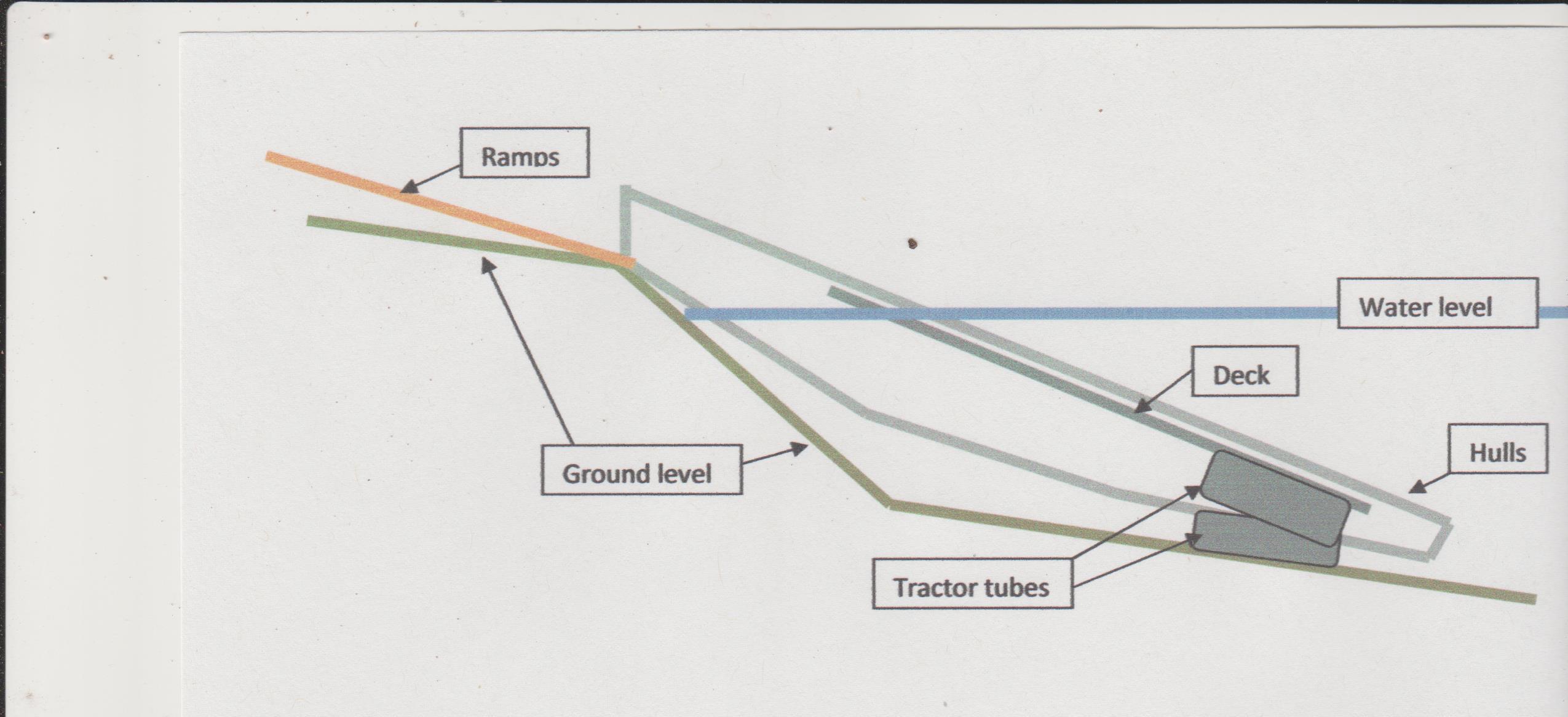

Probably should have provided this schematic in the first place to illustrate the angles involved.
Agree completely. Problem with hiring gear like a trash pump is the distance from nearest city to this property - a 3 hour round trip - once to collect and again to return it. My compressor is just a typical "handyman" shop version but more than adequate for filling tubes.
Also as stated earlier, tubes inside the hulls will not add much displacement because the hatch access is quite small and the hull volume at that point is very limited. I also agree that outward pressure in not what the hulls were designed to take
The positive element is that angle of the boat means the hulls have 50% fill at most. Also, when floating normally the deck is only about 300 mm above the water line, so while sunk, tubes placed between the deck and the earth surface should be capable of lifting the aft ends high enough to allow pulling onto the ramps without doing damage. Once the boat reaches about the "half out" position, the angle will allow much of the water to drain.

Even if it was feasible to raise the water level, it would only make things worse because the stern of the boat in on the bottom. I did think about drums but the inner tubes will be easier to lash to the underside of the deck - there should be plenty of lift from 2 tractor tubes
