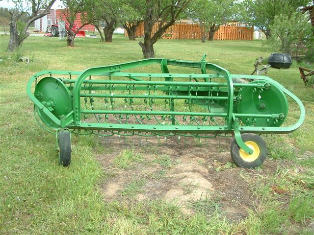

Rake: mine is an old John Deere 350 model (3pt hitch type) 5-bar side delivery rake. Cost: $800. These side delivery rakes are being replaced by wheel rakes and rotary rakes nowadays.
I'm looking for a wheel rake (4 wheels) for next haying season.

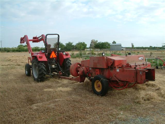

Baler: mine is 1970s Massey Ferguson 124 2-twine small squares baler. Cost: $2000. Works OK.
Hope this helps.
