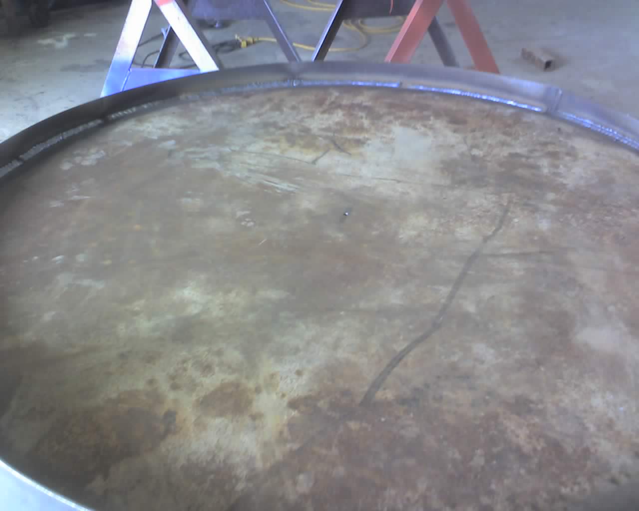

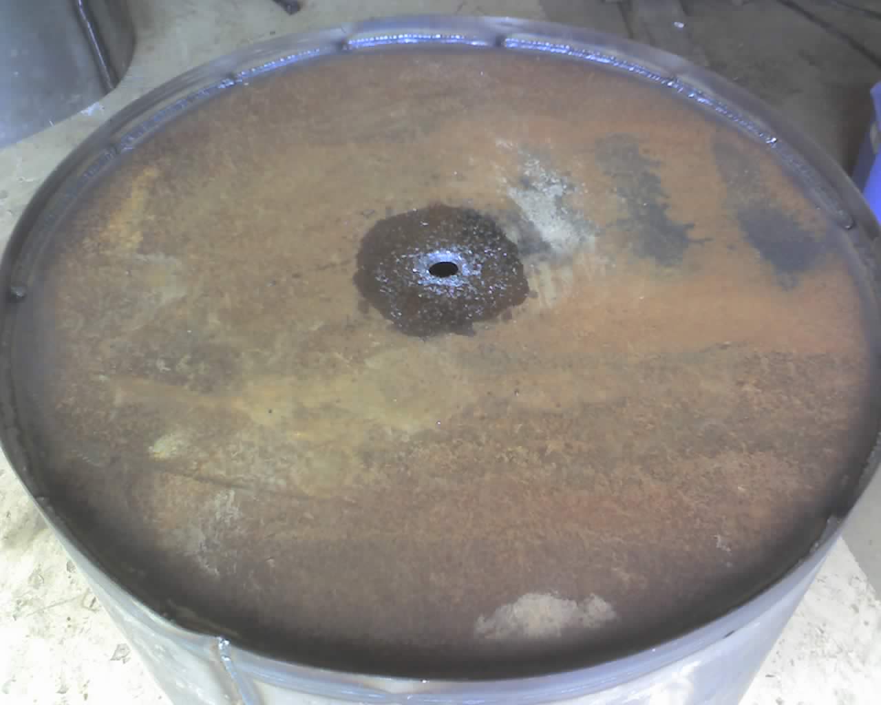

Heres a pic of some of the 38" circles we cut out of 1/4" for the lawn roller. Using the method I metioned above with the two washers and piece of wire.
In the first pic, you can still see the small pilot hole, before we drilled it bigger for the axle.
