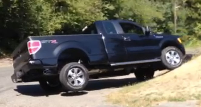

Did a little testing (at 30 miles ownership :D ) The Ford Electric Locking Differential works as expected (a full "LOCKER") but I have to wait for snow/ice to test the Traction control "Off". (fingers crossed it doesn't p*** me off)

OK so your traction control works automatically unless you turn it off, and the locker is strictly manually engaged and disengaged. The is probably the best of both worlds,

Now all you need is a anti-sway bar disconnect to let your suspension move. Nice pic though.
That won't help with the f150's independent front suspension. Independent suspension has very little articulation.

It only has 130 miles on it at the moment. Maybe after closer to 200,000 miles I may consider mods like that, if I'm still feisty then
