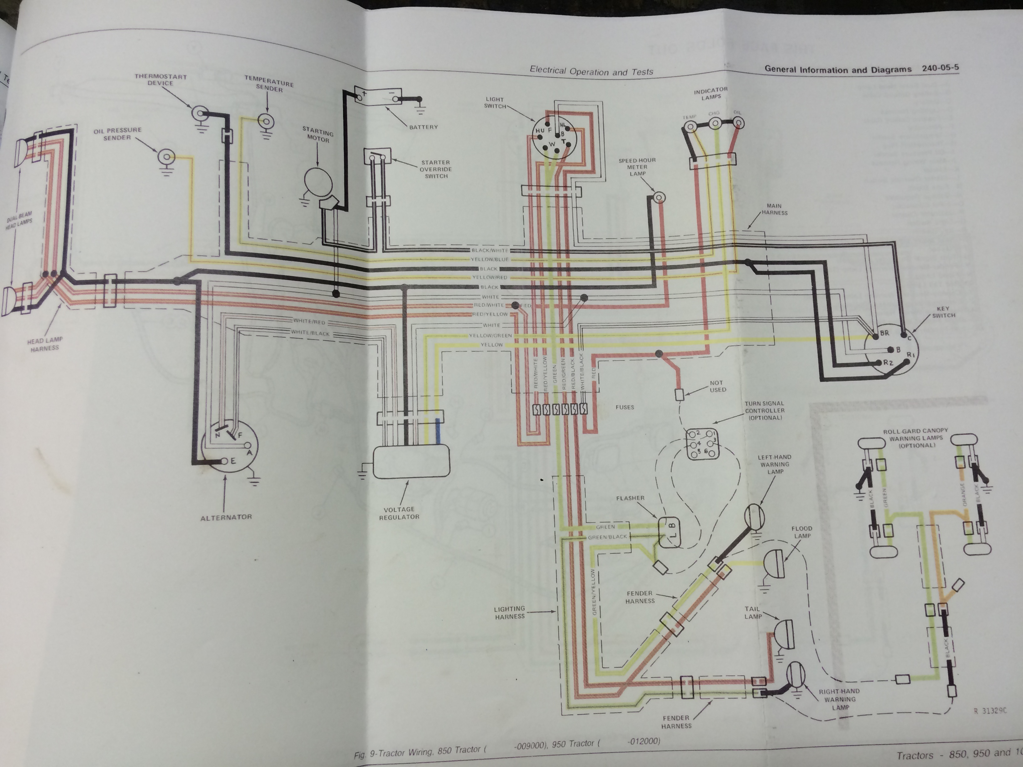

Here is the schematic

I'm using the same bulbs in mine. That's a fresh diagram, easy on the eyes haha. Honestly everything seems to be pointing back to the voltage regulator. Although power is getting to the CHG lamp so why it's not lighting is mind boggling.
   / CHG Indicator MIA - JD 850 #15
Since there is only one hot wire that goes to the 3 light indicator assembly I think the bulbs get there ground at the 2 senders and the voltage regulator. I would disconnect the yellow/green wire at the voltage regulator and try grounding it. Am I reading that schematic right? I'll be the first to admit me and electricity just barely get along. I know the way to test the temp light is to ground the wire at the sender.

I contacted the seller about the wire coming off of the VR and he said this was a ground wire. So taking what y'all said about me not possibly having a good ground while testing the light I went back at it using multiple spots. That's my fault, rookie error.
After finding a good spot, I grounded the VR and that seemed to cure the CHG lamp problem. It now glows although they're a bit dimmer. Once I decide on a final ground location I'll make sure it's nice and clean and maybe that will brighten them up.
Also testing around for a better ground i final got a decent reading on the alternator. It's still not churning power efficiently being at a nearly constant 12.4 (or really just matching what the battery has as every time I start the engine and the voltage drops so does the reading at the alternator). Sorry to waste yalls time on such a simple error.
