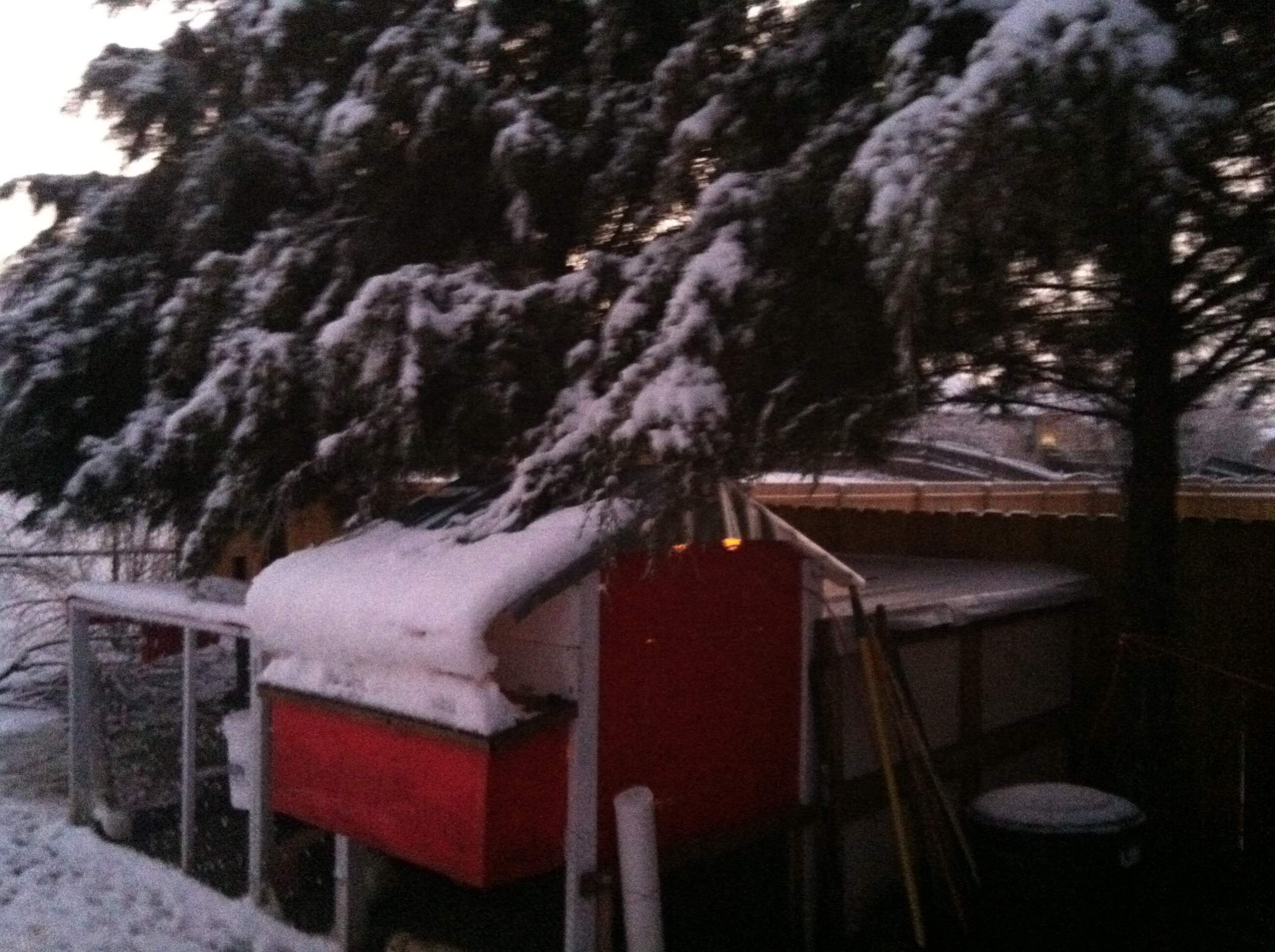

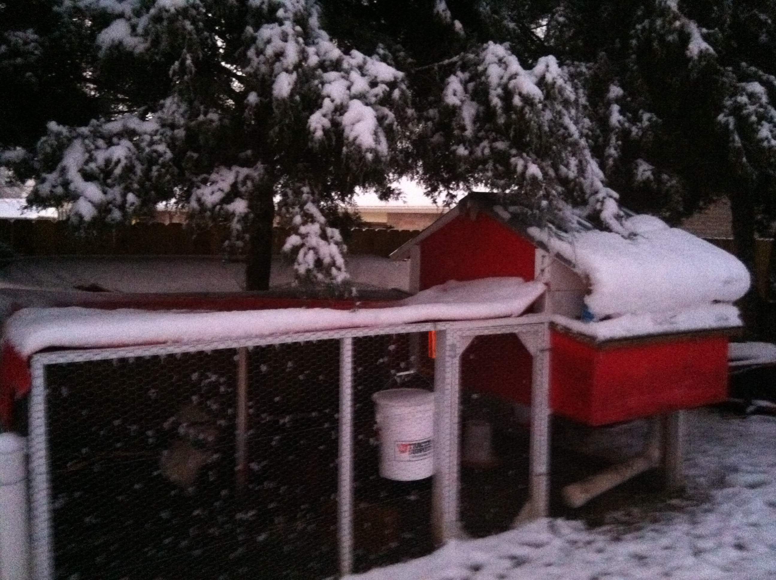

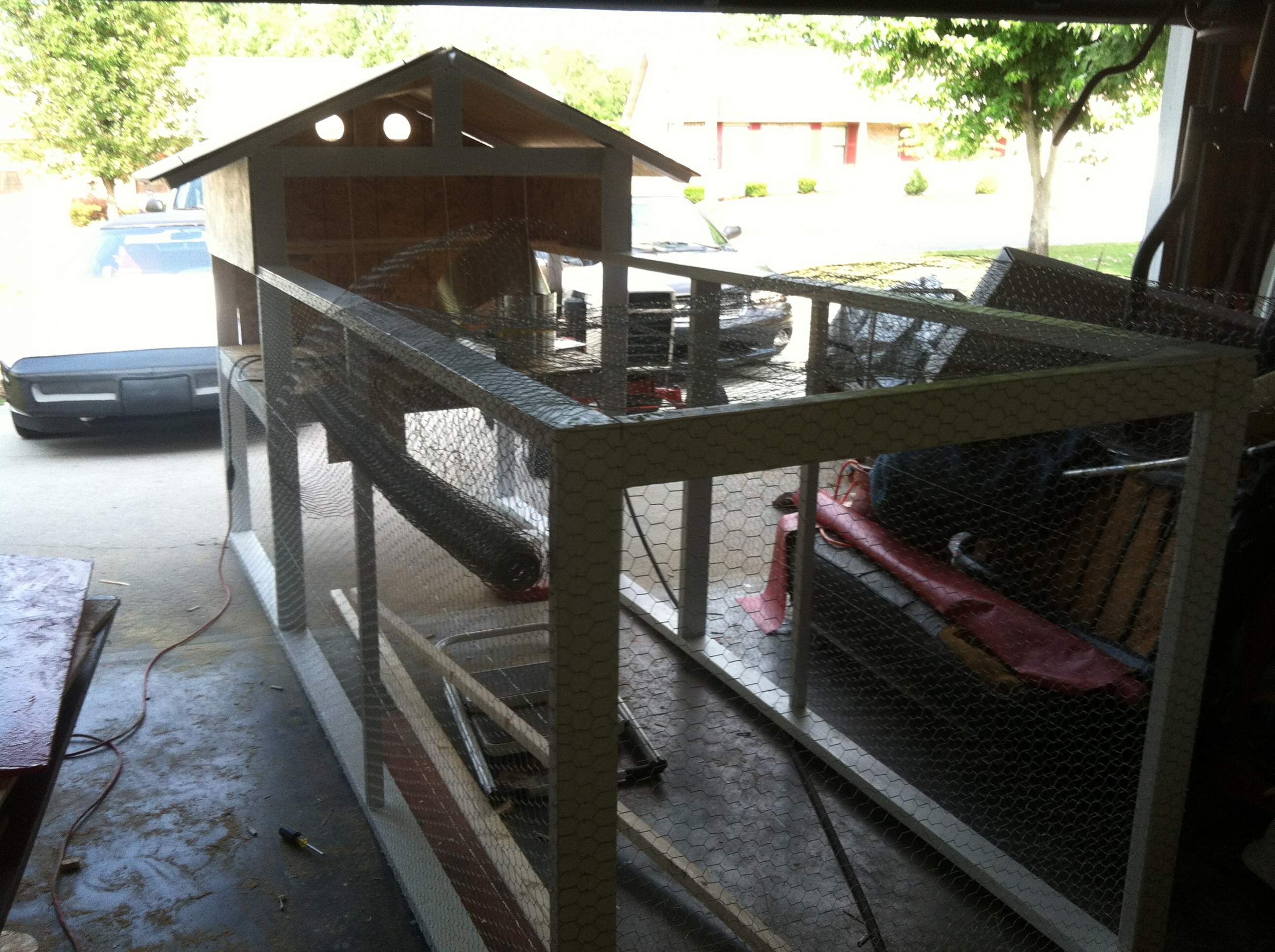

The small coop I built 4x12 we use for the house chickens works great for 10 birds ,easy to clean chickens have taken to it well and easy enough to move if need be ,outside access to laying boxes And nothing works over a compost pile better than a flock of chickens , You will find yourself naming them and you will catch yourself sitting and watching them for hours but nothing is better than that first egg ! I added an extra covered run to give them more scratching space and you can see in the winter we give them 1 heat lamp on the cold nights they did well last winter 006.jpg005.jpg

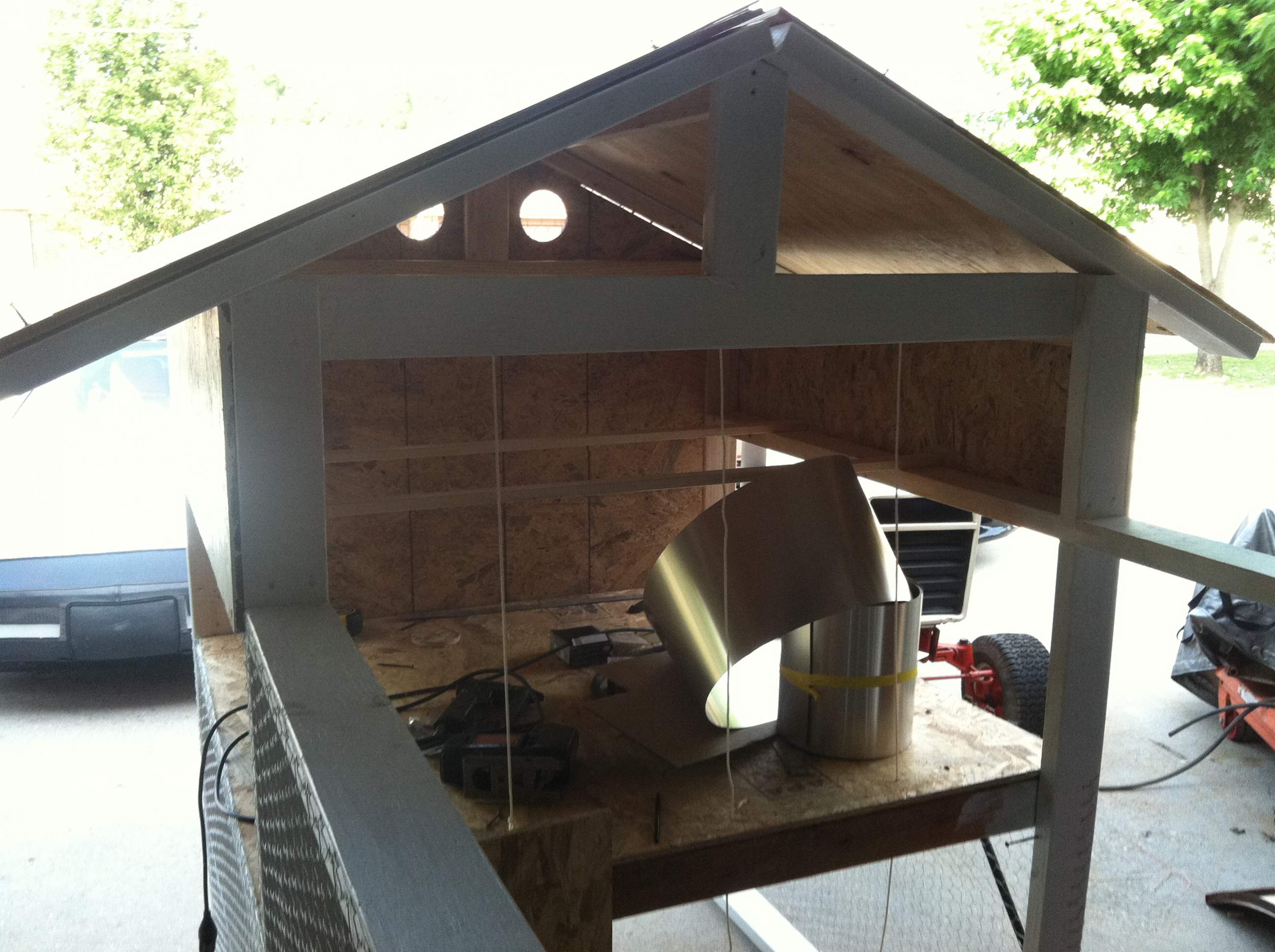

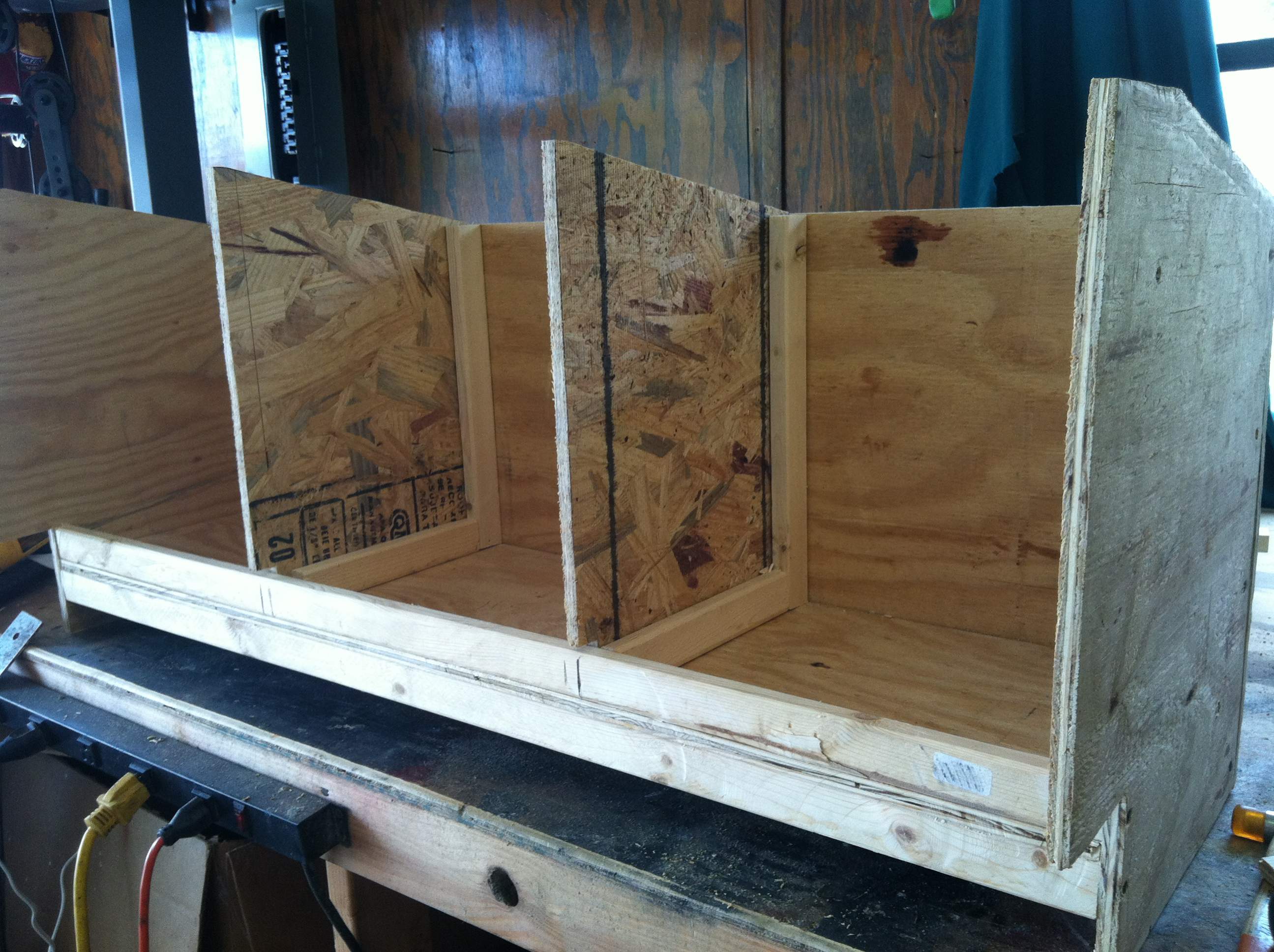

the coop is 4ft x 12 ft with a raised 4x4 hen house ,I used a plank with cross treads for them to walk up also you will want to build a small door I made a sliding door attached to a string and run thru eyelets to the outside so I could open or close it when I wanted, Chickens need good ventilation in the hen house because of the amonia from droppings can cause respiratory problems in the winter I just staple plastic over the vents to keep them out of drafts , It sounds like alot but once your set up it only takes one trip to the coop each day to feed.water and collect your eggs ,Well worth the time ! 001.jpg001.jpg002.jpg012.jpg One other thing is you don't need a nest for each bird they generally will use just one or two and the rest sit empty .the chickens will eat your garden if you let them , I throw all the garden scraps table scraps peaches/watermelon rinds and just about anything else in there and it's gone in seconds , they like meat scraps we just don't feed them chicken scraps it just doesn't seem right .

I've heard 4sq ft indoor for each bird and 10sq ft outdoors as a general rule of thumb. The more crowded, the more smell and more often you're going to have to clean it out. Also, if too crowded you'll have more fighting between the birds. I would suggest any late day/evening that you're outside, to let the chickens roam. The birds will go in on their own as it gets dark.
