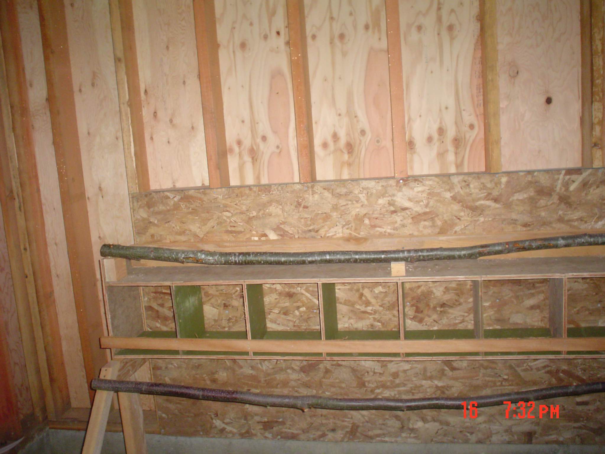

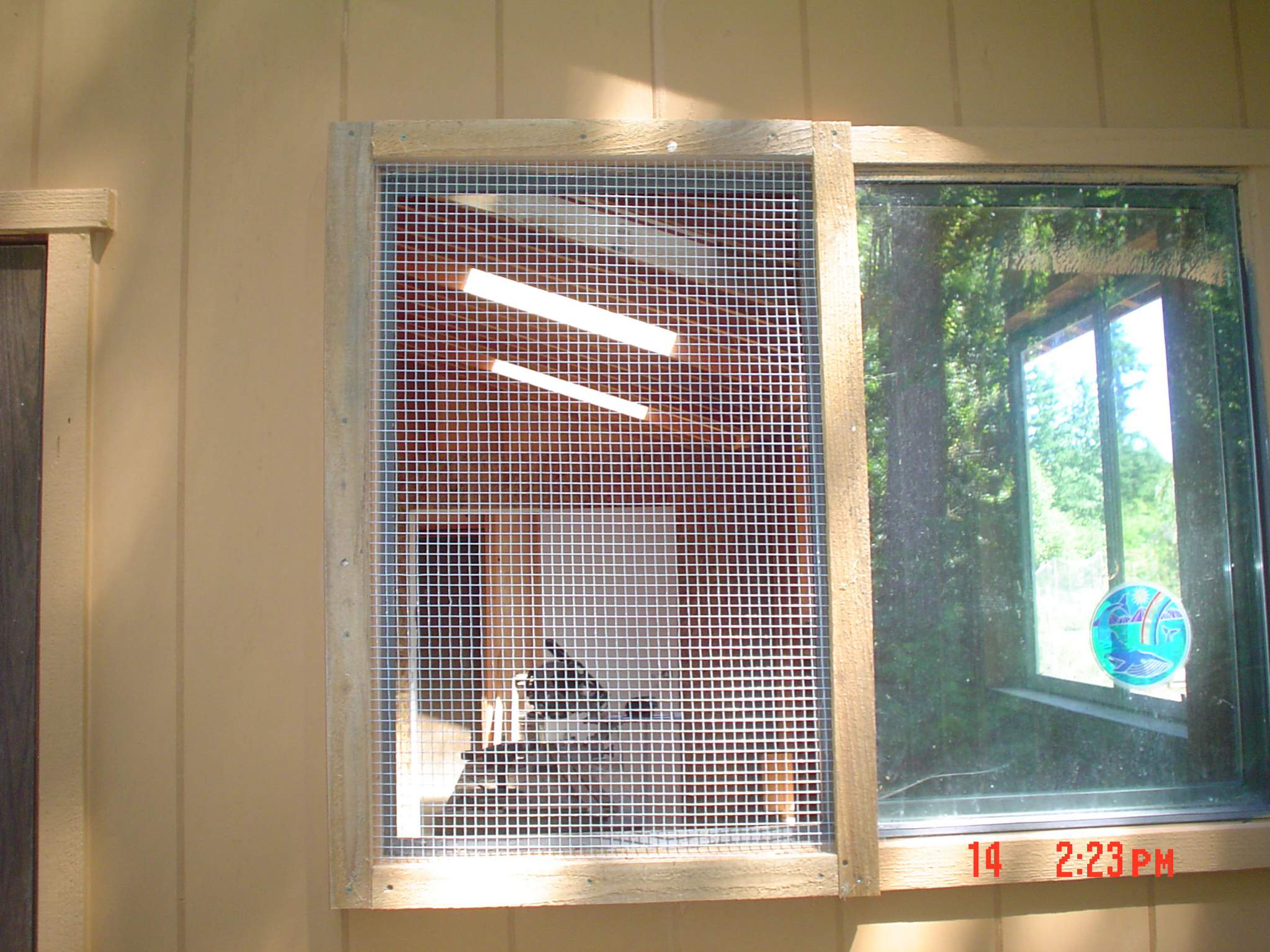

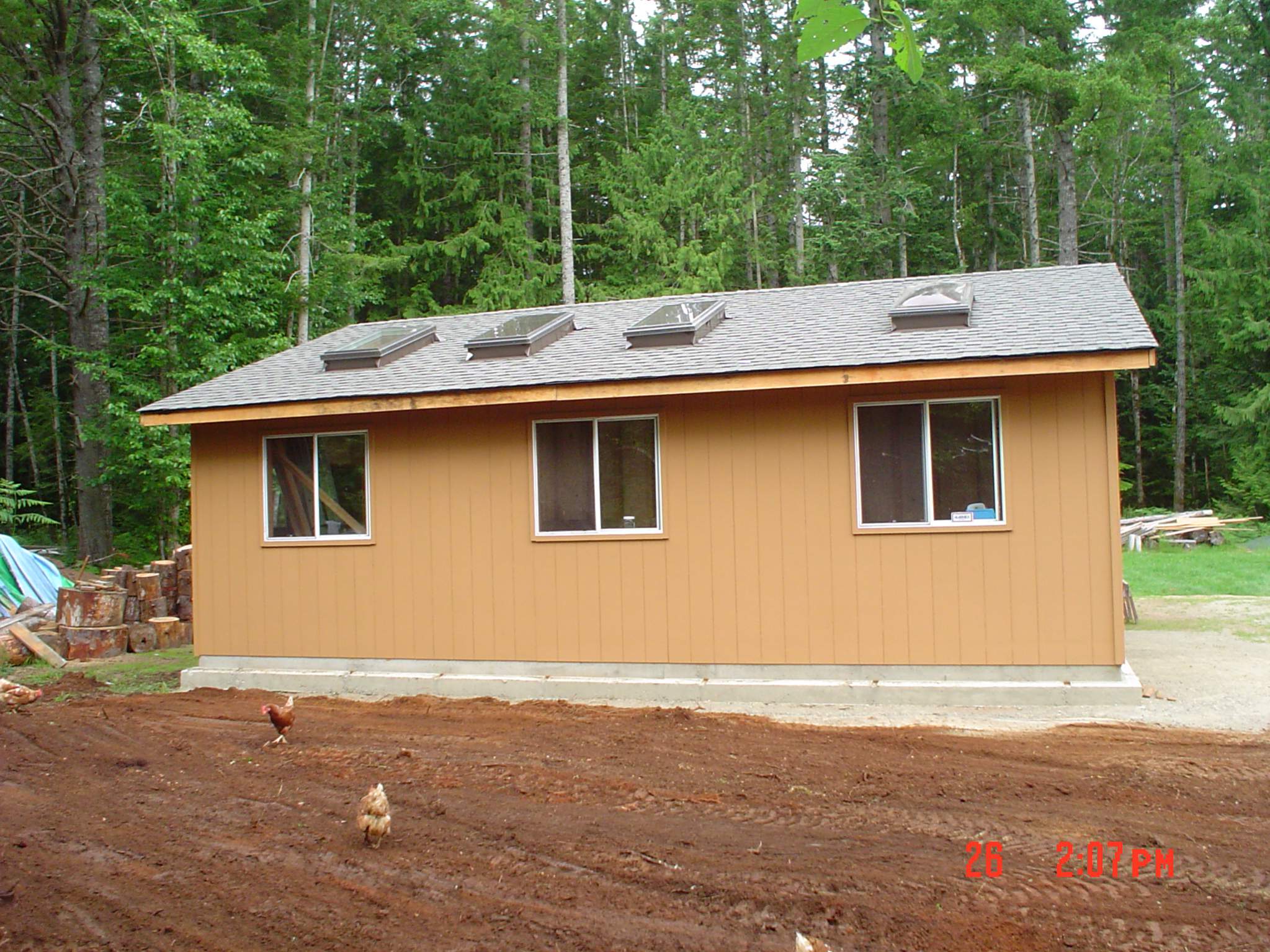

   / Chicken coop question #4
Even in winter you want to have some ventilation, usually chicken poo is damp and if you seal up the coop you will probably get mold/mildew. We lock our chickens up at night. We have mink and raccoons as well as hawks and eagles after them, given the chance. I covered all the window with wire mesh to keep them out. I did block the area between the rafters to keep all kinds of 4 legged critters out. The foundation and floor are cement. We have 85 eggs layers and 1 rooster. Hope this helps. :)
