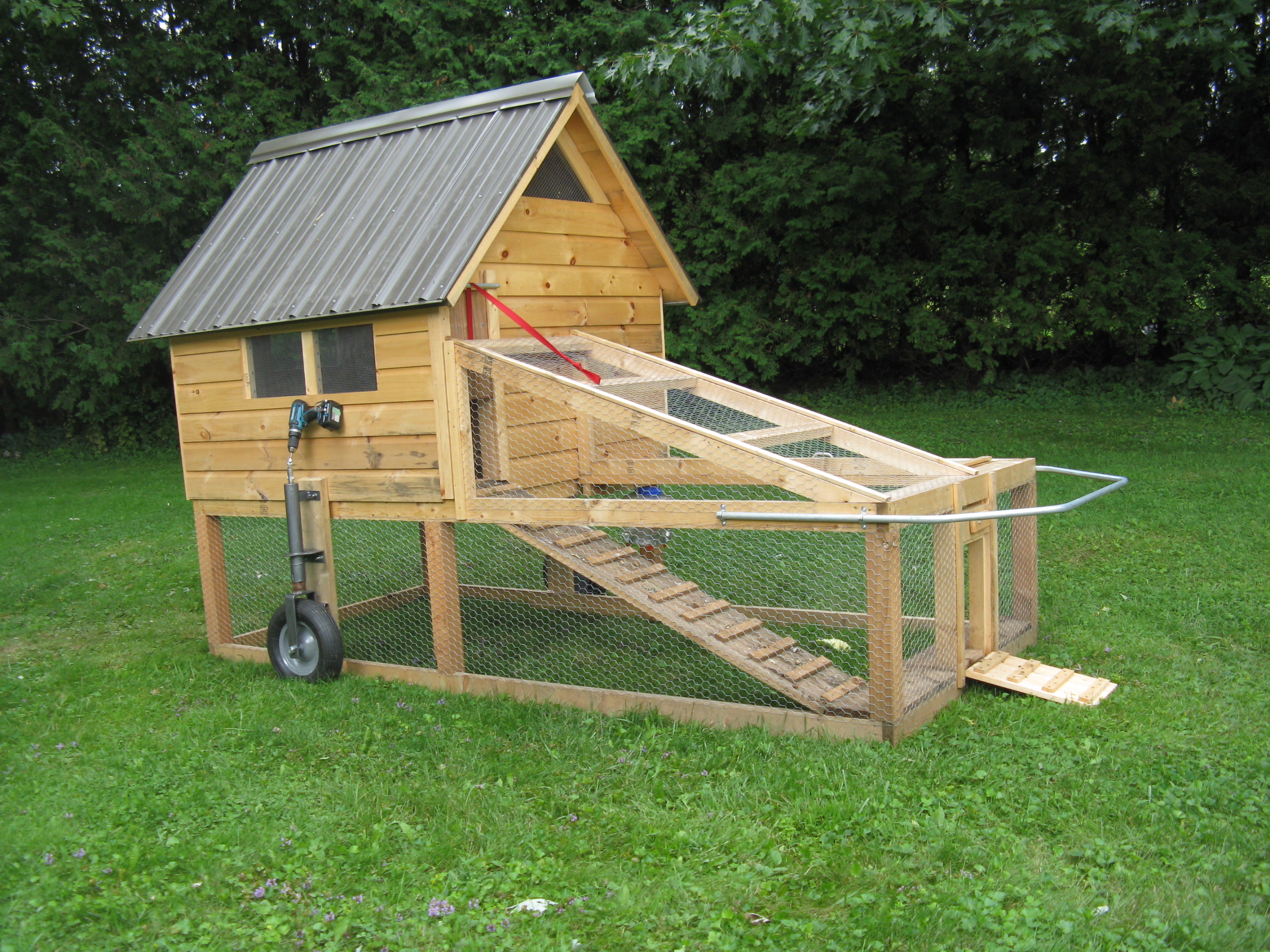

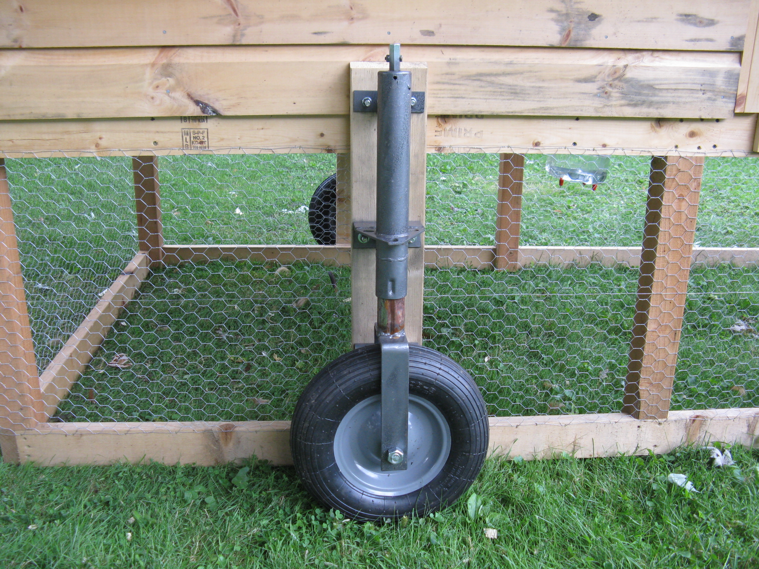

I used top wind trailer jacks - installed a coupling nut for the handle and use a 18 volt drill to jack the wheels down. Used 4.80/4.00-8 tires on 3/4'' bearings (400 LB load per tire) I can move my chicken tractor by hand on level ground but it takes two move when going up a grade. You could also use the side crank trailer jack and crank it up and down by hand.
