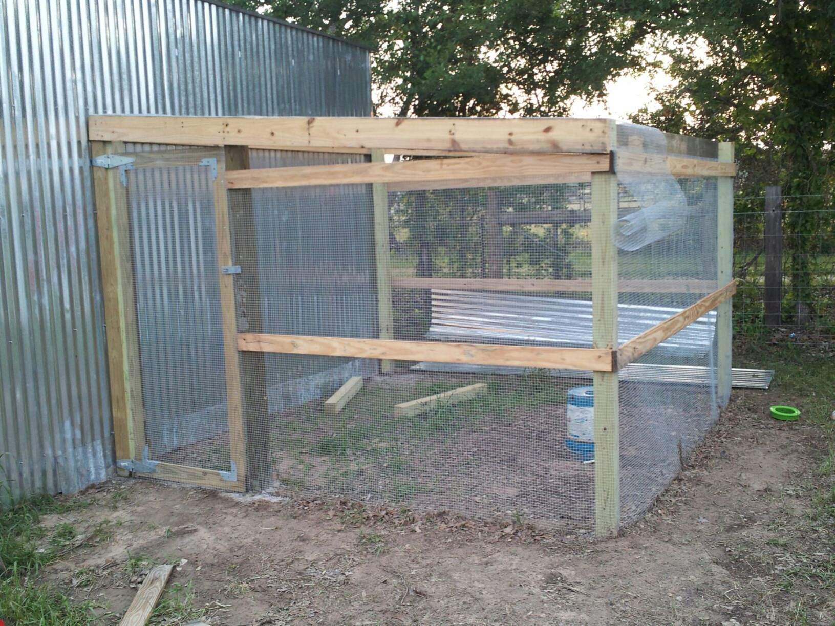

I started on mine but its taking me alittle longer than planned:D

One trick that might help moving the coop by hand is to use a handtruck to pick up the end opposite the wheels. The leverage makes it easy to lift and you have a good handle to pull with. I agree with the others that larger/wider wheels might help. A taller wheel does not have to lift the coop higher, just mount the axle higher. If you mount the wheels behind the coop, it might take less lift on the front to move it, one of those angle/geometry things.
that is a nice looking coop, not going to let my wife see it anytime soon:thumbsup:

Over the door the squirrels will get in. I have one that is the devil, I plan on getting him this summer.
Nice build, chickens are a whole lot of fun, enjoy!
My took a LOT less longer than planned. :D I figured I had a least two months to build but them chicks where growing, and ARE growing, too fast. I need to fix the gap at the top of the door so the chicks can stay outside at night. The last two nights have been too cold even if the door was fixed.
Is that 1/2 hardware cloth you are using?
Did you bury it in the ground to prevent critters from digging into the coop?
A coworker's family member just lost 40 chickens. A critter, sounded like a weasel, got into the coop through a small hole and killed all of his chickens. :eek:
