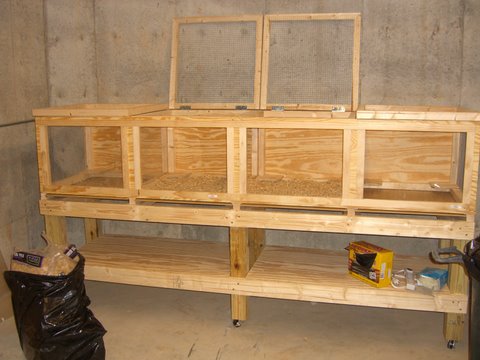

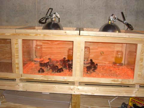

The kids could select 2 breeds from a rather impressive list of large breed or bantams. She chose 2 bantam breeds based purely on the her impression of the level of "cuteness". Each kid receives 10 chicks of each breed - so about a week and a half ago she picked up her 20 chicks - 10 Blue Silkies and 10 Black Cochins. While waiting for the chicks to arrive (and for about a week afterwards) I had the pleasure of designing and building a brooder.
My initial plan was a simple 2x2 frame enclosed with wire mesh. The "Princess" said that just wouldn't do for her babies. So here is the final product after 2 weeks of designing on the fly, head scratching and a little carpentry.
The features she wanted include (1) front windows. For this I used plexiglass. (2) several sections so the pen can be enlarged as the chicks grow. Again, I used slide in plexiglass dividers. (3) She wanted it on a "table" so she could watch the birds while standing. Base is basic 4x4 and 2x4 construction. Another feature is one my wife requested - easy clean-out of the shavings. To do this, I just made the floors of each section "slidable". Move the chicks into one compartment, place an appropriate receptacle on the shelf underneath the compartment and pull the floor toward you. Most shavings will fall into the trash bin below. About the only thing in this brooder that was included in my original plan is the 2x2 framing for the carcass.
It was a fun project that cost way more than I had hoped. But, I was able to justify the purchase of a pneumatic air trim nailer and a few more clamps for myself.
Once the fair is over and the kids get their ribbons or trophies, the 4-H folks sponsor a chicken sale. Here the kids can bring as many of their chickens as they like and sell them to interested buyers. Kids get to keep 100% of their proceeds. Then, next Spring, they get to start over with 20 new chicks.
Another thing that has come from this - Eddie, this is where you come in - is that my 16 year old son now wants to get in on the poultry action and wants to get some turkeys. I told him that the only way we will get turkeys is if we get wild turkey chicks to release once they are old enough. Nothing long term. He's fine with this plan so we will be ordering 6 wild turkey chicks soon. I'm reserving one section of the brooder for the turkeys.
3 pics are attached, empty brooder, brooder with chicks and one of chick in daughter's hand.
