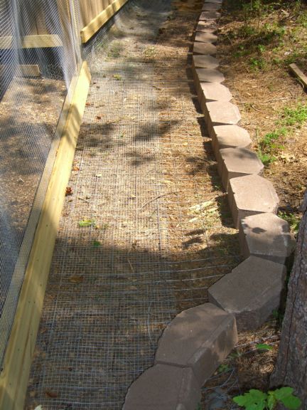

For predator and critter-proffing, I placed 24" wide 1/2" mesh (for small critters) and 48" wide 2"x4" mesh (for larger predators) along the bottom rail and laid it out flat along the ground. I was going to bury it, but I recalled someone stating that laying it on the ground would prevent dogd and coyetes from digging under the fence - so that is what I did. I did the same thing around the coop.
I thought I needed to place some weight on the free edge of the fencing, so I just used these retaining wall blocks for that. At about 25 lbs each, I hope they will be heavy enough collectively to keep things in place. As I see it, any attemps by a predator to dig will occur at the base of the pen - not 4 ft away.
To pretty thing up, we placed some landscaping fabric and mulch over the mesh.
We decided to place mulch between the

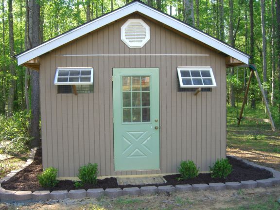

I had some brick laying around, so I made a little front step. My wife planted some boxwoods in the front for a little decoration.
Laziness got the best of me, so I never finished the soffits or added trim around the windows and doors. The windows are still just propped open with scrap lumber and I haven't cut the opening for the chicken door yet. I think the chicken door will happen tomorrow, along with tying up a few other loose ends.
Egg production has been neglible - don't know what the problem is. We have seen several eggs in the bottom of the roosting box (broken from the long drop and covered with poop for obvious reasons). But, with 16 hens, I expected to be getting many more than we would eat.
Hope everyone is doing well with their chicks. My wife now wants guineas for bug control - Yikes!!! more birds.

BMAC that a pretty nice coop! Can you tell me how you made the windows tilt out? Maybe a picture of the window from inside the coop will tell the story. We're getting ready to build upwards from the foundation that was laid last Fall and we're collecting ideas before we start pounding nails.

Nice looking run, is it covered over the top too?
I just used piano hinges across the top of each window and screwed it into the siding. I'm a very simple person - nothing really ingenious about it.
Have fun with the build.
