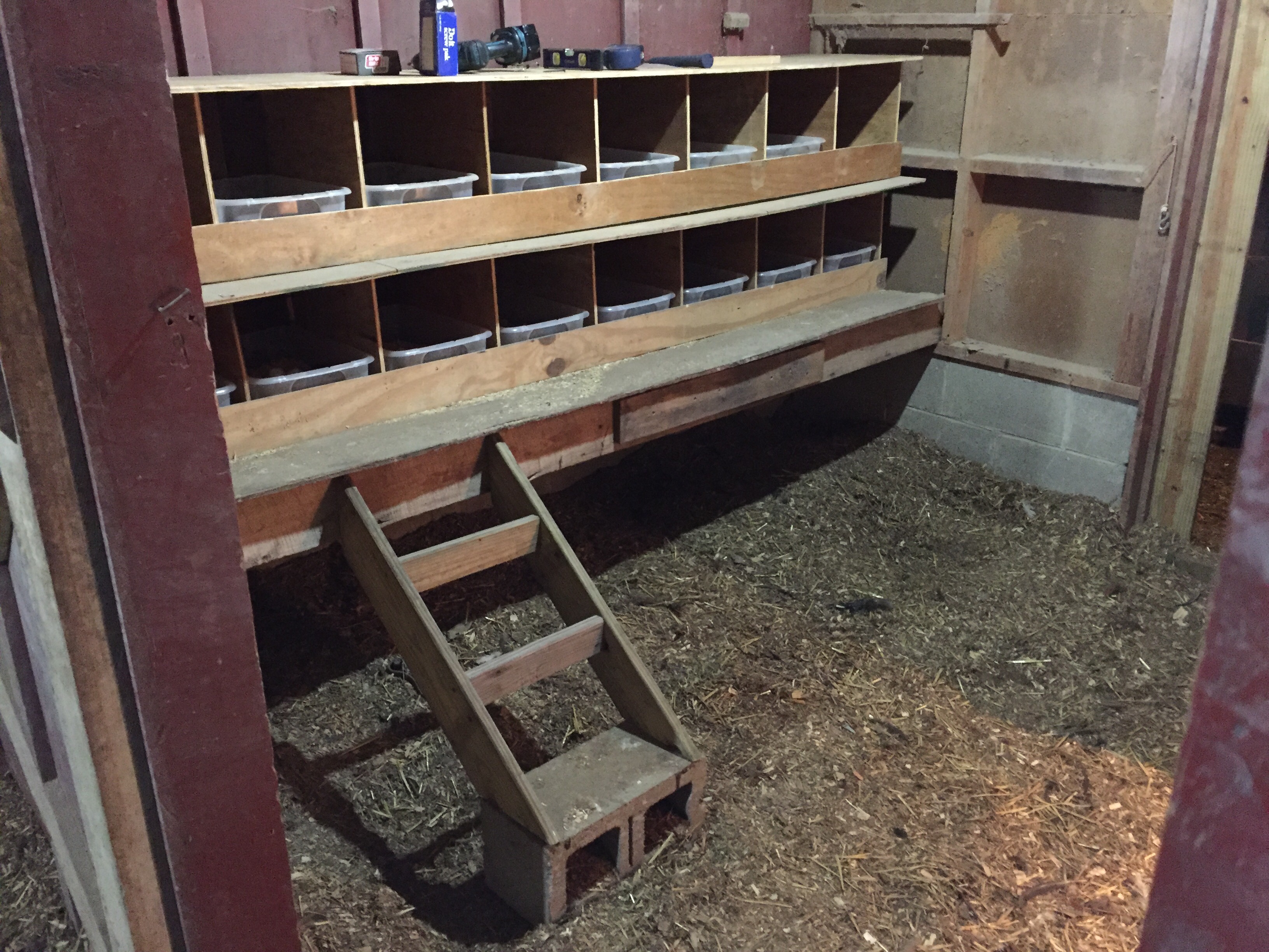

Thinking about getting some chickens for eggs. Is it better/ cheaper to build the laying boxes, or buy them ?
Probably get about 6-10 chickens...Do I need one laying box for each chicken ?

View attachment 514338View attachment 514339View attachment 514340

I like your idea better. I can buy those plastic totes at wally world .
I see you built steps to the 1st row of boxes.. Do you have to build steps to the laying boxes, or will they fly up to the boxes ? The boxes at TSC have a perch on them

The steps make it easier for them to get up in a smaller area.

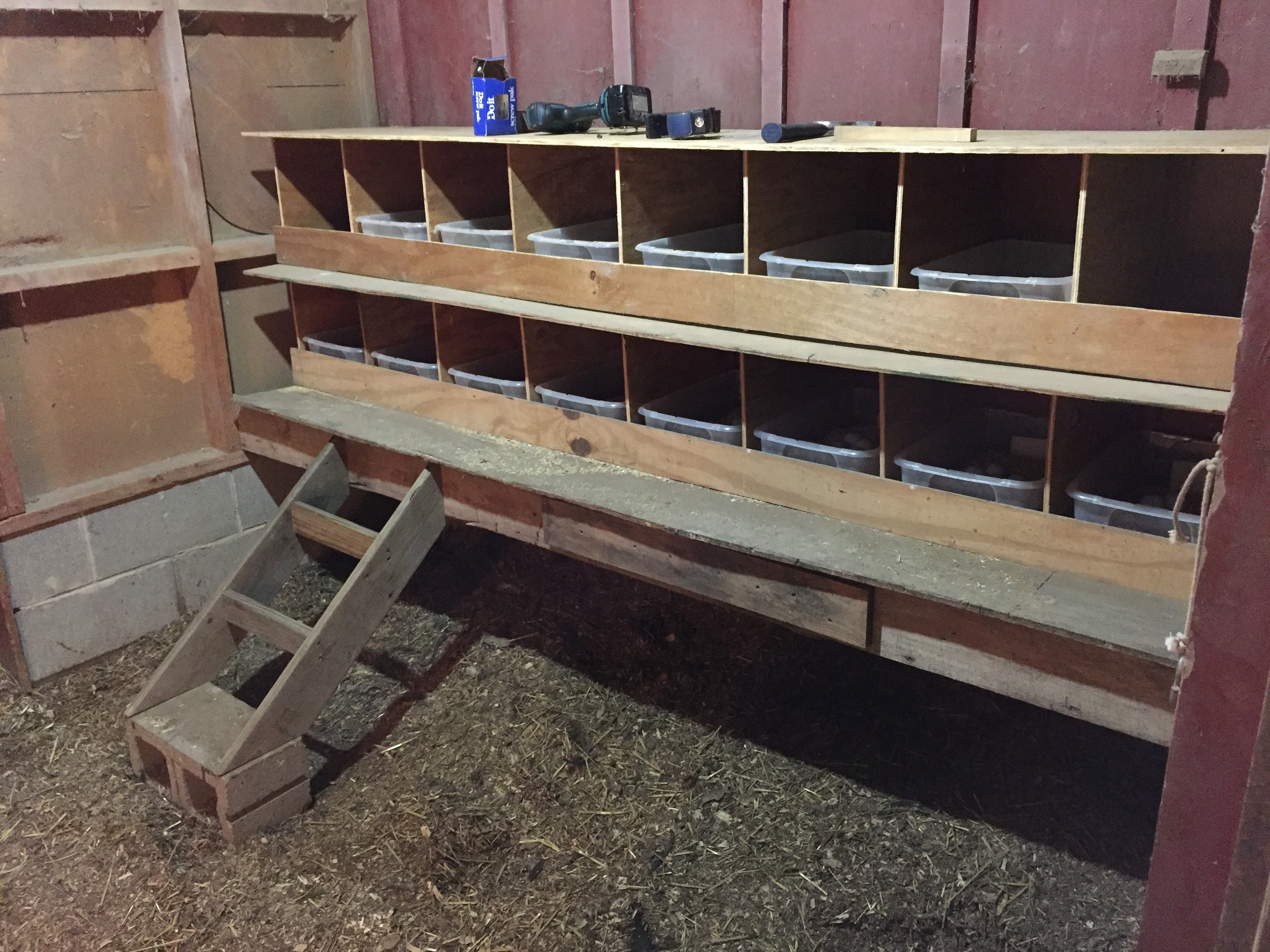

To answer your questions from earlier, that's what I did was buy plastic containers from Walmart, you want around a 12x12 inch box, mine ended up being 11x14in boxes due to the plastic totes but the hens used them just fine.

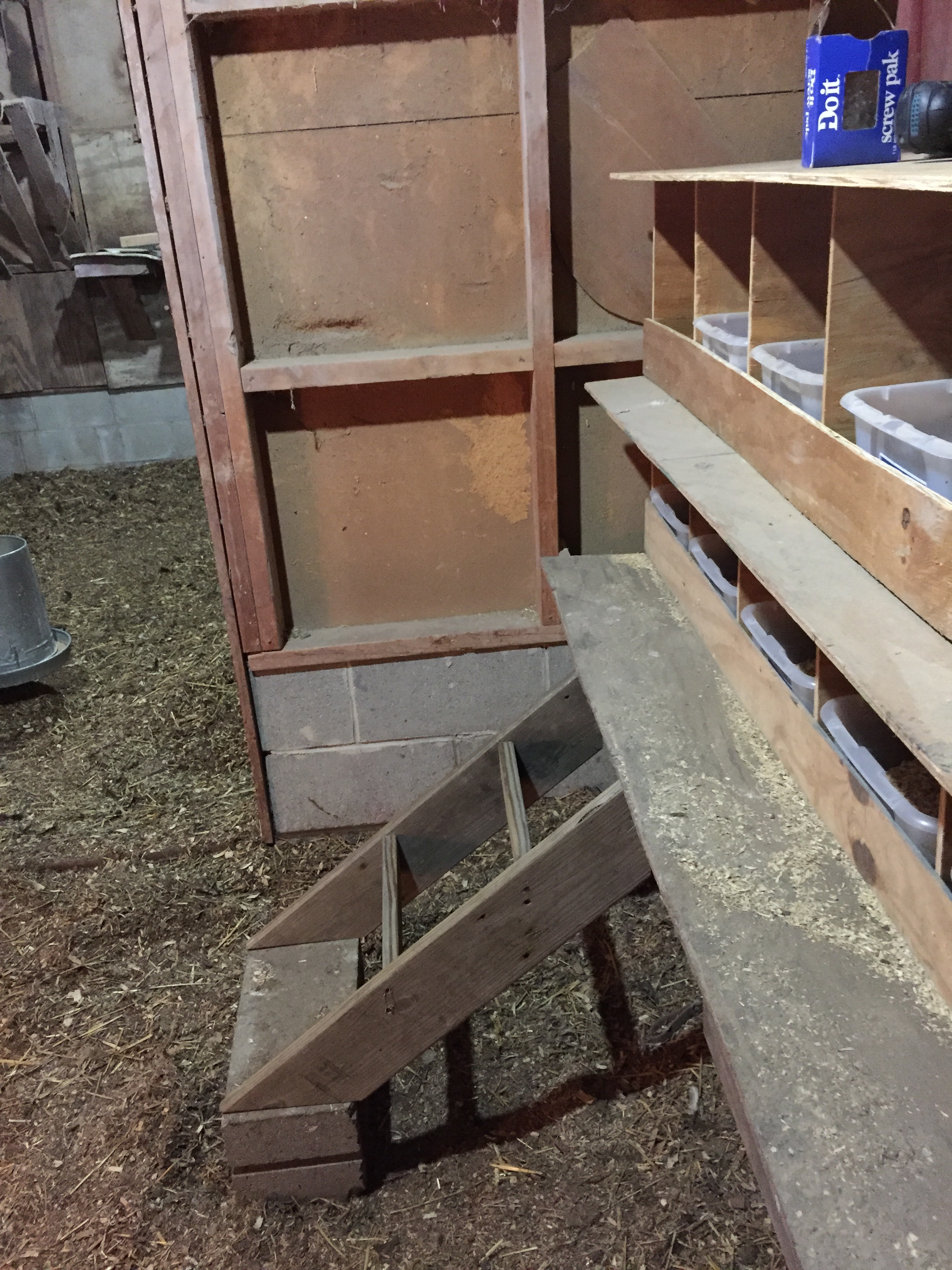

I originally didn't have the mini ladder but I was getting a crazy amount of eggs on the ground and little in the boxes so I built a mini ladder which solved that prob, it was about a 3ft hop which they weren't a fan of making.
That platform I built my boxes on was already in that room, it was a shelf higher up so I moved it lower, in order for it to work it had to be above the block, that's the only reason my boxes are that high, you can have them almost on the ground if you want, only downside to that is the varmints like skunks that suck eggs down low, I have not purposely pushed a few out of my coop late at night lol.
