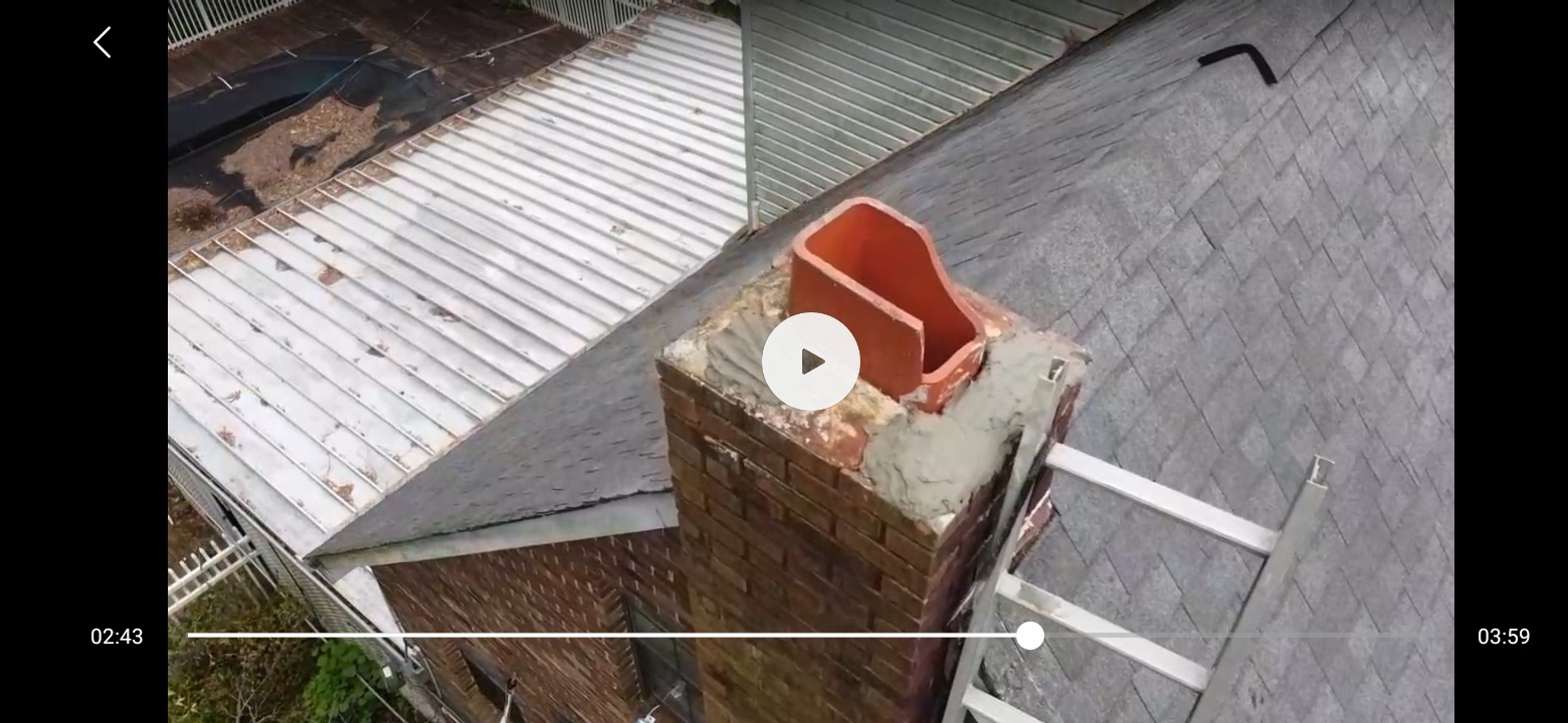

Assuming only one tile is broken, I vote man lift rental, replace the bad tile, and mortar in it.

Perhaps many responders did not read:
So I was thinking for a quick easy patch I'd put some hardware cloth down then spray a crown patch using some "Great Stuff" foam insulation to seal it up and prevent water and squirrels entering.
I'm pretty sure that could have been accomplished with 1 trip up the ladder carrying foam, hardware cloth, tin snips, wipes. All very lightweight.
So I made it in two trips with concrete patch.
Not the best job but it should hold for a couple of years. And I had already started the long painful process of getting a reliable roofing contractor that will let me monitor his work w/ a drone.
