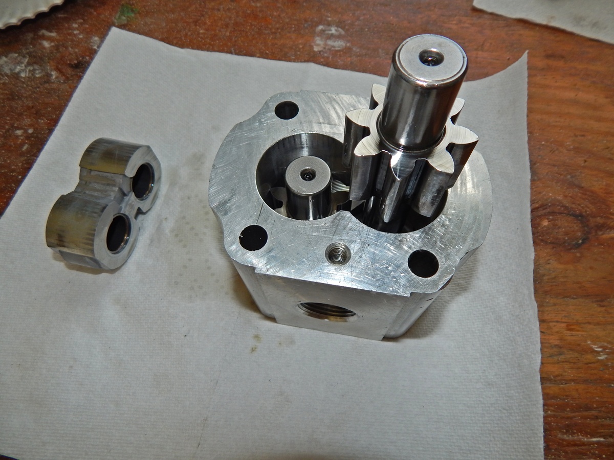

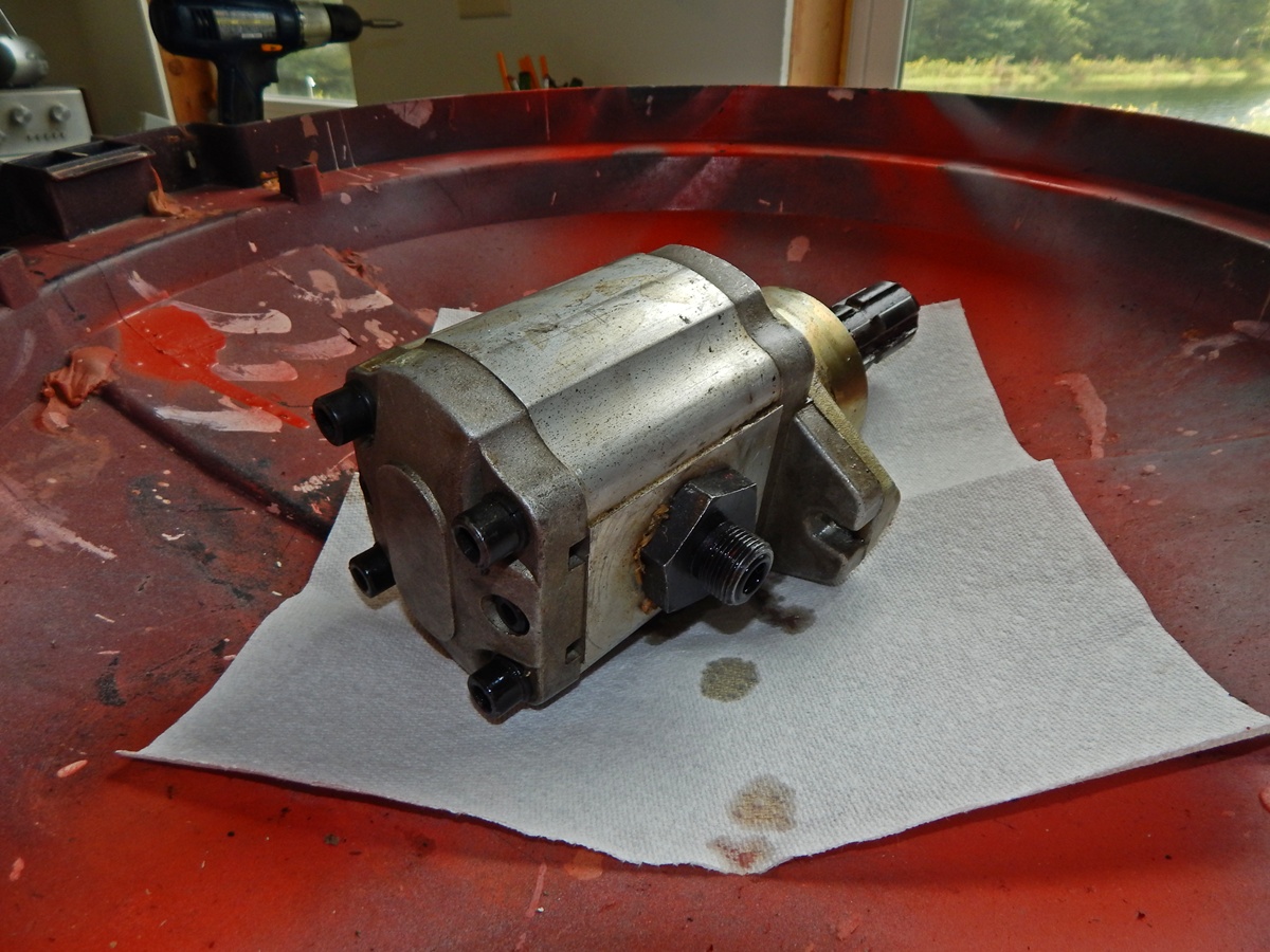

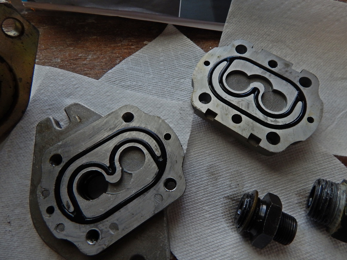

I removed the pump, disassembled on the bench, and inspected. This is my first exposure to the guts of a hydraulic pump, but it was pretty obvious to me that this would be categorized as a gear pump. I did find the Mfgr stamp on the pump exterior. It listed 20Mpa (I convert to 2900 PSI). The pump model is: CBF-F425. There are 2 one-piece rubber gaskets; one at each end of pump body. They were in very good condition. The machining on the plate sealing surfaces was good, but a bit scuffed. No gouging, just light marring. IMO, no issue for sealing against the rubber gaskets. The fits were all good; no slop. In summary, I could find nothing wrong. I cleaned, lubricated, and re-assembled and re-installed.

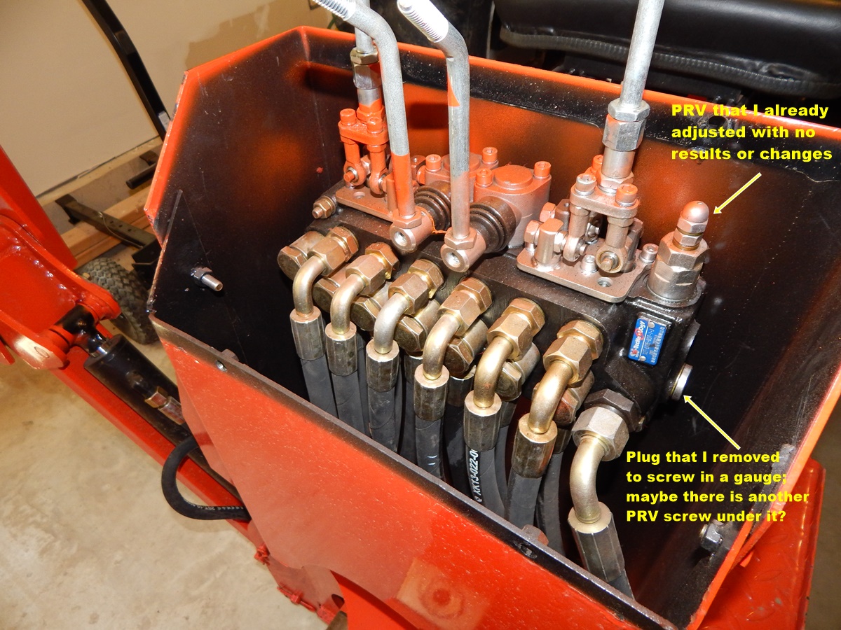

Well, that is VERY interesting. Thank you for sharing that story. When you say "the 2nd one was behind a hose fitting", can you be a bit more specific? I have a threaded plug that covers a hole directly below the obvious pressure relief valve. In fact, I removed that plug to screw in a pressure gauge to see what the pressure was at the controller block. Is it possible that there is an adjustment screw beneath that plug? Is that the type of fitting you encountered with your brother's issue? It is a flat plug, about the size of a quarter, with a hex drive hole in the center.

Dang. I am going to pull that plug again anyway to see if there is something hiding underneath. I also sent an email to my factory contact, asking her to reach out to the controller mfgr to ask about any/all PRV adjustment screws.
I do have a gauge and ran two tests. I put the gauge right on that plug on the block and got about 1100 PSI max. Then I moved the gauge to the end of the dipper hose and got about 1200 PSI max. I also followed that feed hose. It runs directly from the pump output side to the controller block inlet (the hose with the 90 degree bent tube on the far right in the pic above). That is why I am suspicious of that plug. It is located directly in line with that inlet feed hose and also directly below the obvious PRV.
