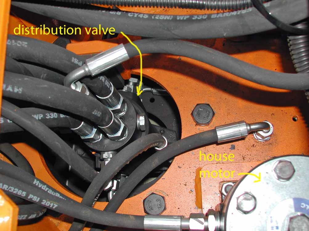

Just a quick question if anyone knows. Which direction does the top line on the slew motor actuate on these one ton units? Is it left or right. I've installed a crossover pressure reducing hydraulic valve and have noted that the right swing does not cushion like the left. Without taking guesses as to which valve to adjust, I'm wondering if you folks know which line (upper or lower) actuates the right swing of the slew motor. I'm trying to prevent the slew motor or gear from blowing up with sudden stops. Thanks
Does yours look like this?
I can't tell you since I have not installed my crossover RV yet. I suppose you can trace the hoses, but it is not obvious on the main valve stack which is right or left.
Note that the Summit valve comes pre-set really low (1300-1500psi). You might try backing one adjuster down super low, and seeing which direction is affected.
Good you are doing this. How many hours on your machine, and what kind of ring/pinion gear slop do you have?
