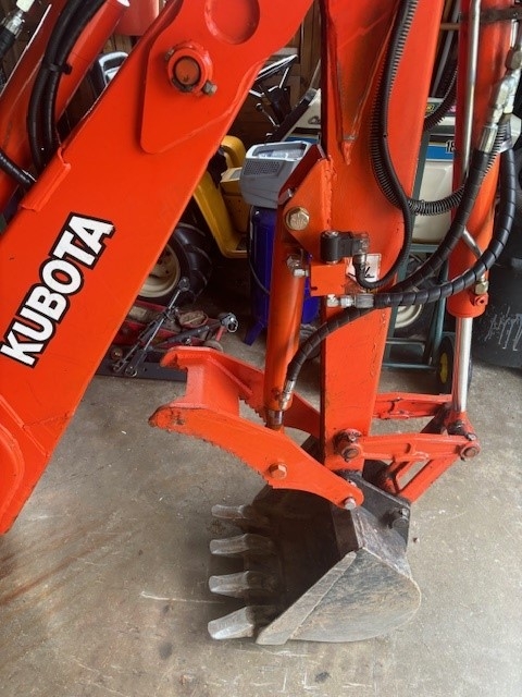

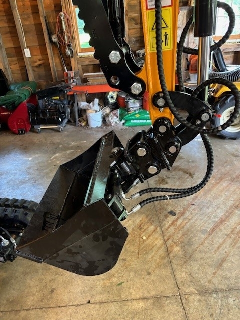

Dunno if you said earlier: have you tried to fit your B21 bucket on the mini-X? Pin sizes are also 25mm, as I recall. I don't recall the dipper stick width.
DF on the B21 its very close - 3.65" width vs 3.6" on the mini, but the pins are 6" on center vs 4" on center on the mini. I only have the 16" BH bucket and the ripper tooth for the B21. Then I installed the Hyd thumb last spring on the B21 making it more work to change.
But I plan to use the ripper tooth on the mini - just can't use the quick attach on the mini - need to pin it on as the 6" on center should be OK on the mini.
I see your thumb shares the bucket pin on the B21. That makes it tougher to change buckets.
For what it is worth, changing buckets or my ripper tooth on my XN08 is super-easy, even without a QA. Much easier than any of my many backhoe attachments. The ripper tooth is awesome.
