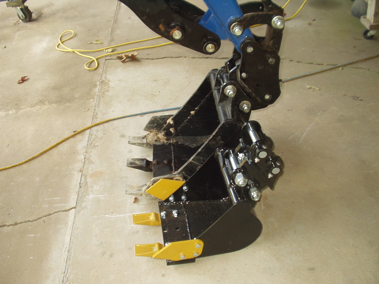

I'm late to catching up to this thread again, but I wanted to reinforce what MattB4 said about pin configuration in #259. I bought a MiniX in January and also, separately, bought a BUNCH of attachments as I was concerned about what was coming with tariffs. Unfortunately, my wife had some medical issues which kept us busy for several months so I only tried and used a couple of the attachments. This week I tried to mount the 600mm tilt bucket on the machine and the pin would not clear the locking lug on the spring loaded quick attachment. After some cussing and messing around I measured the pin centers and found the bucket was about 84mm, while the QA was 89mm, consistent with the rest of the implements I have.
Bit of a hack but some of the bolt style quick connect hitches have the correct 90mm CTC spacing for the spring loaded quick hitch to grab. Because they tighten with bolt and rising C hook you can fit the smaller CTC of an attachment. Recently the bolt style have been all over Ebay in the $70 range.

In response to Matt's comment; thats a thought on using the bolt style QC (of which I actually have one). I also thought of cutting the ears and base off of a cheap ripper that has the correct spacing and replacing the ones on the tilt bucket with some cutting and welding. In the meantime, I'm trying to see if the seller will send me a pivot assy. with the correct ears to replace the one that is "wrong". I'm not optimistic I will be successful.
