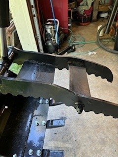

Yes the Hightop / Terror units thumb is a weak link - I added 2 3x5" 3/8" steel gussets
