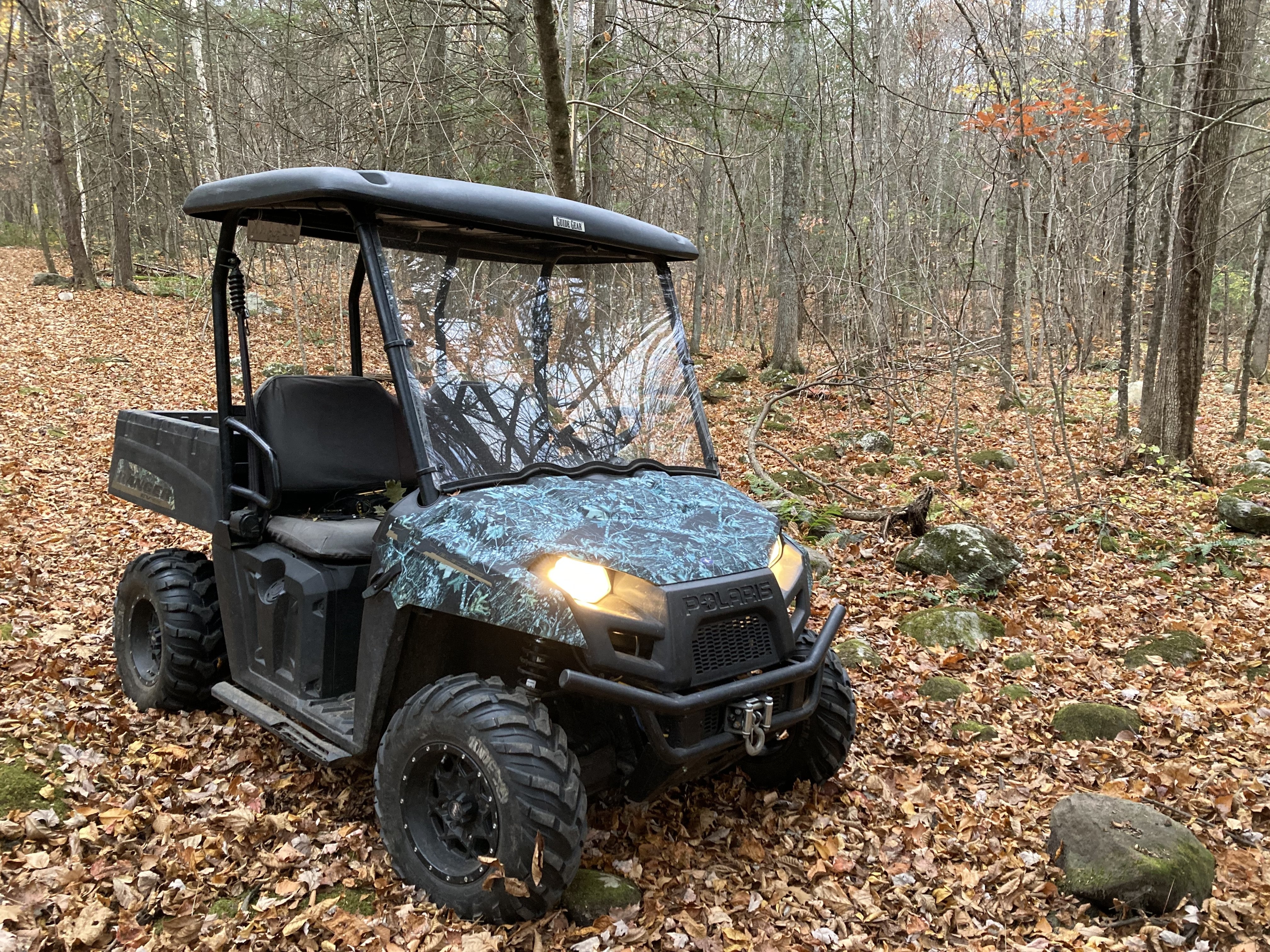

A off road golf cart would be a better buy. Polaris and a few independents are building real EV UTVs, they are pricy but sneaky silent.
The golf carts are NOT for 4 wheeling, only sneaking around on flat ground! BTDT!
