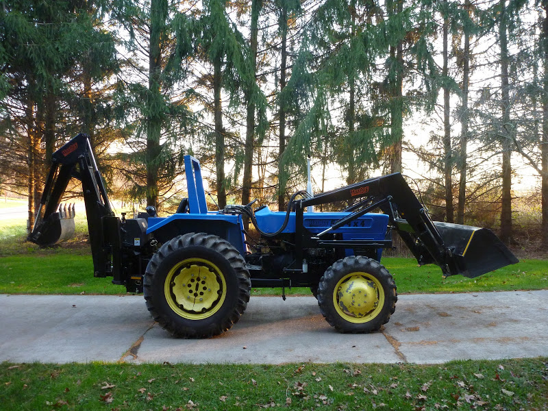

The Jiangsu 504 is more or less the same as the other Chinese model 504s. Photo:
This one was rebadged and sold by Hardy Diesel (I think they just do Chinese generators now) in 2000 or 2001. I'm the second owner. It's a decent tractor. Those are a Kelley FEL and backhoe (DL3000 and B851, respectively) on it.
