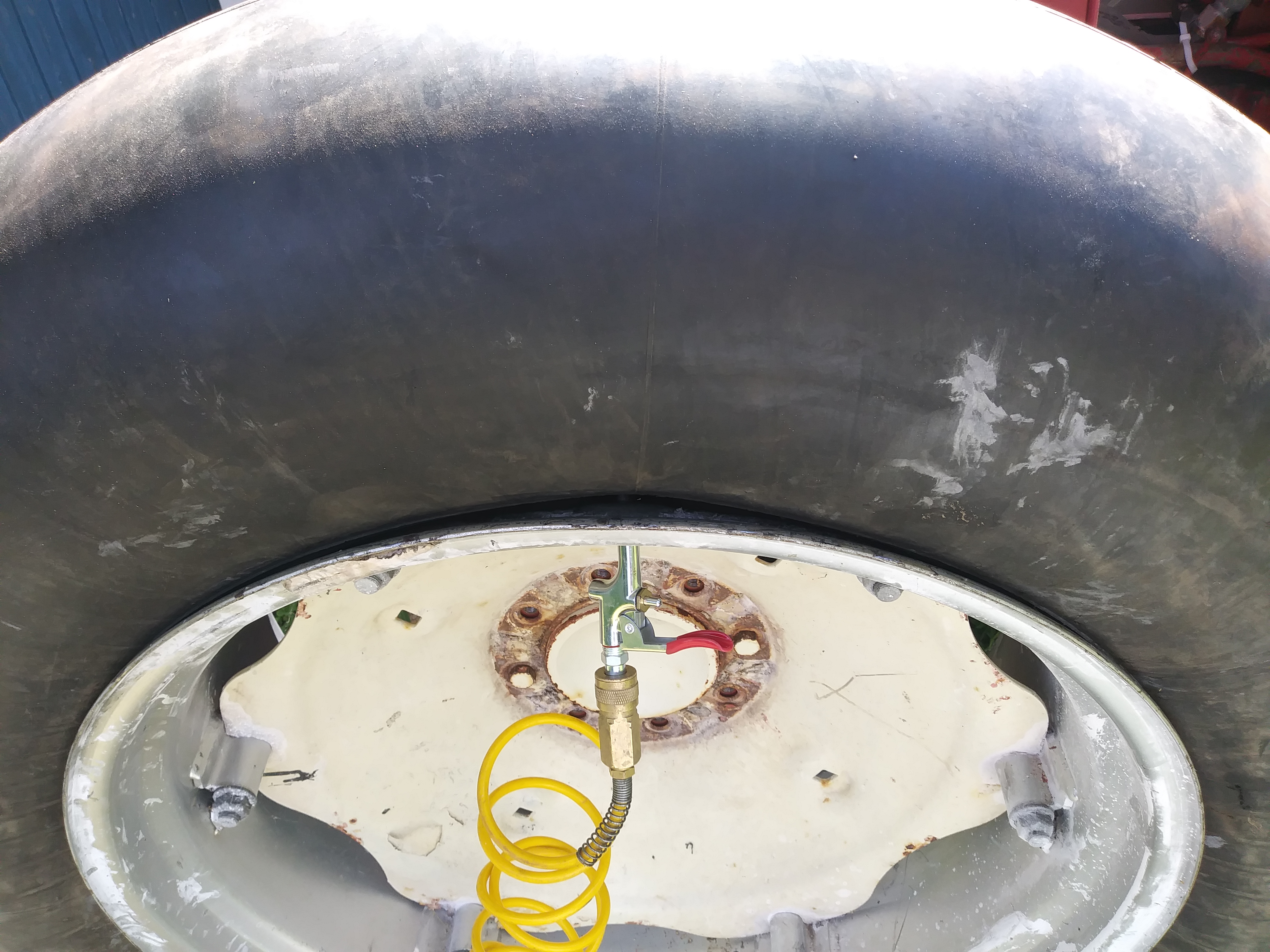

Issue is, the stems get ripped off before we even drive the tractor. Now, I do think it is possible the tires can spin on the rims because there was so much rust on the beads from the calcium loading I may have taken too much rubber off with a wire wheel, but as said, the stems rip off before I get a chance to fire up the tractor and drive it.
I did some tests today. Pulled the tire off the rim, put an old tube on and filled it with air the best I could as it has a torn off valve stem. Now, the tube off center quite a bit, just wondering when the tire is on, is the tire bead yanking the tube away from the hole in the rim and tearing the stem?
The valve stem hole in the tube lines up fine with the hole in the rim:

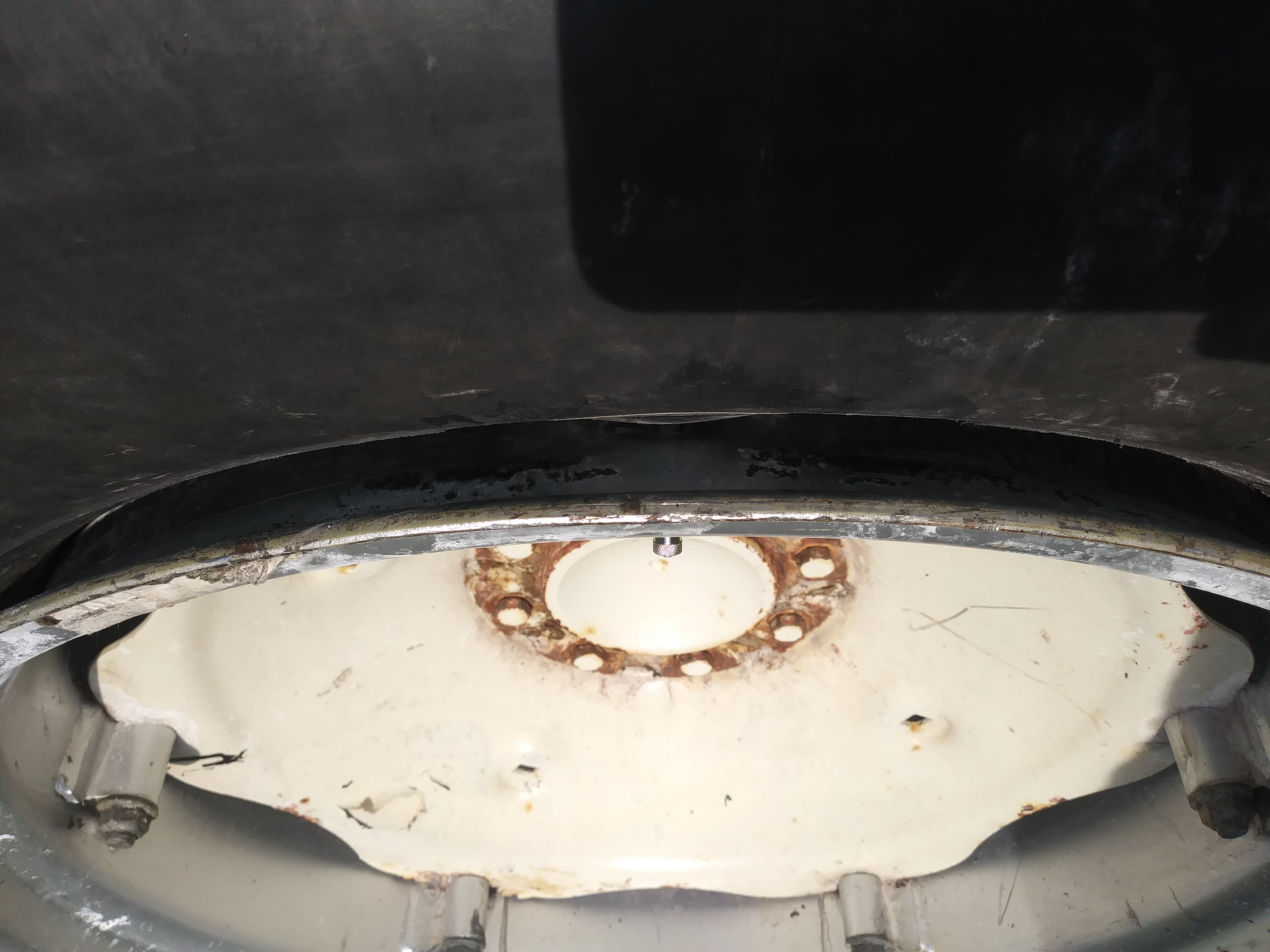

I finally got around to replacing the valve stem on the tube that was in this tire, I see no issues with the hole location in the rim, looks to me like there is plenty of room for the tire bead.

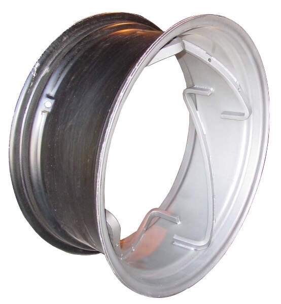

Your rim has no serrations. The bead surface on an ag wheel should be serrated to keep the tire from slipping on the wheel under tractive force. If the picture I tried attaching shows, you can see the serrations intended to prevent wheel slip. Some tractor pullers even run screws through the rims into the tires to prevent slippage. Slipping tires will quickly rip a tube stem.

OK, a couple of thoughts;
as has been mentioned there are no serrations on the rim to hold the tire and prevent rim to tire slippage under use.
However as the stems are getting pulled off prior to moving that lets that off the hook for now.
Looking at your pictures I see two things;
one the valve stem hole is very square and sharp, maybe dress that with a file a bit.

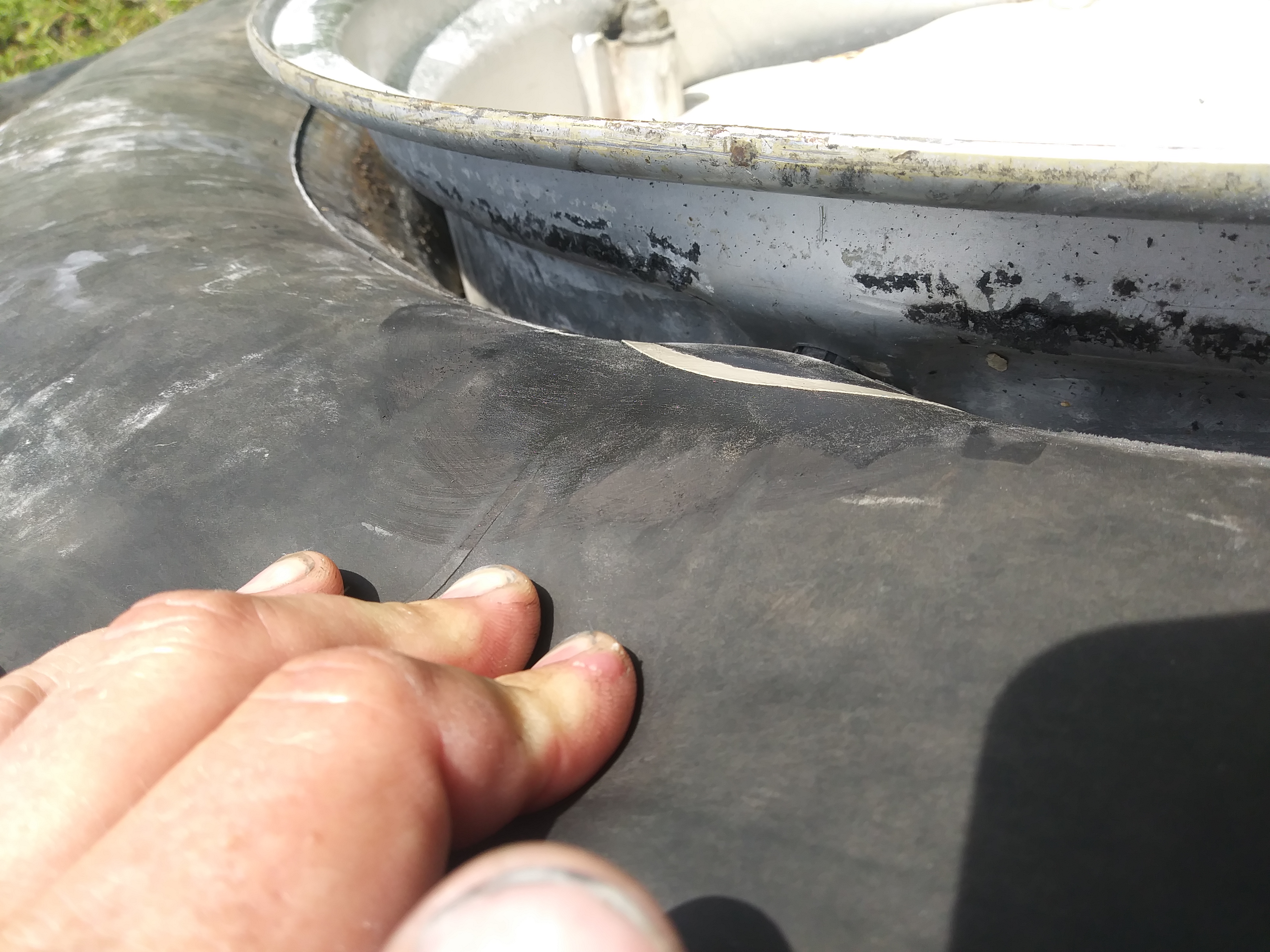

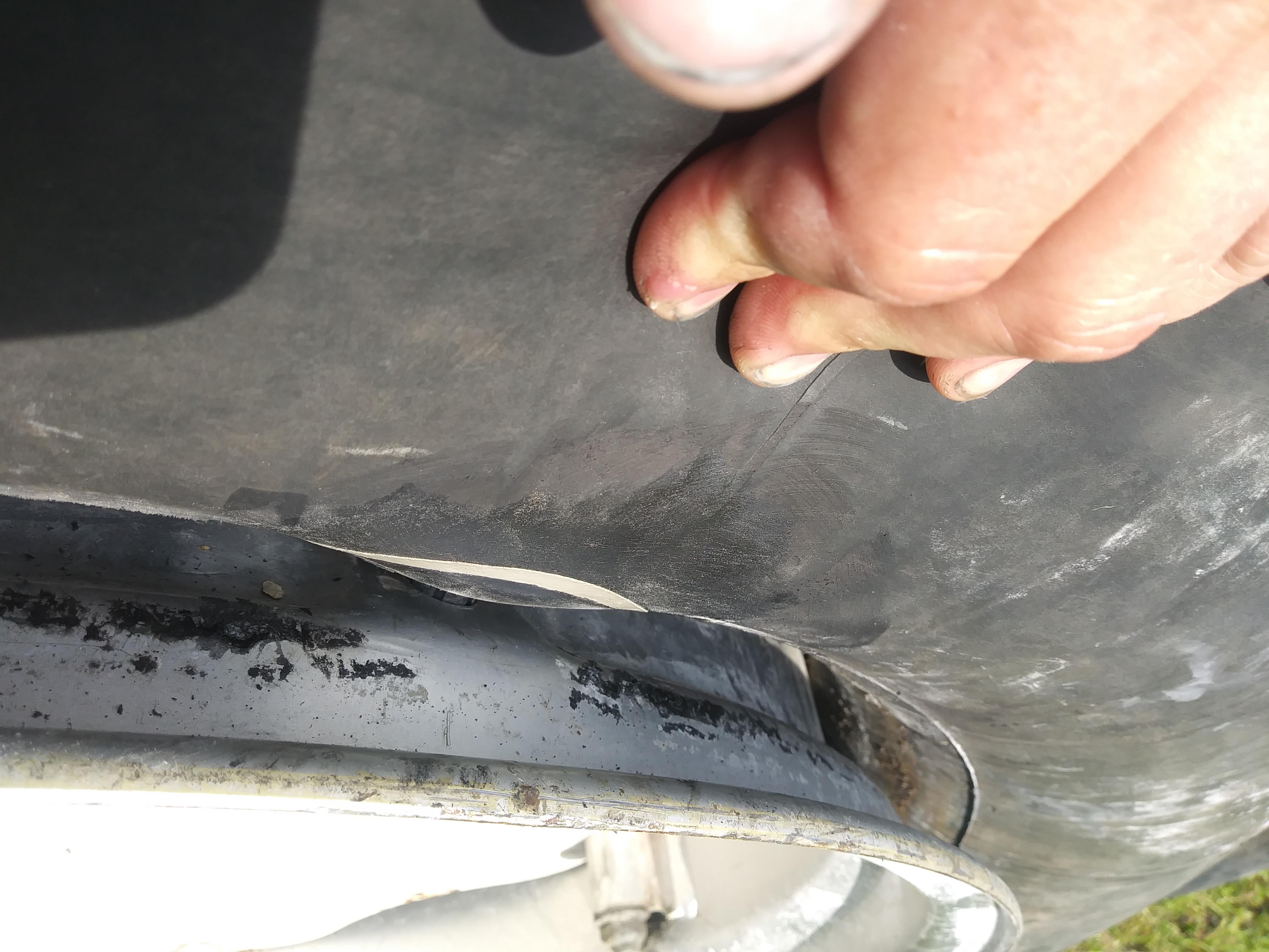

Also, when you had the tube lightly inflated on the rim it had a small pucker on valve stem side of the tube like it was being pulled,
also the tube is not centering in the rim.
If this continues to create issues I would patch the existing valve stem hole and moving several inch away add another hole in the
tube a couple of inches further up on the tube so it will center more evenly on the rim.
Good luck,
P.S. some bead sealer applied may help prevent rim slippage.
