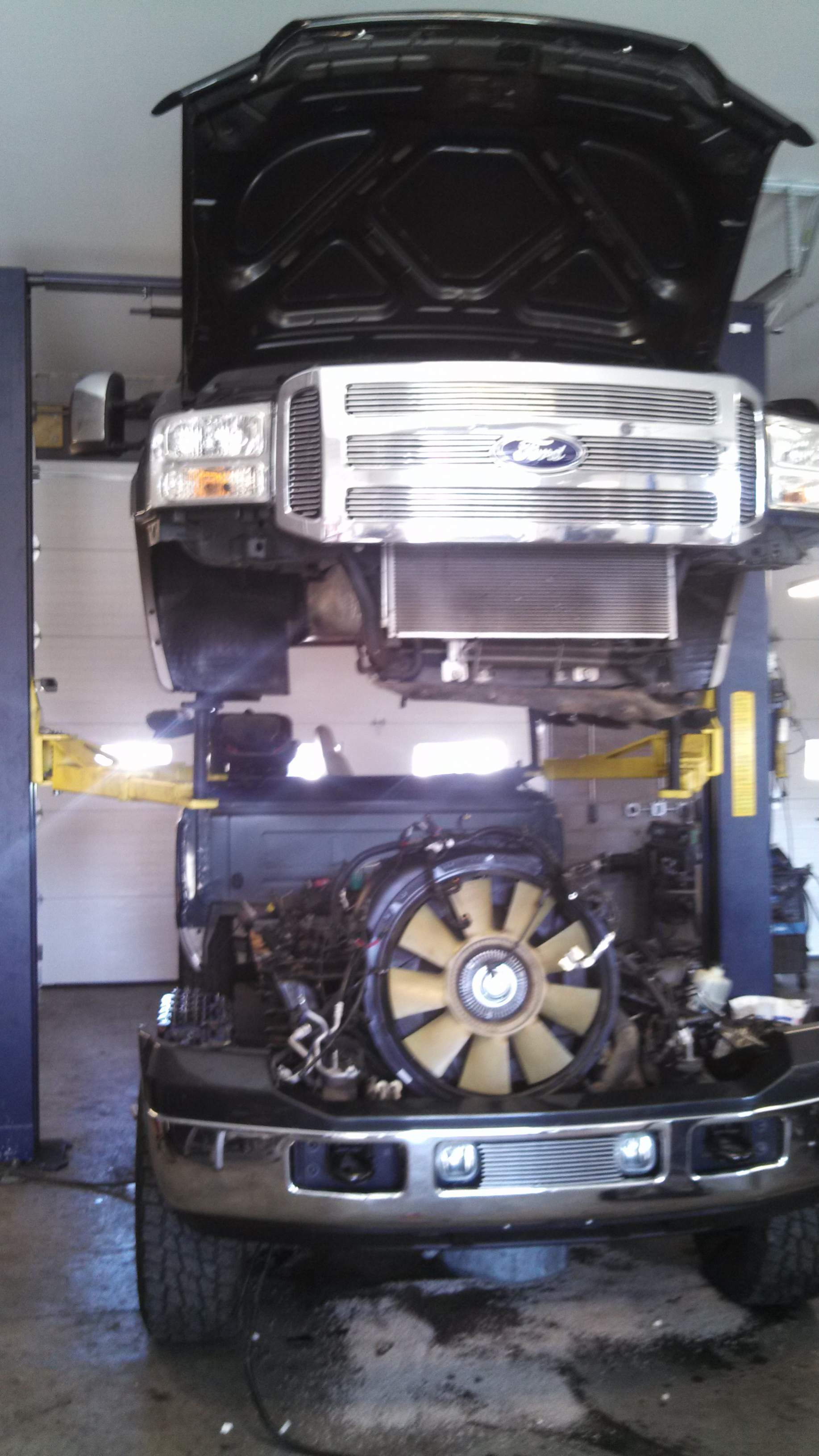

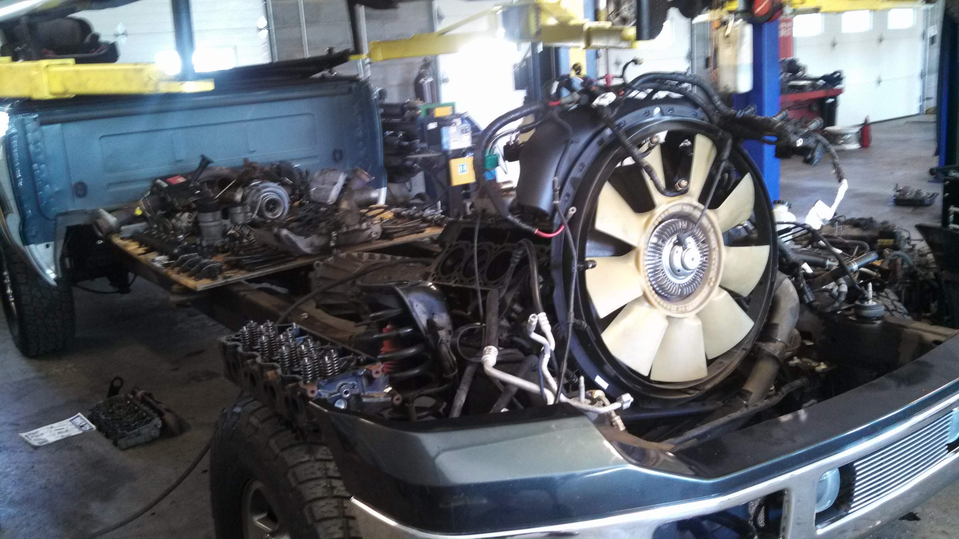

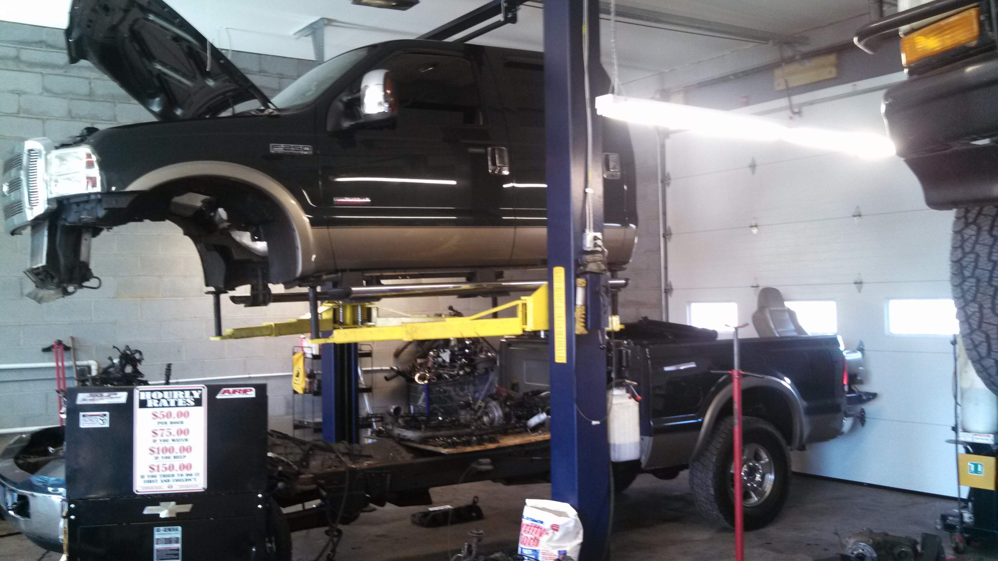

You can install custom tunes to add power and adjust shift points on the SCT programmers(most popular). Cory at TruDynoSports put a tune on my 6.0 when I had it. I had head studs on the truck, but no gauges and the tune was supposedly safe for towing up to 10,000 pounds. I can't tell you how many mpgs were gained(didn't keep the truck long enough), but it did wake it up.
The most popular custom tune writers are Gearhead Performance in TX and Innovative Diesel in MD.
Here are some pics of the truck during the head stud process.
Travis
