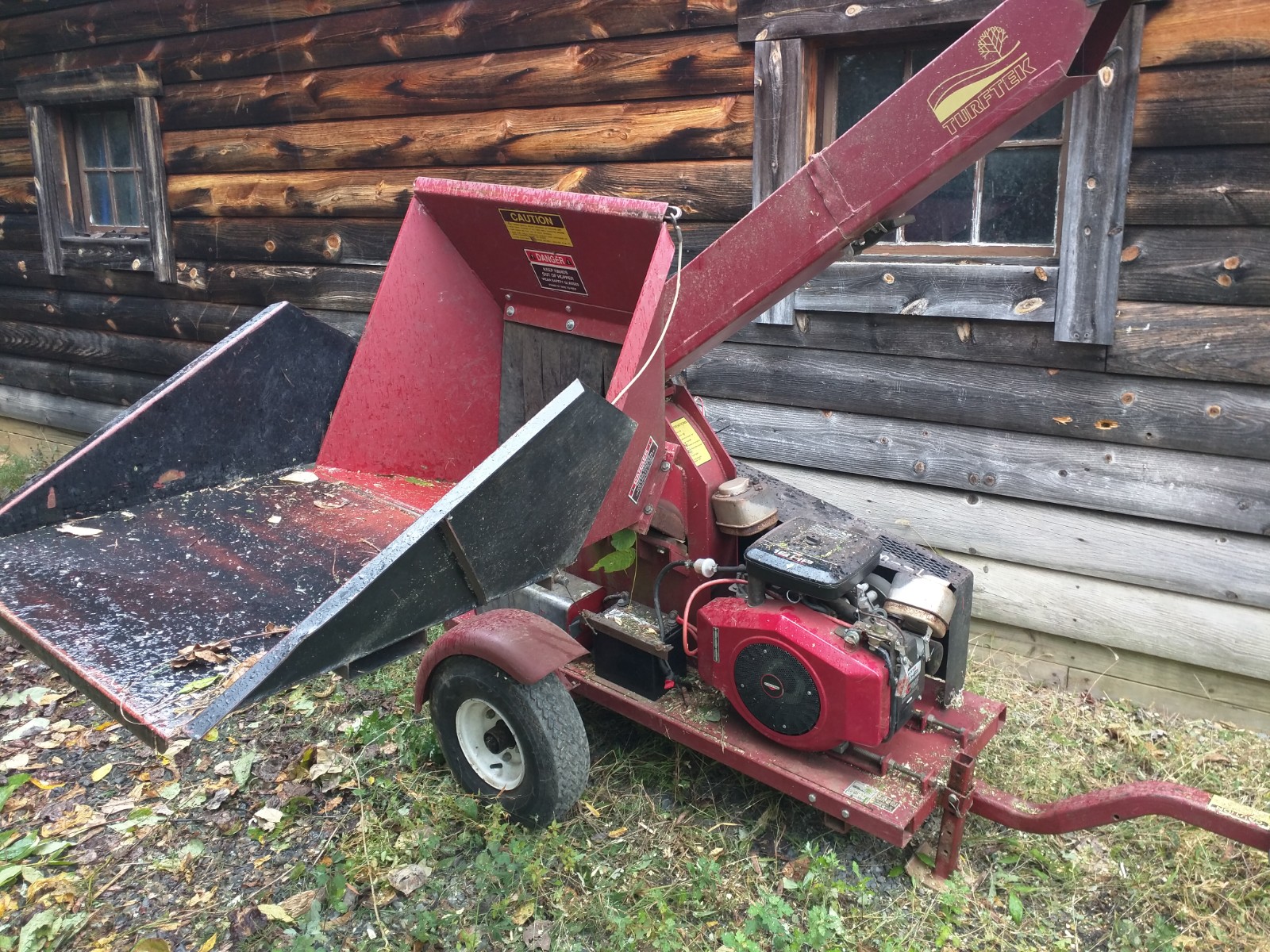

I refurbished this chipper recently. The bolts holding the blades needed replaced as I had to drill them out. The blades were easy to sharpen on a 6" wide belt sander. I did have to remove one blade shim to get my distance to the bed correct.
