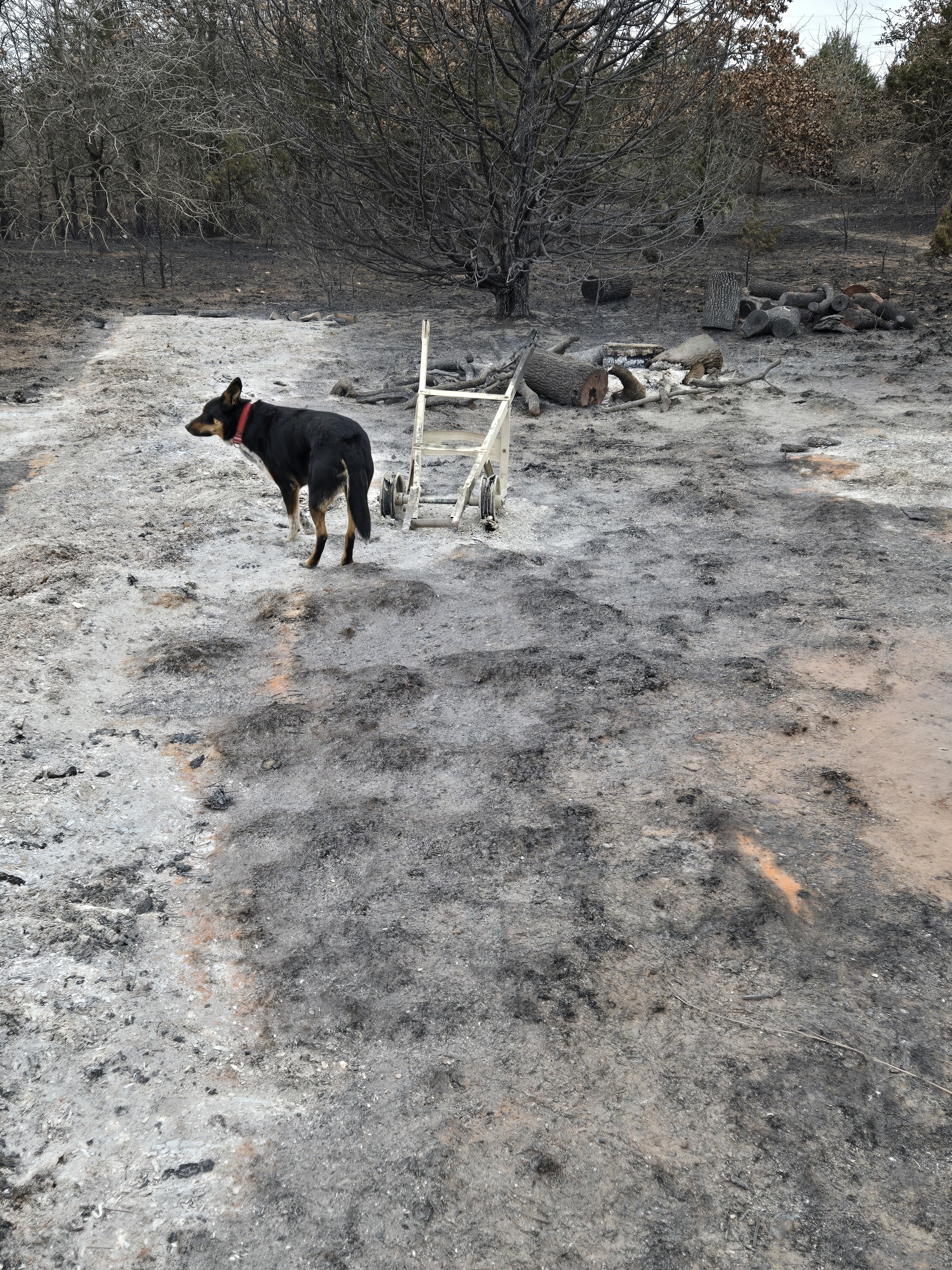

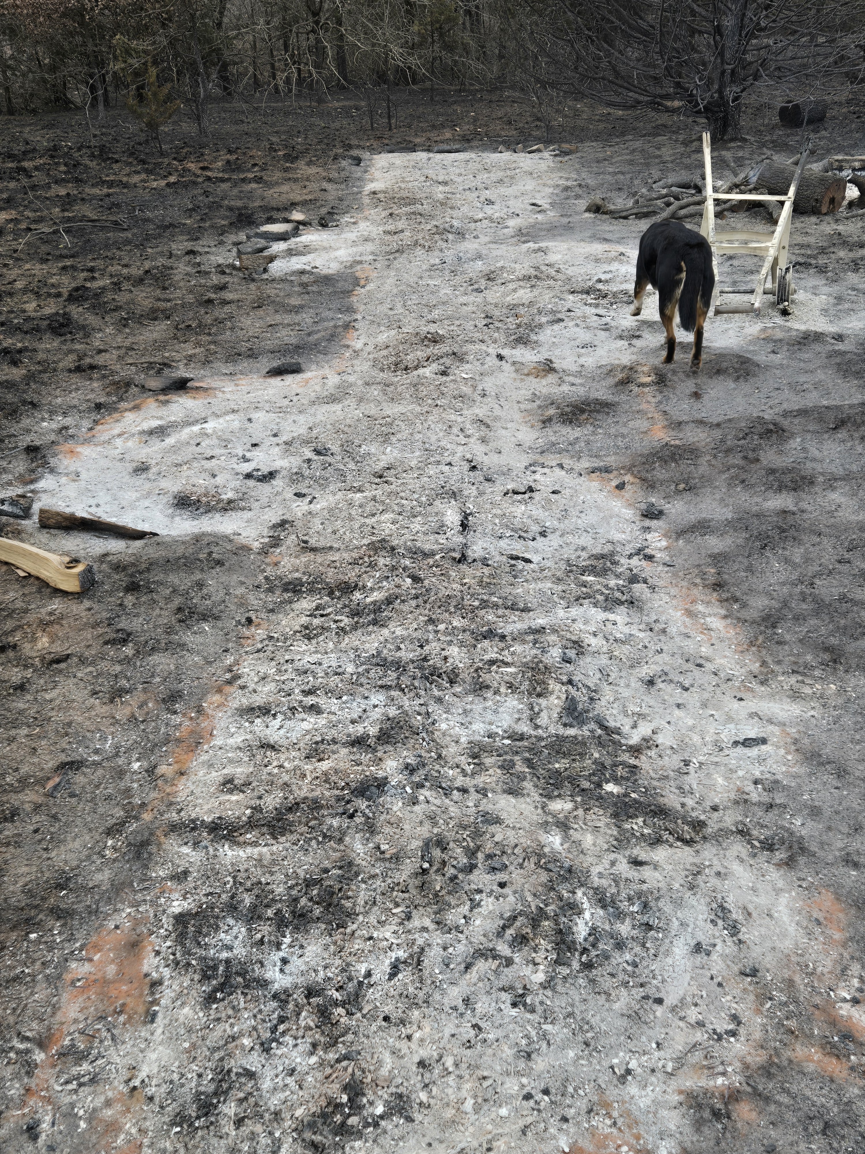

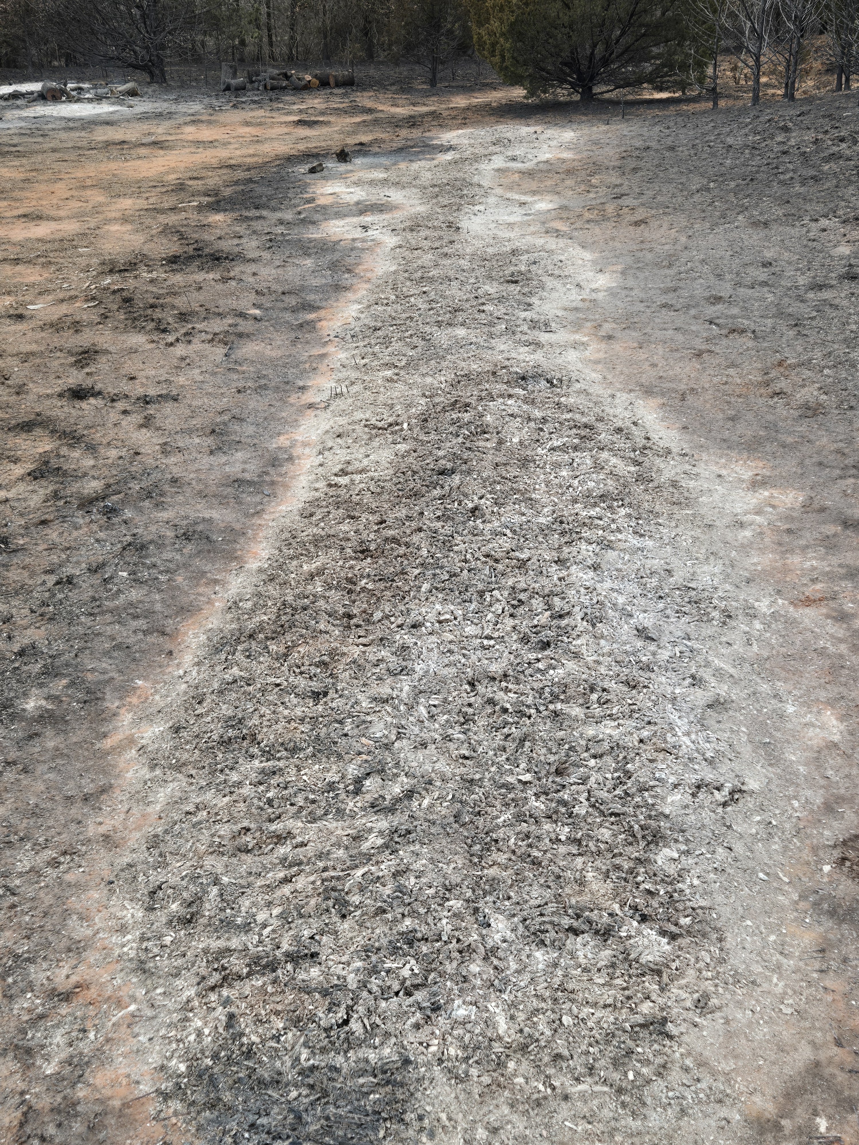

Speaking of big pile, little ash, I lost 20 plus rics of wood last week due to wildfires. The ash is what's left of white oak firewood
