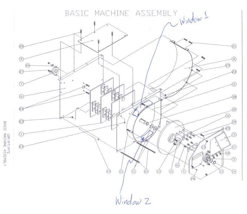

The chipper on my MacKissic wouldn't do about 2" locust branches this morning. Thought it was getting dull from doing so many persimmon and other big branches. So, I did the little stuff and took it up to remove the chipper blade.
The blade is non-reversable, unlike the one on my Troy Bilt Tomahawk, and is held in place via 3@3/16" allen screws. Instructions were to heat them to break the Loctite bond and then loosen. No instructions as to how long to heat, etc. They're not through-bolted like on the Troy Bilt. Have removed them many times on it, most times moving the nut to loosen them.
Well, two came out, but one smeared inside. Have sent a note to the dealer as to what to do.
Who of you have done this on your chippers? How big a job is it and what kind of chipper do you have?
Would also like to hear about those who have turned their hammers (those on the MacKissic seem to be like those on the Troy Bilt: can be turned 3 times before replacing, after all 4 corners get rounded) or replaced them. How big a job was this? The MacKissic (I thought) had the hammer rods secured by cotter pins. Not sure what they are. They're called "grooved pins". There's a hole for the rods to go through the housing on the PTO side. However, there's no hole to drive them from on the other side. The ones on the Troy Bilt have to be driven out, because the spacers get bent a little and bind them up.

Thanks for the response. Mine's the TPH-122. Can't see where there's a hole on the back side (opposite the PTO side) to drive the rods out that hold the hammers. The flywheel that carries the chipper blade covers all that side. Found the hole on the PTO side.
Those pins holding the rods in initially appeared to be cotter pins when I first looked at them. They don't appear to be roll pins, as these were what the Troy Bilt Tomahawk uses. They're pins that make a "T" on the back side, away from the PTO. The owner's manual doesn't tell how to remove them.
I heated the middle allen screw until the goo around it was glowing red for a while. It wouldn't budge and stripped out inside. The outer 2 came out fine, without any further heating. Never used Loctite on the Tomahawk ever. Never have had any come loose in 11 years of my using it.

Removed the screen this morning. Yes, they are roll pins. The ones on the Troy Bilt fit flush with the spacers and were through one of the spacers. Looks as though one finds the non-slit ends and hammer those out. Another way might be to collapse the slit with some vice grips. This is how I used to put them in on the Troy Bilt. Collapse, and they almost slip in by hand. Had to drive them out with a punch of just the right size.
Hey, another problem I have is I dropped one of the screws into the housing around the flywheel. Either need a very strong magnet to move it up or drill about a 1/2" hole down there to drop it through. They really ought to have a drain hole for that housing anyway.

</font><font color="blue" class="small">( .Hey, another problem I have is I dropped one of the screws into the housing around the flywheel. Either need a very strong magnet to move it up or drill about a 1/2" hole down there to drop it through. They really ought to have a drain hole for that housing anyway. )</font>
They do. Look at the bottom center of the housing for the flywheel (below the shute). I lost a roll pin and looked everywhere until I realized that when it popped out, it fell through the back side of the flywheel and into the flywheel housing. I used a wood sliver to drag it back out through the little hole in the bottom.
However, the hole is not big enough to extract one of the blade bolts through. I think they want to be careful about making finger sized holes in the housing for the chipper blade flywheel.

Good news. Here's my note to the JD dealer who sold me the Mac. Wonder if anyone has an e-mail or web site for the Mac folks to send my idea to. Thanks again, Cliff, for the rotation idea. I'll look for that hole you mentioned to see if it's big enough for the allen screw to go through.
Here's the note:
I got the 3rd allen screw out by rotating the whole chipper blade a few times.
Attached is the parts drawing that shows a couple of new windows that ought to be put on the TPH-122. These are at the top and bottom of the housing around the flywheel to which the chipper blade is bolted.
These windows' purposes would be:
Window 1: To access new backer/locker nuts on longer allen screws. This way, the screws don't have to be very tight. The backer nuts would lock them in place. One would simply place a box wrench (to avoid dropping the nuts when they're loose and off) and loosen the nut. Then use something like an L-shaped allen wrench to unscrew the allen screws. This is all I ever used in 11 years of doing the blade on the Troy Bilt Tomahawk. No Loctite, heating, etc. is needed to be done. (The flywheel might have to be slightly redesigned to accommodate access to the backer nuts. Don't know. Can't tell that much about it from the little access window now provided.)
Window 2: To allow retrieval of any dropped nuts, screws or blade.
These mods would make removal of the chipper blade a whole lot easier and far more predictable than use of stuff like Loctite.
By the way, I think that I've figured out the "grooved pins" on the ends of the rods holding the hammers and spacers. They are roll pins with grooving only on one end. It appears that you drive them out by finding the non-grooved end and drive from there. Installation is probably to insert the non-grooved end and to drive it in, perhaps with the grooves held together by vice grips. I'd think they ought to provide this information in the owner's manual. Sending one out to the shop every 10 hours to do the chipper blade and maybe every 100 hours to do the hammers isn't something an owner would normally like to do.
I really don't like using Loctite on the threads of the allen screws. Think I'll put some anti-sieze on the threads and Loctite on the back side of the allen screw head. Wouldn't need all this with backer nuts.

I did some research on anti-seize and loctite stuff. The outfit where I bought the allen wrench for a socket wrench sold me some "paste". It's AL-CO Pipetite, an anti-seize compound.
MacKissic's current recommendation is Loctite 243, which is the blue version of medium strength. It supposedly does not require heat to remove even though the owner's manual says to use heat (but not how long, how much, etc.).
So, my plan is to use the AL-CO stuff on the threads and put a tiny bit of Loctite 243 on the back side of the allen screw head. It supposedly sets in 1-3 hours; whereas, the AL-CO says 12 hours. So, next day use.
First, I've got to rescue that dropped allen screw and then buy 3 new ones. Gotta see if I can grind the blade on the side of my grinder wheels. This is how I've done the Troy Bilt's all the time, but it is smaller and fits in that gap. If not, I'll take to a machine shop. Might have to have the machine shop dress up the 2 outer screw bevels on the blade, as I might have damaged them a bit with the forked tool (old tie rod remover) in rotating the blade with it. Ran the one screw into the threads to make sure I hadn't slipped and buggered them.
