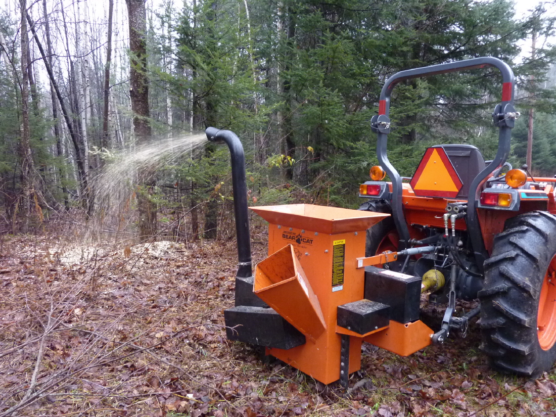

My experience is the same as Roy's. I bought my BearCat used about 6 years ago and have never had any trouble with it.
It's to bad that you are having so many problems - doesn't make sense to me.
   / Chipper Mods
#35
Maybe it's because it's color coordinated with your tractor.
You must have had to jump to get that pic with the chips still flying.
