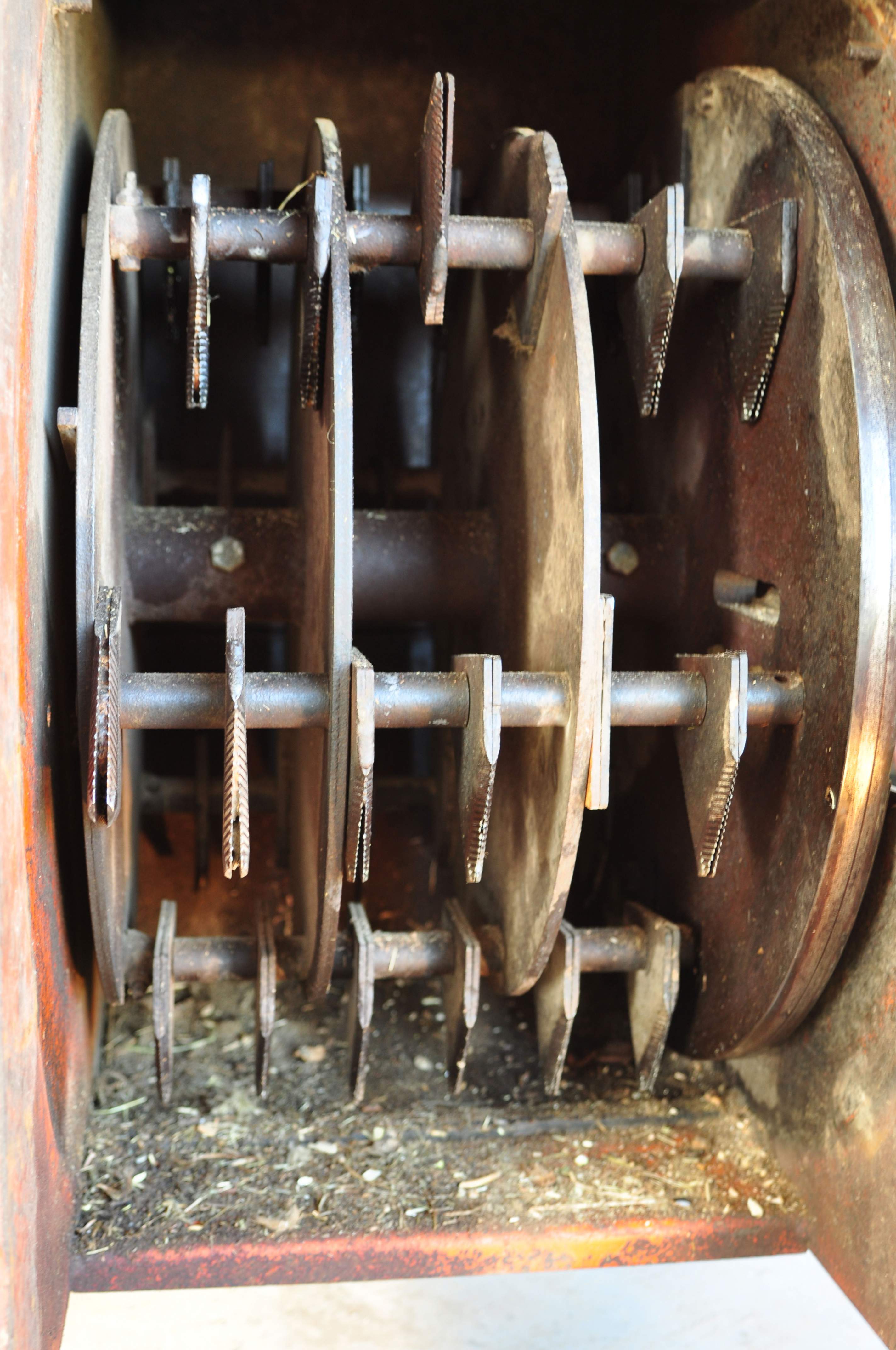

Hey guys, I've got another question about the bearcat. I've done a lot with it already and love it. I really need to do a little work on the shredder though. The previous owner must have had it in a place where it got wet occasionally, because there is a fair amount of rust in the shredder parts. Quite a few of the knives are stuck and wont spin freely like they are supposed to. I thought running some branches through it would knock them loose, but no such luck. Actually what looks like happened is some of the double knives have spread and gotten stuff jammed in between them - thus spreading them and seizing them.
I'm trying to take it apart so I can clean them all and loosen/lube everything. Problem is, I can't get the rods that the knives are on to come out. I took keeper bolt out and have tried knocking the rod out with a punch, but it's not moving. Have any of you taken yours apart? I'd like to take the least destructive path, but I guess worst case scenario I'll have to torch them out and buy new ones. Any help welcome!

Not sure what you are referring to. Is it the short 3" (or so) six knives that are on each shaft that will not turn? It would seem that a soaking of penetrating oil and a hammer would break them free.
If the knives are jammed somehow they will not let that rod come out. Maybe a photo to compare to the one posted below would lend some light on the subject. Others may be able to give a hint.
BTW, try to keep rain from going down the chute to avoid rusting problems. A tarp works just fine.

Yes, it is those knives. They are a little different than yours - mine are more like sickle mower sections. I thought they would break loose with a hammer and penetrating oil, but it's not that they are stuck, they are just really tight. I can move them with a hammer, but they need to be loose. I think the knives being jammed is what is keeping the rod from moving. Hmm...I may try a little heat, but just don't want to damage anything. Any thoughts?
Yes, I keep it in the shop out of the rain, but evidently the previous owner wasn't as careful.

Oops, I forgot - here is a picture of it.
